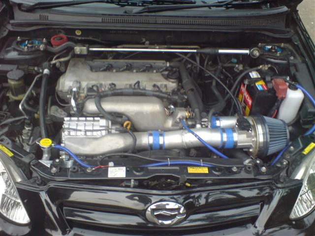

For the greddy celica kit going onto the sportivo
1. Fiddling the fan shroud and radiator?? / Do I need to go custom?
2. Relocating the radiator fluid reservoir??
3. New Battery (maybe relocate)?? / Factory battery needs to be replaced anyway
4. Brake upgrade to pass engineering?? / ae101/GT4 levin calipers, braided brake lines, brake pads/disc/fluid??
5. Suspension to pass engineering?? / running on stock does it need to be upgraded?
Would hope that maybe someone has done prior research to a similiar project and would like to hear there views.
If anyone brings up that SC Vs Turbo debate, you'l'l hear from me no doubt mad.gif
Seeing that the greddy kit will prolly only 25-30kw boost in power, I figured that since its not as extreme as xoom's corolla I might be able to get away with a few things. Already have an aftermarket clutch we will see how it holds up.
My best bet is to call an engineer, I'll need to anyways. But just putting this up for the sake of discussion.

From the pic i can see that the battery has moved back 30cms or so.
Brake upgrade should always be on the list when gaining power! Possibly larger discs with the stock callipers, unless you have the $$ to go the whole set up.
Same applys to the suspension.
Oh i have a question.
Are the stock engine mounts strong enough? Because i know a charger causes more movement

What kit is that?? Looks very neat and tidy and how much will it costs to do if anyone knows??
Punk_200sx
Too bad you cant utilise the factory itake manifold, it would look much tougher.

I believe that is the blitz kit thats on the photo up top.
Blitz kit will set u back quite a pretty penny, IIRC its around about 7K landed in australia (prolly 10K fitted). It has much more potential then the greddy kit as it comes with an intercooler kit as well. Whereas the greddy is similiar to the TRD kit for the 1zzfe as it has no intercooling option., unless you go custom which is not worth it clearly.
