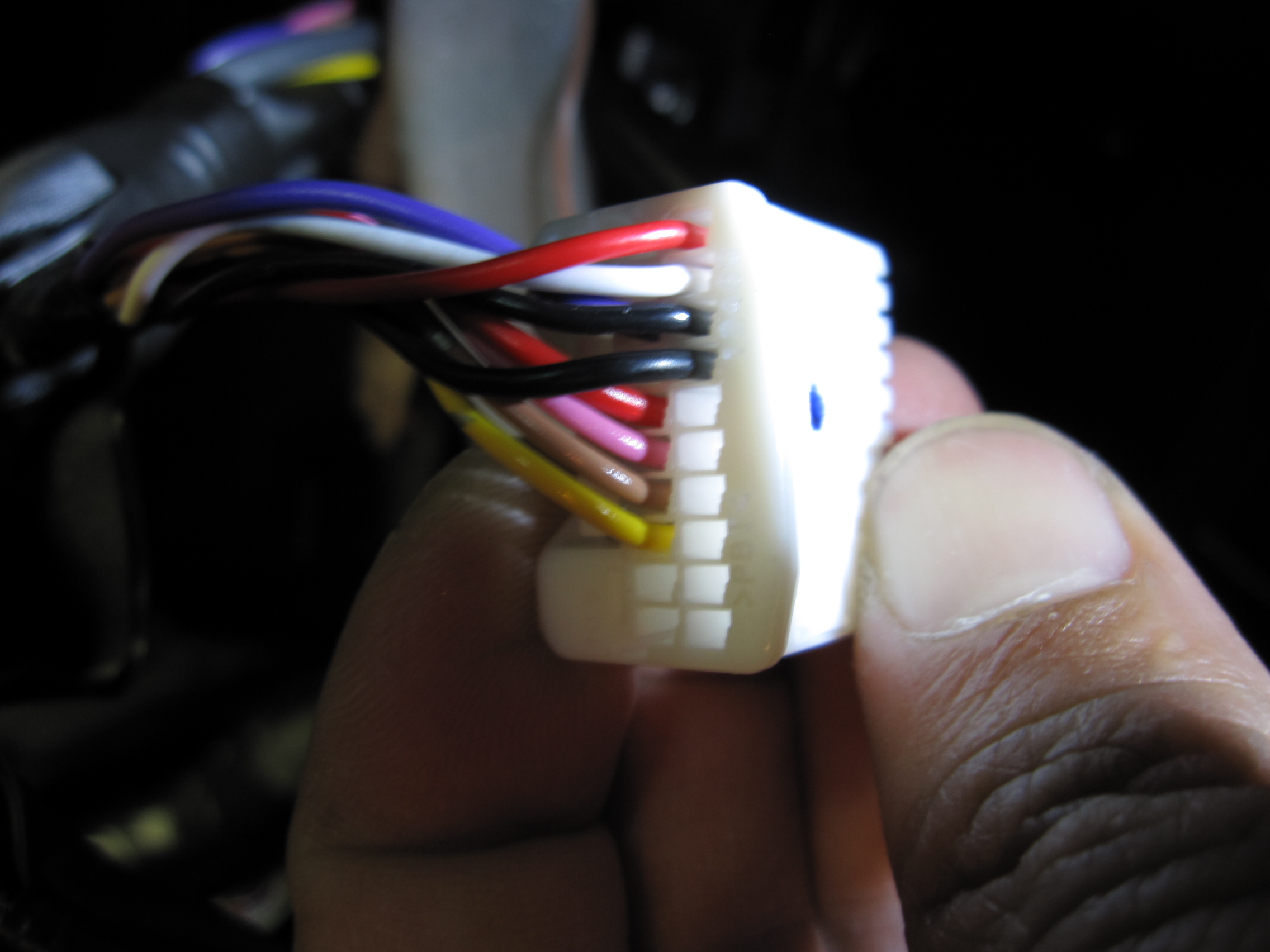

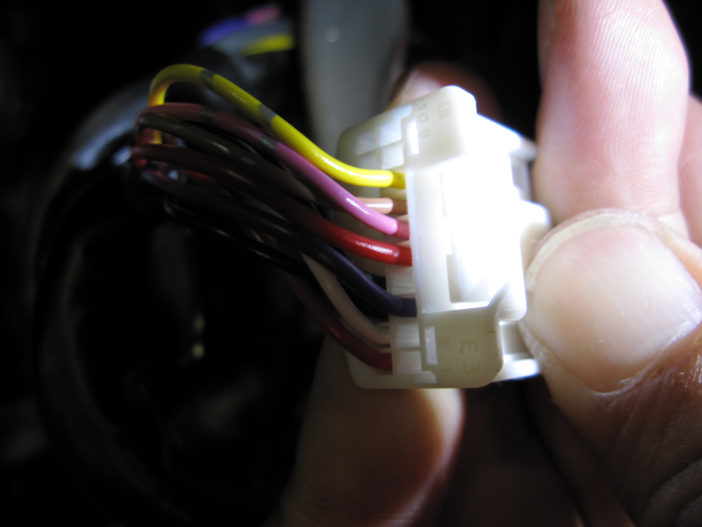

Just for you, I took my head unit out and took some measurements. When you look at the car side of the wiring harness you will see three connectors. The following is in reference to it when you are looking into the socket of the plug itself. Using the colours you can reference them. For the stereo, you will only need connectors 1 and 2. If you want to integrate the steering wheel buttons through the use of an external controller, then connector 3 has been included for reference. Only the wires present have been included:

Connector 3:
3 - Purple - Speed signal (used for ASL in stock unit)
6 - Pink - Steering control ground
7 - Orange - Steering control signal (for SEEK and VOL)
8 - Yellow - Steering control signal (for MODE)
