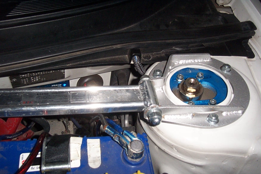

OK. I've been to garage today for fixing it up and made a change on it.
Unfortunately, the top mounts are not straight still.
It seems like it would be a bit hard to do the camber adjustment.
Still 20~30 degrees rotated from where it should be.
I am just wondering, are they all OK if I don't do the camber adjustment? coz I really have no plan to do it at all and just wanna make sure these are fine with that.
Here are BEFORE & AFTER PIC.
Before
After
Before
After
Does the car like to wonder itself as it hits bumps?
That top mount actually will give you caster and camber at the same time, but each degree of changes I think the car's toe changes too. I have seen this on my friend's Buddy Club coilover for his Evolution 7.
Position it like this from top view : / \ (your before set up)
As you slide the plate up for more negative camber, it will give you positive caster, but this I would think whack out too much toe out. The positive caster is a welcome addition though, but too much toe out will destroy your tyre in no time. So make sure you play around with this on the alignment shop. You can adjust the toe not from the top mount also, but I am not sure if there is too much changes made by the top mount causes the std alignment adjustment not being able to come back close to factory setting.
If you like to know what caster and toe is, whiteline page will give you excellent information and after you finish reading that you may want to do it.
On my celica, and most cars, the three mounting bolts of the plate is like this from top view:
Can you see how the two bolt are line up horizontally on the chassis, while if you look at your Aurion it's position angled? And look at the camber adjustment slider, on my Celica it parallel with the two bolt of the plate, while yours doesn't. So I think that's how the BC plate is meant to be for the Aurion/Camry chassis, unless of course they gave you the wrong part. But again, I have seen this on my friend's Evo 7.
Why don't you play around with the plate slider and see if it work?
Hey mate.
Thanks for your info.
The truth is top mounts on each coilovers are in wrong side in the pics.
I've contatced BC racing coilover on this issue and they advised and apolozied me that they have despatched a set with wrong side indicator stickers on front top mounts.
BC racing advised me to change the top mounts only (Left one to right) and it seems like the angle should be ok if I swap them around.
I am going to do the job by myself on this Sunday and I will try to take some pics and update.
BTW, The camber and toe angle are all original and not been changed at all.
The angle may look like camber and toe adjustments done but since I haven't changed those setup yet and they are still original.
I am pretty sure there shouldn't be any problems with tyres now because I already have wheel alignment done which I have to do it again after this sunday.:(
We'll see how the top mounts go after swapping.
Cheers.

Here are some pics during the job done.
Finally, the job is done.
I couldn't do this job without Gerald(Thanks alot!!) because he brought the stands for this job.
I bought my stands but they were too high to put under my car.
What we did is just simply swapped the top mounts and it wasn't hard at all. All I had to do is take the 2 nuts at the top of coilover to release the top mount.
There was a hard part during this job done which was releasing the big 2 pairs of bolt and nut at the bottom part of coilover.
Anyways, as the pics above, now everything is good.
I need an another wheel alignment coz driver side wheel is a bit twisted and my car is pulling left a bit becoz of this.:(
Cheers.
