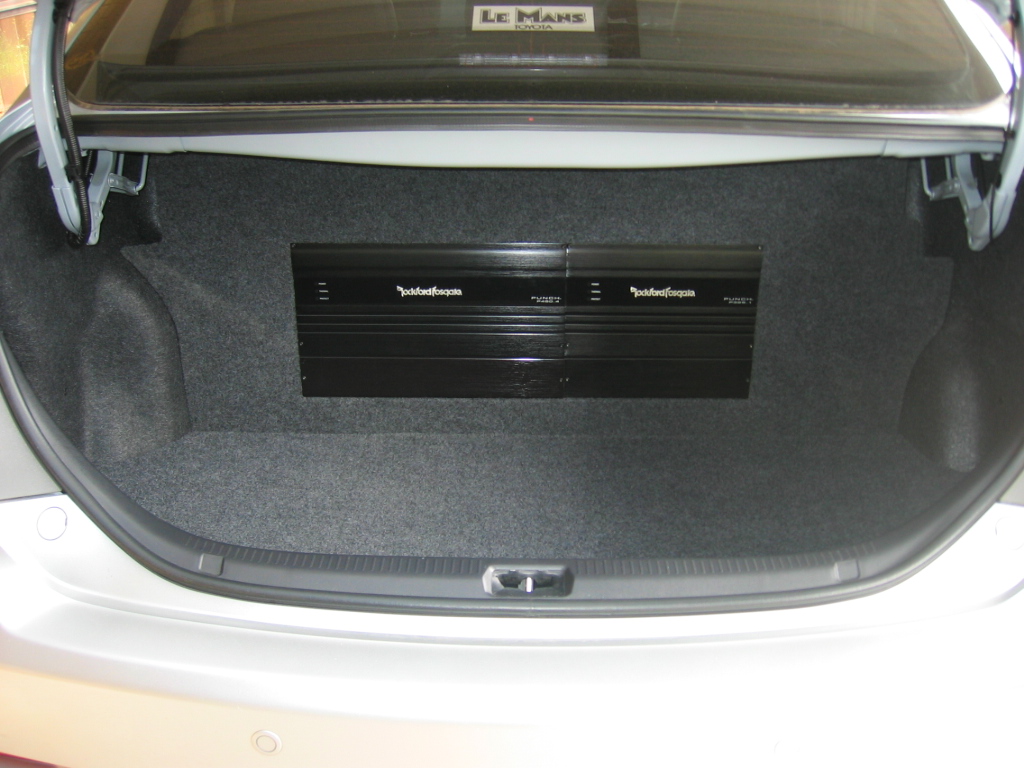

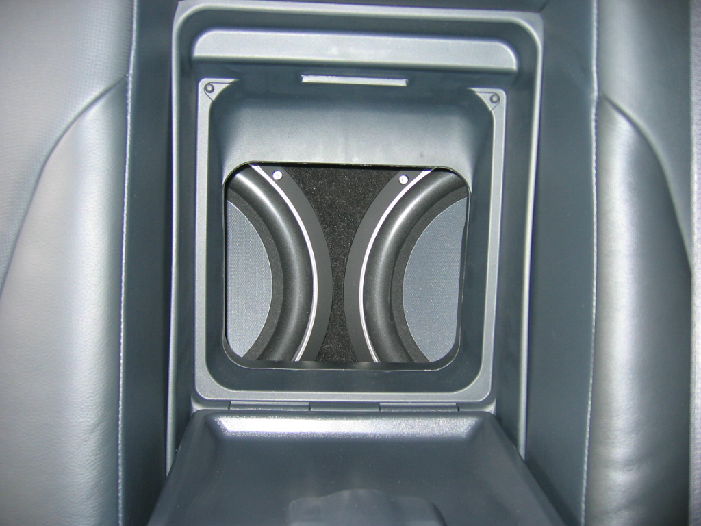

Talk to the guys at GL Pro Sound (www.glprosound.com.au) who did the stereo upgrade for my prodigy. Very impressed with the results and installation. Did not change the head unit as i wanted to keep the look "factory", but also ensure that I retain the steering wheel controls for the audio. All that was needed was the Rockford Fosate 3Sixty.1 unit to connect the head-unit wit the amps.
Upgraded the front and back speakers with MB Quart Premium splits and speakers. Added 2x 12inch Rockford Fosgate subs. You'll lose about 40% of boot space, but you still have more than enough for your daily use and the bass is huge! The subs and speakers are powered by two Rockford Fosgate amps.

thanks for the info share. great stuff. are you going to post any photos of the system??
  • 1 month later...
[quote name='Buri_ZR6' date='Oct 10 2007, 12:03 AM' post='197465'
Apologies for the late reply. Here are a couple of photos. Not much to show really as the I wanted to keep the look "factory". The only sign that the system has been upgraded is if you look at the boot.
