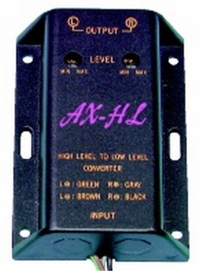

I picked up the converters from Jaycar, just your standard $15 ones. I was wondering if anyone recommends a particular one, a certain brand or one from a certain shop that'll do the trick...??
is this hi/low converter the rca adaptor?
what does it look like?
This is it...
As far as i know, its what i need, i mean its doing thee job, just causing static i feel...
