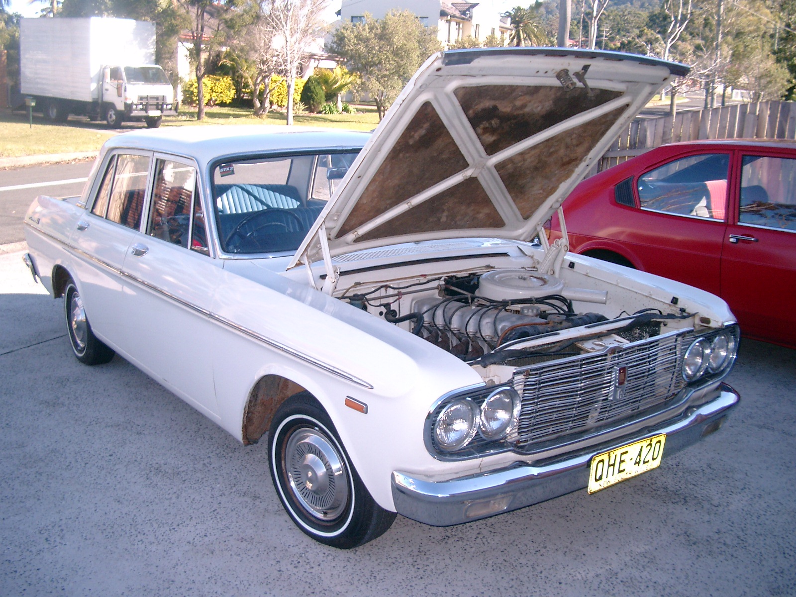

i have just purchased a 1967 toyota crown toyoglide with the 2m ohc 6 cylinder motor
it is an imaculate original white with blue interior one owner and has been unregistered since 1994
first job is to re-do the brakes and i am wondering whether to keep it original or upgrade to disck brakes and a duel circuit.
any advice on intechangeability with later model parts or opinions or spares is welcome
Edited by enri
Sweet Crown my friend. Would love to see some more pics of it too. From back and especially interior. It looks sensational though.
As for brakes, it really depends what you plan to do with the car. Given the condition of that car I am hoping she's just going to be a Saturday night and Sunday arvo cruiser in nice weather and displayed at some car shows. I expect that it will not be involved in any drags from the lights either, so in all honesty there ios no need to go through the hassle and expense of upgrading to discs. Just service your master cylinder and wheel cylinders, have a look at the shoes to make sure they are not worn, clean out the dust from inside the drums (don't get any grease or oil or indeed anything else on your pads or the inside of your hubs of course) and you should be stopping just fine. Also just check that your lines are all okay and not cracked or leaking.

Btw... what state are you in? Looks like an NSW plate in the background of photo?

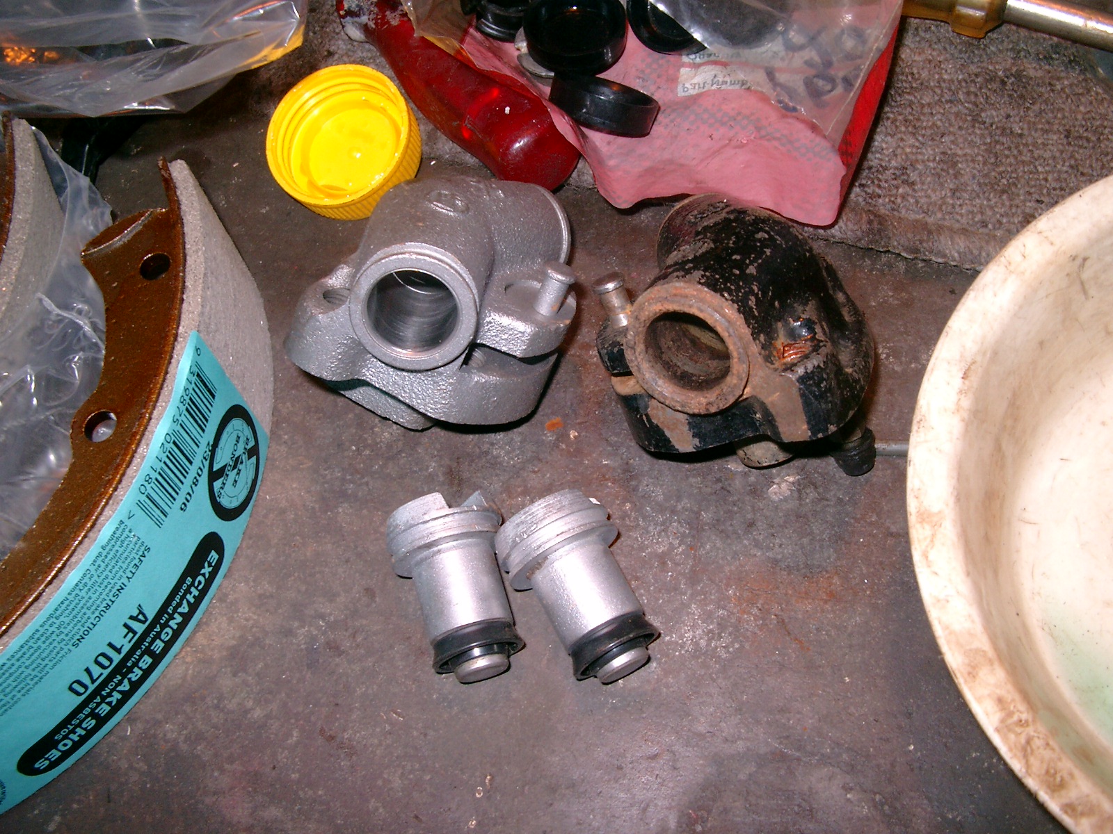

i pulled them apart this week and was impressed by the quality of the aluminiun cylinders at the front.
mabey just a duel circuit master cylinder for safety would be an appropriate modification

If your looking @ keeping it original, then just repair or rebuild the stock setup.

it turned out the brakes have aluminium cylinders so $4.00 for new rubbers fixed it!

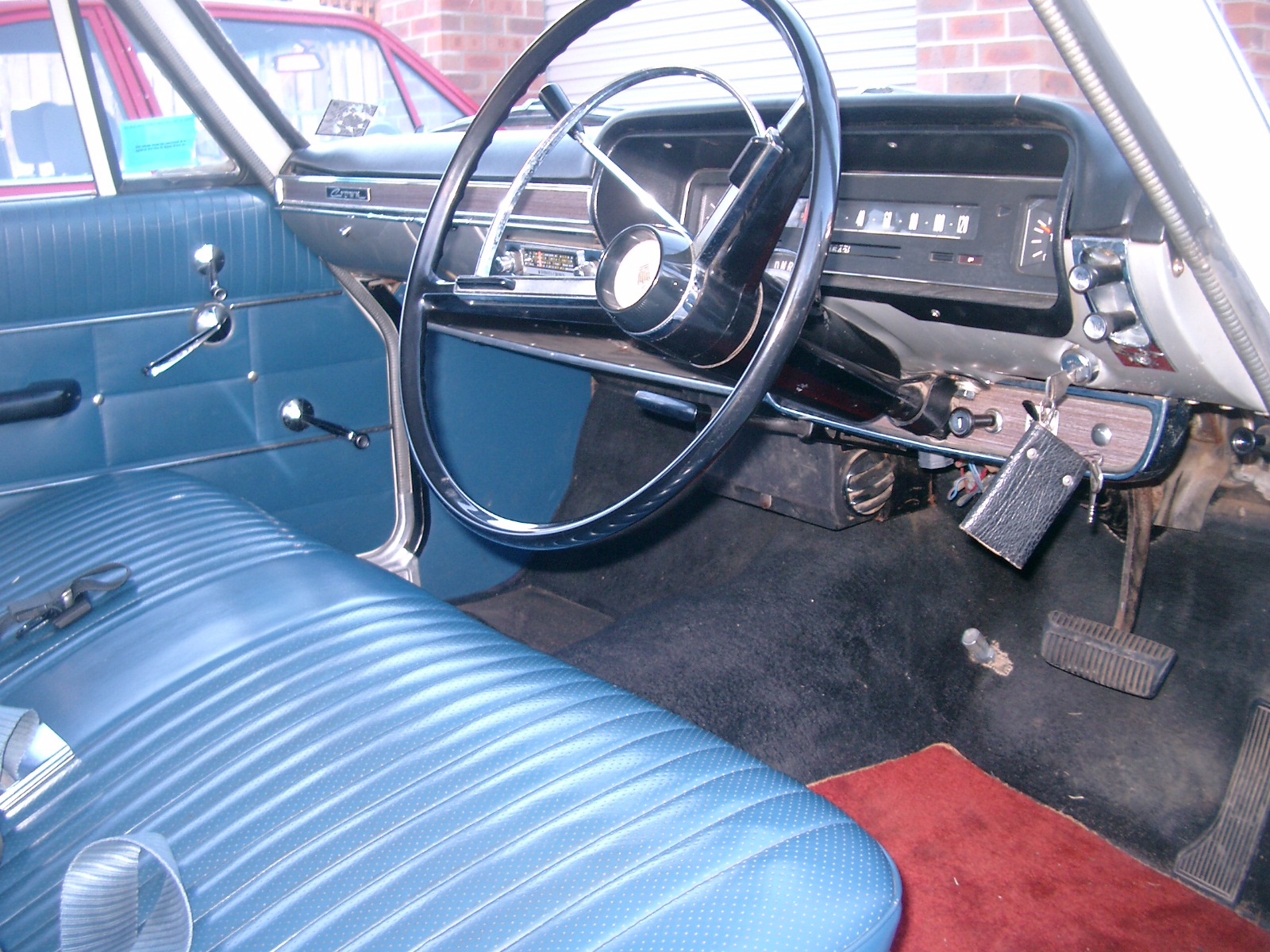

interior pic

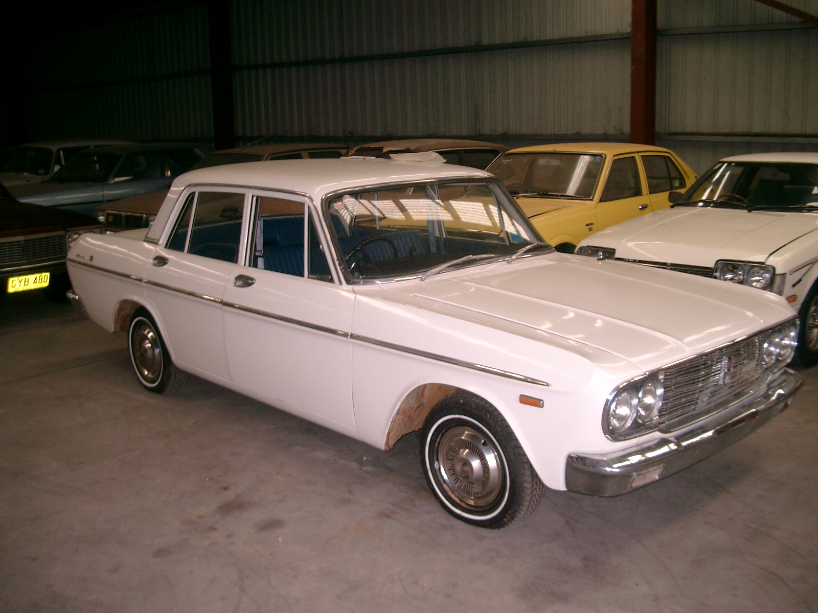

Just to drag up an old thread.
I now own this Crown. I purchased it a few months ago. It'd been through a couple of owners since this thread started.
When I got it it had some damage on the boot lid and rear quarter, the rear seat back was in need of repair and the engine was very smokey and it leaked like a sieve.
Recently I've had the engine rebuilt, had the seat trim replaced and the body damage fixed. I've had new carpet installed as well. Next step is the very tired rear springs and shocks need replacing.
It came with 18" mags on it which were dumped for the stock wheels again.
It's a great car to drive and is now my daily driver.
Here's a new photo of it and one with the mags on with my RS41 next to it.
Cheers, Greg.

On 14/09/2007 at 10:02 PM, enri said:
check out my new wheel cylinders complete with stainless steel sleeves
Hi Enri,  Do you remember where you got the wheel cylinders from? I'm also after a brake master cylinder and front/rear shoes for my '67 MS45 Crown.
