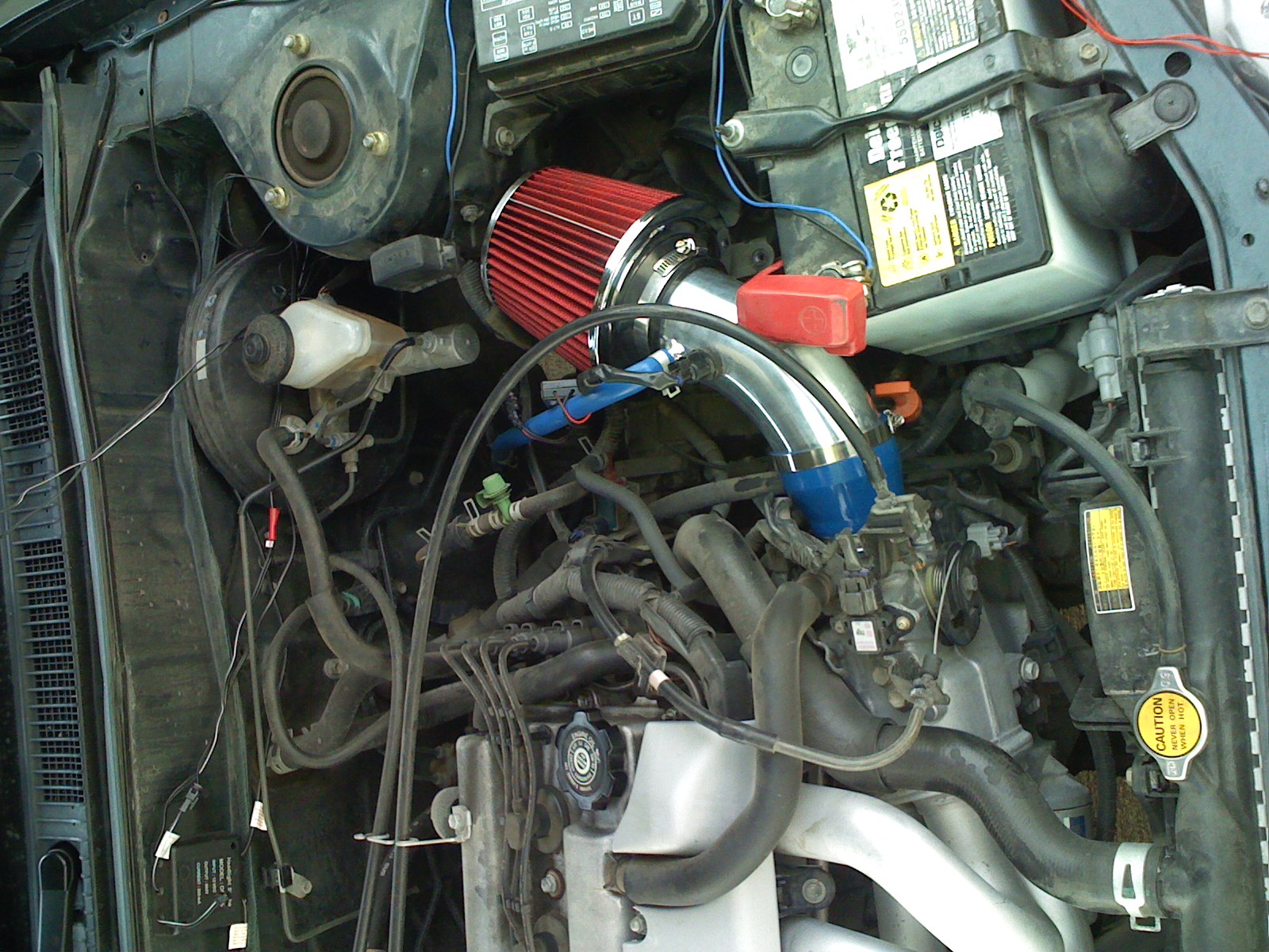

:help: :help: i have looked all over ebay and every were else and what other <$100 performance parts can i put on to make it get up and go i have put new muffler, air temp sensor bypass thing and short ram intake

i reckon you should get a heat shield for your pod, or build a box for it so it doesnt suck in the warm engine air
A few tanks of Vortex 98 or equivalent will clean out your fuel system and give you a cleaner, more efficient burn. Don't underestimate it.
Other than that I tend to agree with Jay, your SRI might only be sucking hot air from that position, try making a cold air feed with a piece of tube from Autobarn and team that with a heat shield. Even better, box the whole thing off and add a couple of cold air feeds.
well mainly my mom fliped out when i told here was goin to drop a new motor in it and new trani i mean it is front wheel and auto so i mean there aint rly the hard core part about racing but i just love goin fast and the adrenaline from it so yeah i think i will make the cold box this week some time but yeah i never rly thought about that thx every one but can some one start some suggestions on what i could do besides getting a whole new motor
