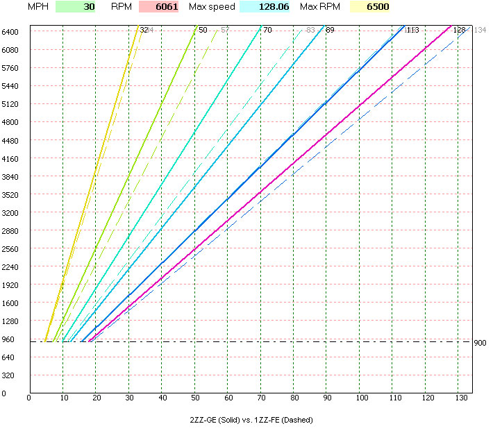

Just for clarification, i have plotted the gear ratios from the toyota brochures comparing a sportivo to a 1zz corolla MANUAL TRANSMISSION (i.e. C64 vs C52)
The graph only goes to 6500 RPM for the sake of the topic (i.e. in a 1zz) and units are in MPH.
If you want a longer 6th for cruise you are looking for a C60 (which has the same ratios as a C160)
I can plot up C60 vs C64 and C60 vs C52 if requested.
cheers.
