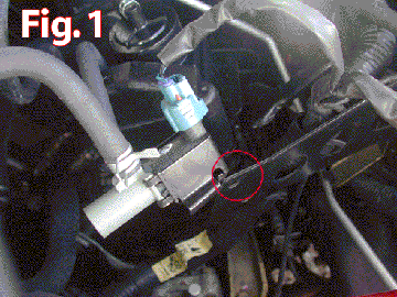

Fig. 1 - this bracket along with the other small piece that comes with it does not help. As you can see the VSV?? is just hanging.

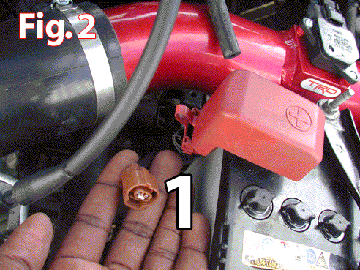

Fig. 2 - this sensor no longer has a place to go.

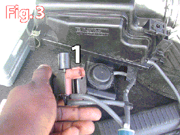

Fig. 3 - The sensor was plugged here, but now this device seems like it has no place on the new setup either. In this pic it is still attached to the old air box.

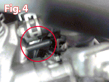

Fig. 4 - This isnt really a problem, I just want to know if I capped the right section.

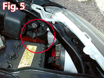

Fig. 5 - the bracket for here does'nt fit properly so we didnt use it.

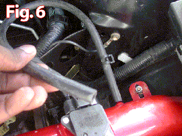

Fig. 6 - I have no idea where this other end should go. :blink:

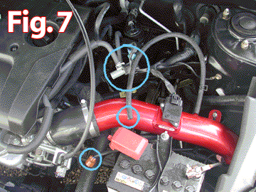

Fig. 7 - The sloppy end product. :(
There are two parts to this bracket not one. A longish arm and a peice that has a tappered edge.  If you only have 1 VSV based on our model you have to grind this bracket to fit the VSV on and cut the lower part of the bracket as you don't need this)
This Sensor wire is not used with the CAI. The kit should have come with a cap to go over it
As stated no longer used.
Tis in the right place
Cut the top off the bracket just above the hole repaint it black and it will fit. I advise that you do this other wise over a period of time you can damage the black hose
The only car that uses the little pipe out of the CAI is the US Matrix this should be capped with a Vacum hose stopper
