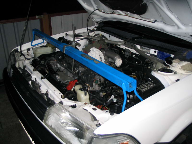

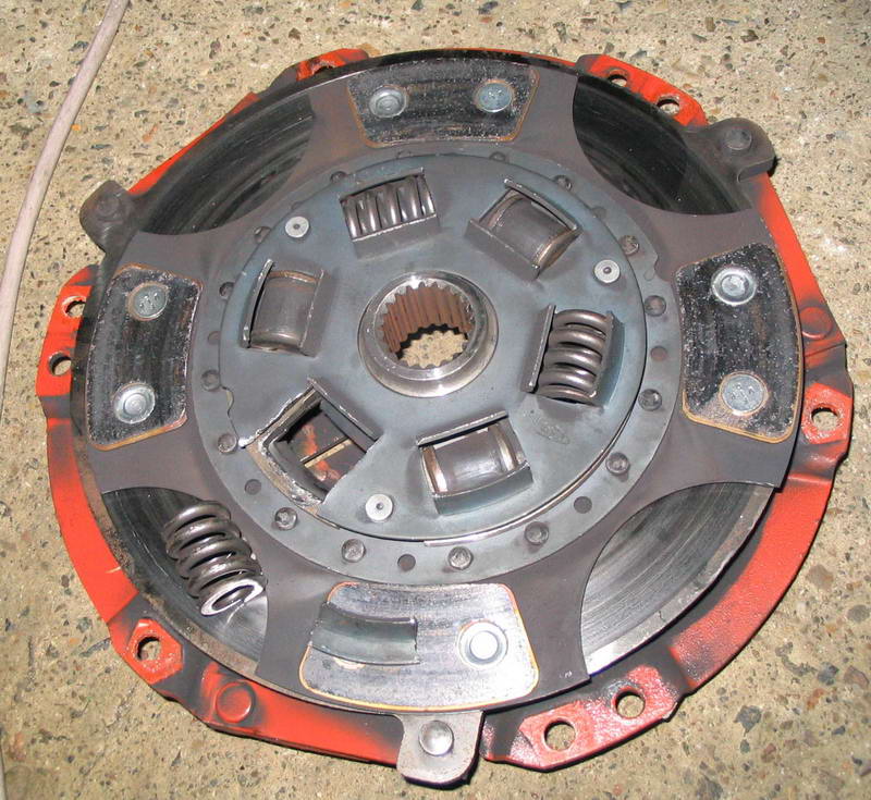

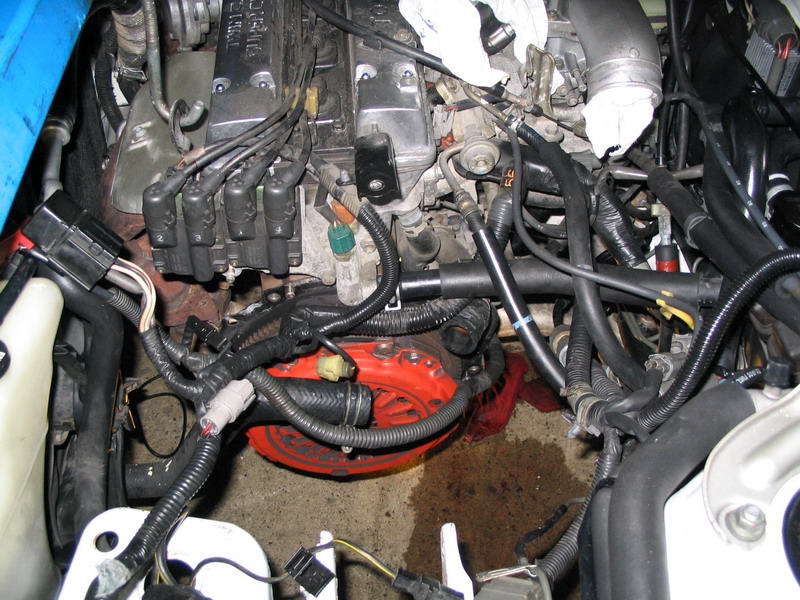

Getting toyota to officially admit there's a clutch problem would get the clutches swapped in your car's at no cost, but that's highly unlikely.
If toyota wont fix it, you can fix it yourself in a day with some basic hand tools and $200 ;)
A Daikin/PRB/etc clutch kit costs $200 for the pressure plate, clutch disc and throwout bearing (toyota price is $700), then most of a day for a DIY'er to remove the box and replace the clutch at home... I've gotta pull the LSD box off my GF's AE111 20V in the near future to lubricate the input shaft for the clutch, but I've been putting it off for about 3 months now as there's nothing I hate more than doing FWD box swaps at home.
At least the ZZE rolla's have heaps of space to get the boxes out, that would make life a lot easier in comparison to the AE chassis.
Here's a mate's 4agze sedan I helped remove the box from a week ago to fix a broken clutch, the spring broke out of the disc and jammed the pressure plate so the clutch could not be disengaged.... Stupid puck clutches, I'll never bother with one of those again.
