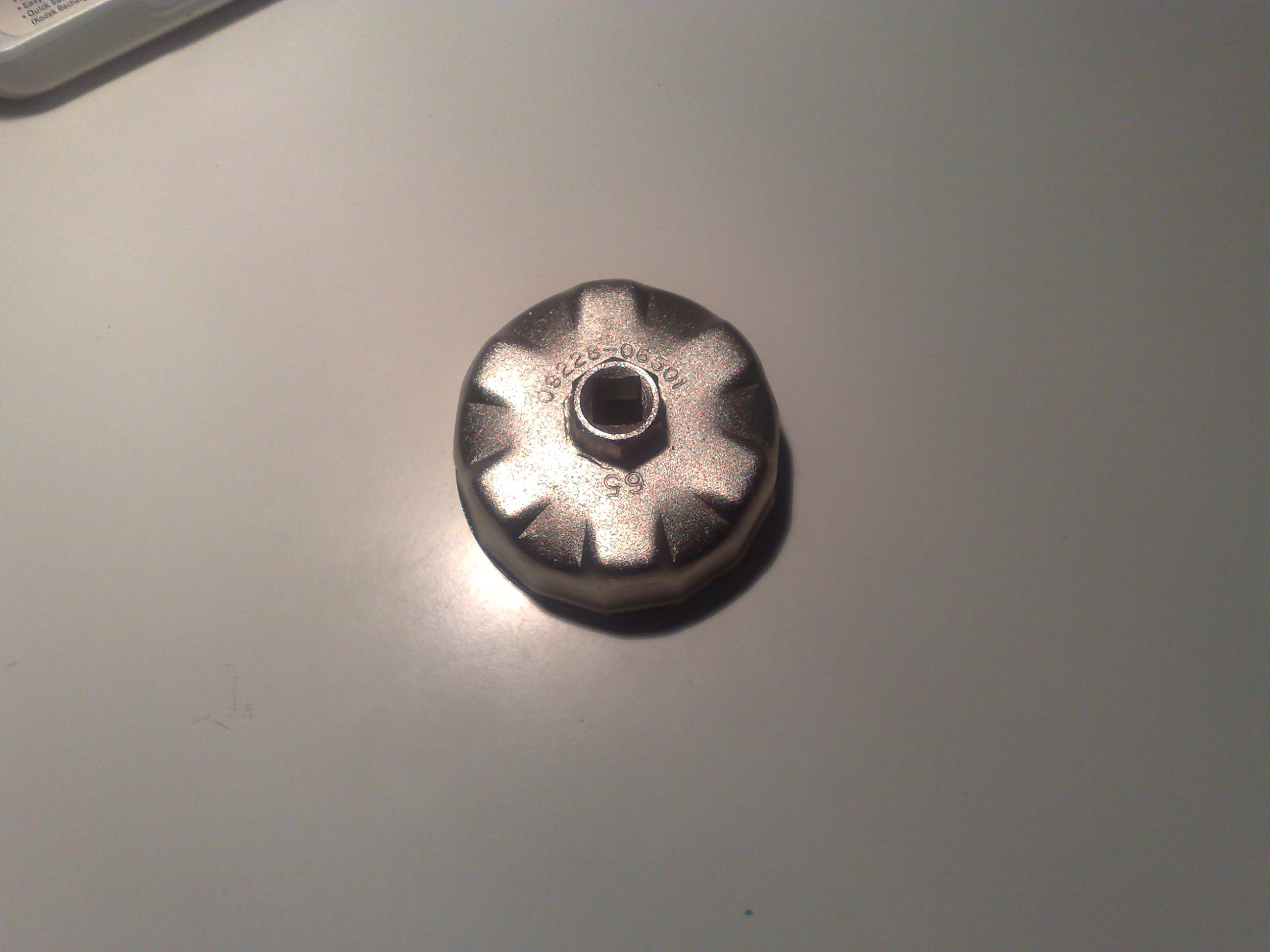

At the front driver side of engine, you will need a special tool to remove the oil filter,as the Aurion has a cartridge and not a oil filter like most cars.
The item is a tool with you attached to the bottom of the exterior of the filter body to gain access to the cartrdge which is housed inside.
Part number for this tool is: 09228-06501
You will need 6.10 litres oil if the oil filter cartridge replaced.

Avalon Oil Change (PDF)
I would advise ordering a '65mm/67mm cap style oil filter wrench' though because the Aurion uses a cartridge style oil filter.
You can remove the cap without the special tool, but I'm not going to advise how to do that here because it's just something you shouldn't really do. Plus I don't want to be held accountable if you break something.
A mob named 'T&E Tools' makes such oil filter wrenches. You can order them from most auto stores like Repco and the likes.

Mate if you dont want to purchase the filter housing removal tool all you do is have your drain pan under the filter location to catch the excess oil and grasp the filter housing and turn it anti-clockwise as it only threaded on, and unscrew it a couple of turns in which oil will start to dribble out,leave it for a few minutes until it stops and then very carefully keep the filter housing level while you fully unscrew it and lower it down and drain it in your oil tray, every thing else you need to know and do is in your new filter box including new O rings. Once you,ve done it you will wonder what all the fuss is about. By the way when you reinstall the filter housing with the new element in it,unlike a spin on filter you dont tighten it an extra 3/4 of a turn after it contacts the base,just nip it up.Once again the torque setting is on the box (instuctions ).Haggle with Toyota as the price can be as much as $10 different between dealers for the filter.By the way it holds 6.1 litres with filter change

Depending who last serviced your car, if you don't have the oil filter wrench, removing it can be difficult. Some people still use the rule of thumb of tightening it to a Hulk grip.
I don't actually have the cap-style oil filter wrench, but I still use a (unnamed tool) to remove mine due to how tight mechanics tend to do them up.
