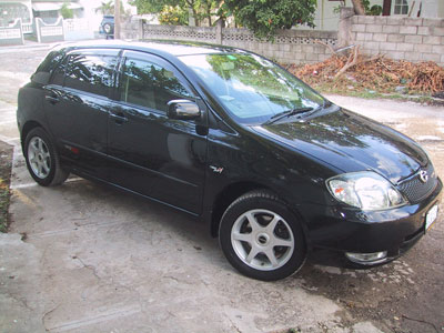

Actually my car came with 15" rims. To be precise 195/60/R15 here is a pic of my car.

If your roads are rough, I would reconsider and go for a set of 16" wheels, They'll still look quite good in 16x7, especially once you lower it, and like Shao said, a much broader selection of tyres will be available in that size.
