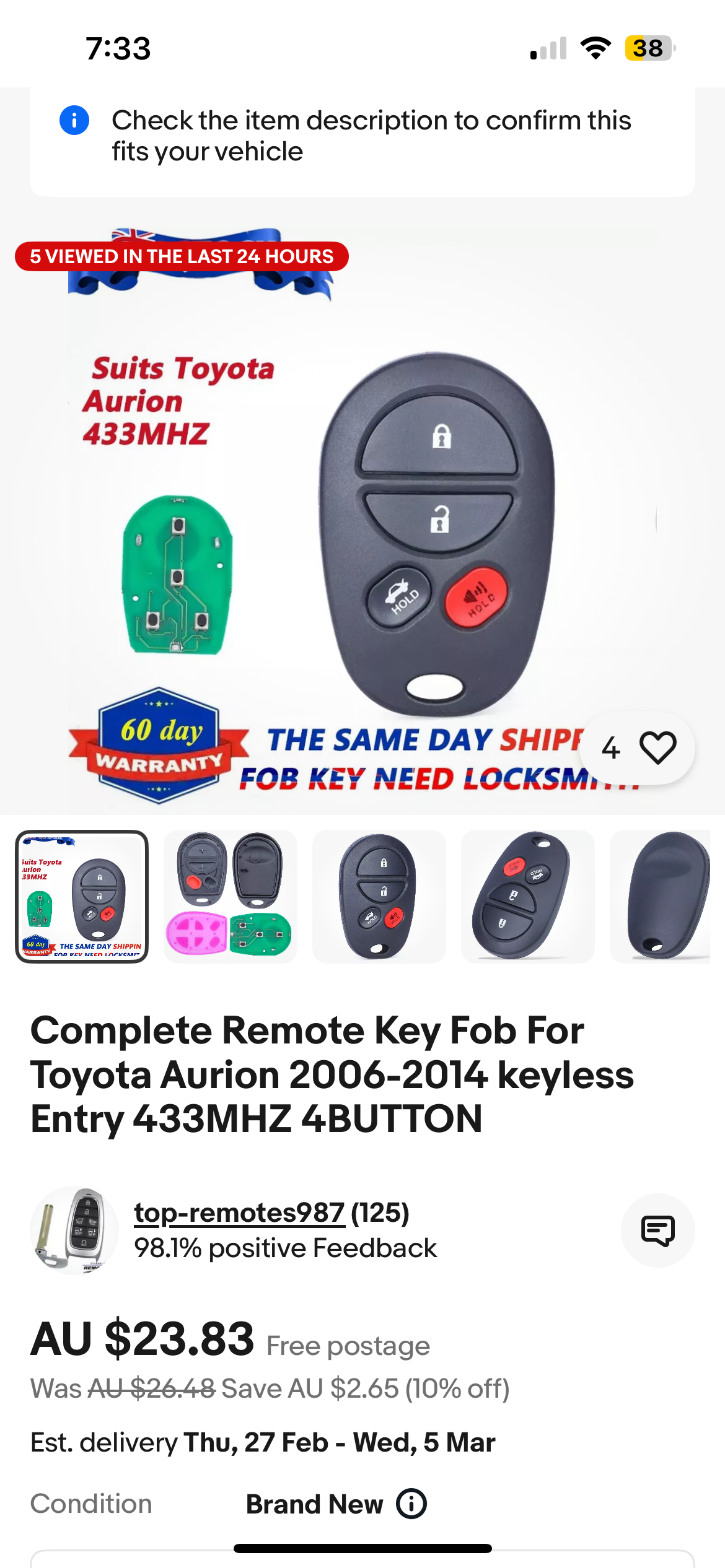

Not sure why my ebay remote didn’t work with the above instructions. tried atleast 10 times.
1. Does go into programming mode.
2. No response when pressing both lock and unlock button for 1.5 secs. followed by 2 secs lock button press.
my guess is either remote frequency is not compatible or may be some other issues.
Why I need this: dropped my original fob and ran over by car. ever since original fob wouldn’t works. also wont emit remote beam when buttons pressed.
