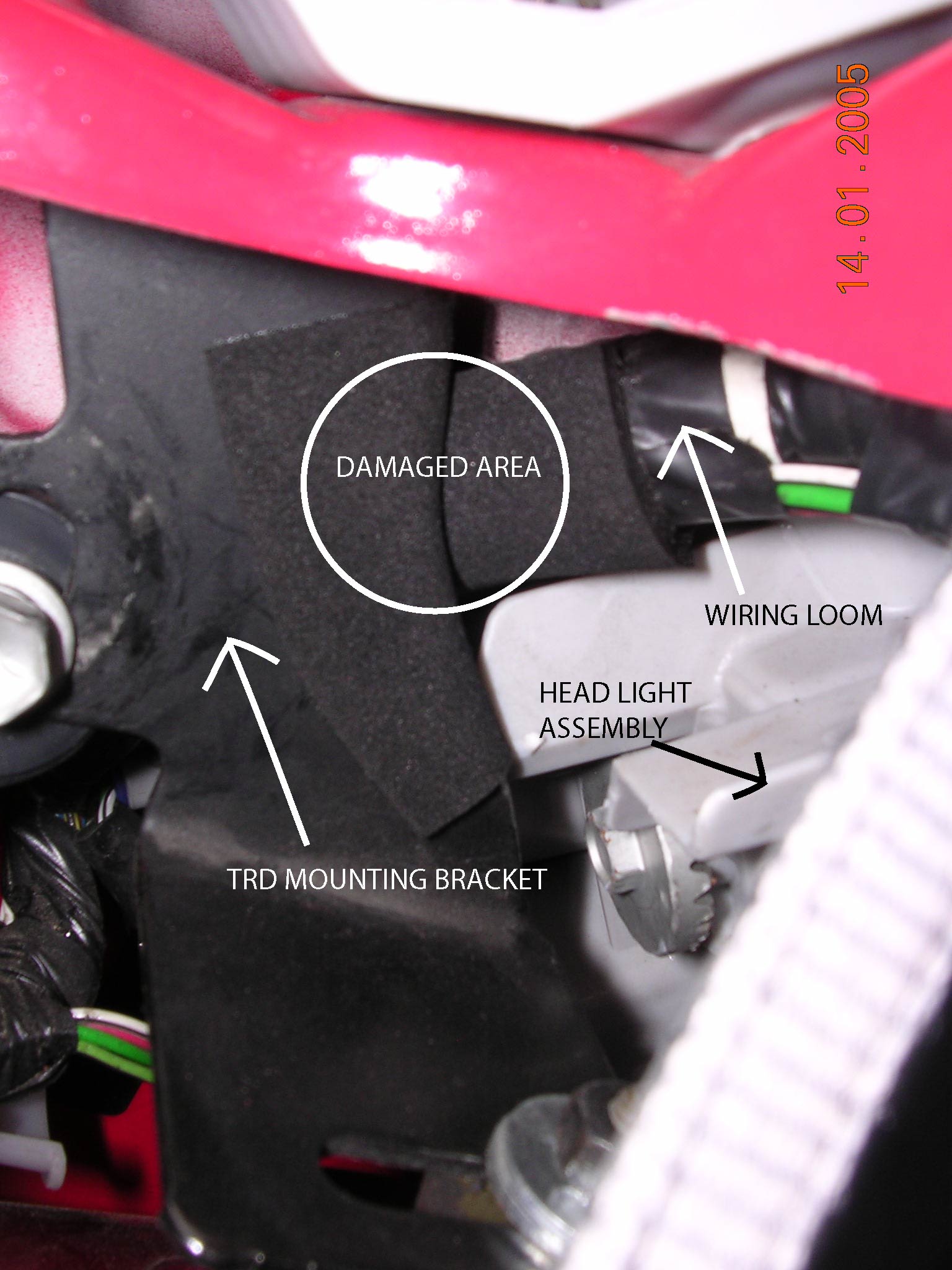

An update on the high beams the wouldnt turn off.
took it to MCT today, problem fixed and $250 lighter in the hip pocket :blink: .
It was caused by the TRD CAI rubbing on one of the wiring looms ( after some time of rubbing the insulator had had disappeared and exposed the wires) and shorted out some relay that controlled the high beam lights. so the wiring and relay had to be replaced in that particular section.
So a warning to all fellow sportivo owners out there with CAI's, check that your CAI installation is not causing friction on your wiring, very expensive lesson learnt.

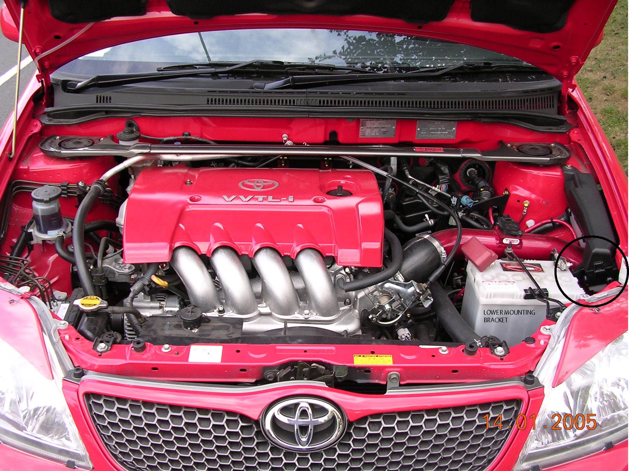

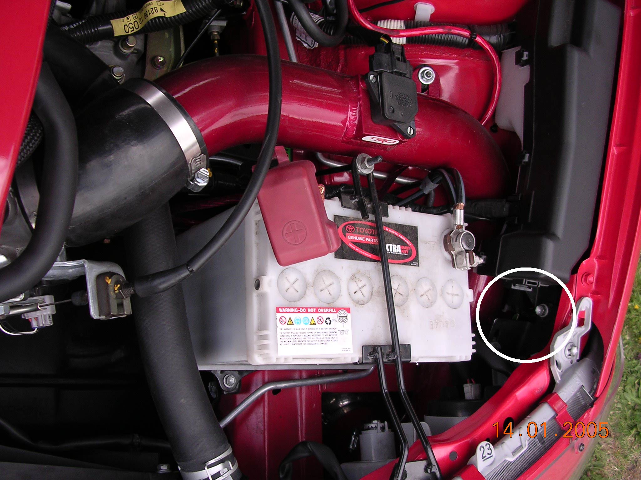

Hi arcxis,
can u post a pic n point out exactly where it was rubbing....that would be most useful.
cheers
Bill
I'm not exactley too sure where (the rubbing point) is as i picked up the car in a locked up state outside the dealer after work today so i couldn't speak directly with the service tech guy but will give him a buzz tomorrow to find out exactly where.
then i will post a pick for you guys and gals.
