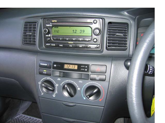

I have attached a photo of the audio system so you can see the exact model.
Let me know if u know how to change the time, thanks.

i had the same issue. I asked the toyota guys during my last service.
you hold down the AM button (make sure the stereo is off) and then press 1 to change the hour and 2 to change the minutes

This is for a few people out there that might not know. If you were wondering how to set he clock in your toyota echo with your standard toyota cd player. All you have to do is have the sterio turned of and its either the combination to hold seek up than 4 holding them at the same time or the other way around 4 than seek up. And to adjust the time press AM and 1 to adjust hour and AM and 2 to adjust minute. This include most toyota standard cd players.

Huh? You already have a clock in the climate control screen, the clock in the stereo defeats the purpose. The dealer should not have turned it on in the first place when they did the pre delivery. With the stereo turned off (but key on), hold down your seek/track up and press button "4", that'll turn the time off.
^right, but its the other way around. hold the "4" key then Seek/track up. :)
