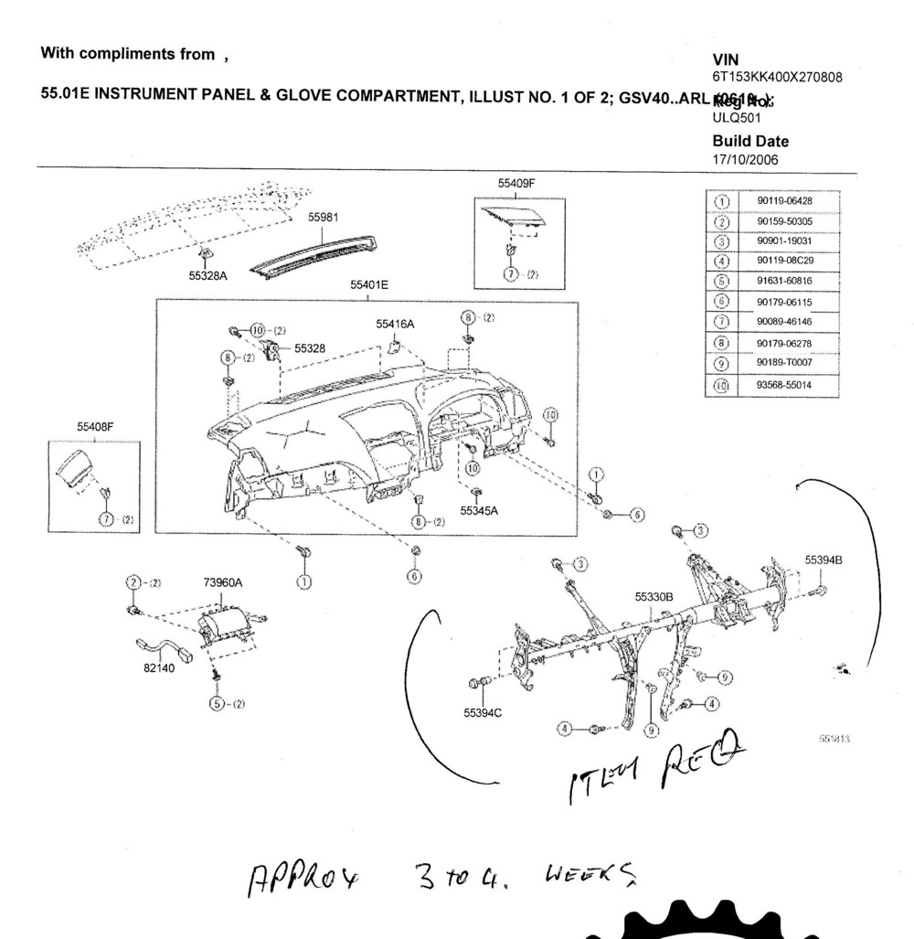

Had my dash fixed twice and then a new rattle started. They pulled it out for a third time and found the main metal beam that everything is bolted to has a sort of telescopic section. When the interior temperature rises through parking in the sun, the metal expands on the outer section of the telescopic beam then the inside piece rattles. They will pull out dash for the fourth time when the part comes in, probably two more weeks. It sounds like a bolt bobbying around in a plastic mug. 4 times dash out........Top that!
See attached picture of suspect part.

Well I'm very envious of all you guys that have had your dash rattle successfully fixed. happy for you but envious because mine still creaks and rattles even after a new dash was sent from Japan. It seems that this is a major problem with Camrys all over the World and I managed to get hold of a Toyota Tecnical Bulletin from the USA called NV008-07 which covers the fix. I'll give this to my Toyota Dealer to see if this is the fix that they carried out. If anyone wants a copy, just let me know........Cheers
.... I managed to get hold of a Toyota Tecnical Bulletin from the USA called NV008-07 which covers the fix. I'll give this to my Toyota Dealer to see if this is the fix that they carried out. If anyone wants a copy, just let me know........Cheers
Can you scan it and post to here?
