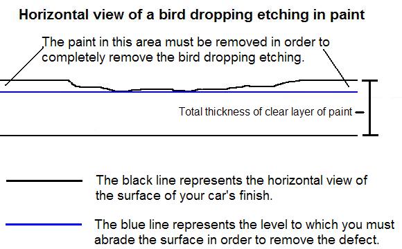

Here is how to remove a bird dropping etching or an isolated scratch.
1. Only work a small area at a time - about 6 inch by 6 inch area or smaller
2. You can apply using a combination of circular motions and straight-line motions
3. Work the product against the finish until it looks as you have almost run out of product.
4. Re-apply the product and repeat the above steps 2-3 more times
When I apply ScratchX like I have listed above, I am able to get out about 95% of a bird dropping etching or isolated random scratches.
The trick is to work the product in until it just begins to disappear and to apply more than one application. You see, the ScratchX, like all Meguiar's Paint Cleaners, contain a diminishing abrasive, as you work ScratchX in, the microscopic diminishing abrasives gently abrade the surface removing small particles of paint. But as you work it in, these diminishing abrasives breakdown. Thus, they quit abrading the finish and actually polish the finish to a clear, high gloss. This diminishing action turned polishing action is a benefit to you because it enable you to work out defects without leaving scratches behind.
Because the diminishing abrasive breakdown, you need to re-apply and repeat the process until the defects are removed.
Note: You can rarely remove a bird dropping etching, or a scratch, from a clear-coated finish with one application.

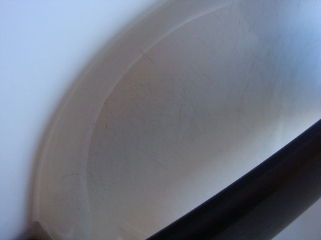

I have used it only once last weekend after washing and before polishing. For my first attempt as an experiment, I thought it was fantastic. My paint has alot of minor and bad abrasions and swirls from previous owner. It certainly cleared up alot of the minor issues. For $18 I think it is money well spent. After reading above posts, I am keen to get back into it.
ah! cool cool! i got some scratch X today for round 14dollar ish... already "tested" some before i got it and it did what i wanted it to do! going to hunt down all the scratches and what not tomorrow after a wash!

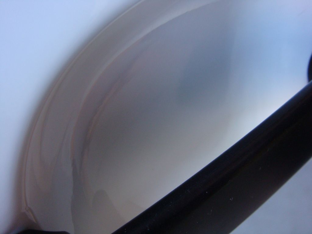

BEFORE
AFTER
This may not be surprising for people that have used scratch x or does a lot of car detailing but this is my first time and i am certainly amazed :)

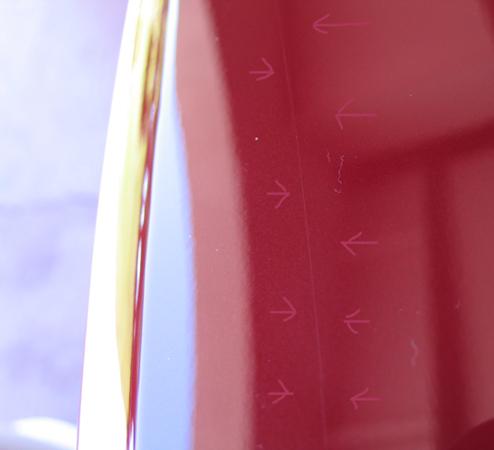

more pics of before and after.
before, clear coat red metalic
after, gone

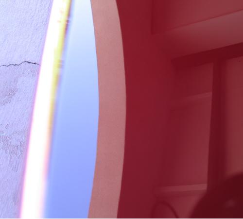

Surface is heavily oxidized and neglected.
This is my mums 96 camry
Before:
After:
All this from the wonders of Meguiars Paint Cleaner, Clay Kit, Scratch X and then a 1 stage polish and wax compound called Cleaner Wax.
