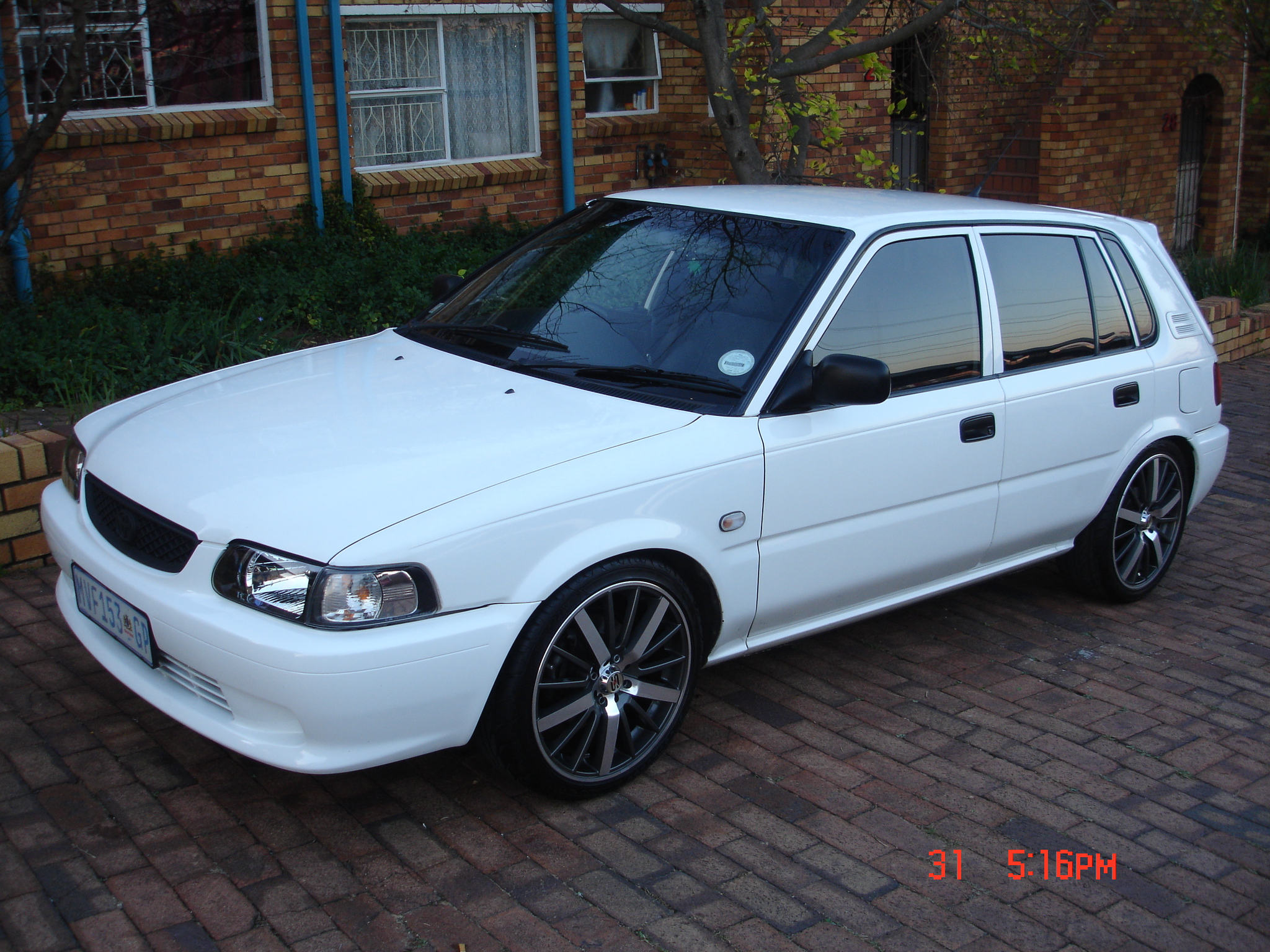

hi guys anyone can help me with information on this car ..... i have a toyota conquest the i am looking to convert to four wheel drive and apperently this car came out with a system like that
I believe you are referring to the AE95 which came out in a station wagon 4WD ...... i believe it came out late 80's and ran to about mid 90's ...... im guessing you're looking to adapt this to a ZZE corolla ..... besides the obvious will it fit questions i dont believe its been done before ..... but if you look around on google for AE95 SR5 you'll find the car you're looking for.
thanks guys. i am gonna try to attach what i own ..do you guys think i can make it fit ..... it a 4afe....front wheel drive.... i want to be the first in South Africa to build a 4-wheel drive with a 4agte motor ..... now that will make the hair on my balls stand
dont bother with the AE95 rear end... crappy live-axle rear end.
If you're going to chop up your floorpan you might awell graft in the rear of a GT4 setup, then you have a nice IRS rear end.
Once you have that in place you can use the AWD gearbox from the AE95 if you're using an A series motor with a suitable rear diff ratio, or if you're going with a 3S or similar just use the matching GT4 box for the rear end.
