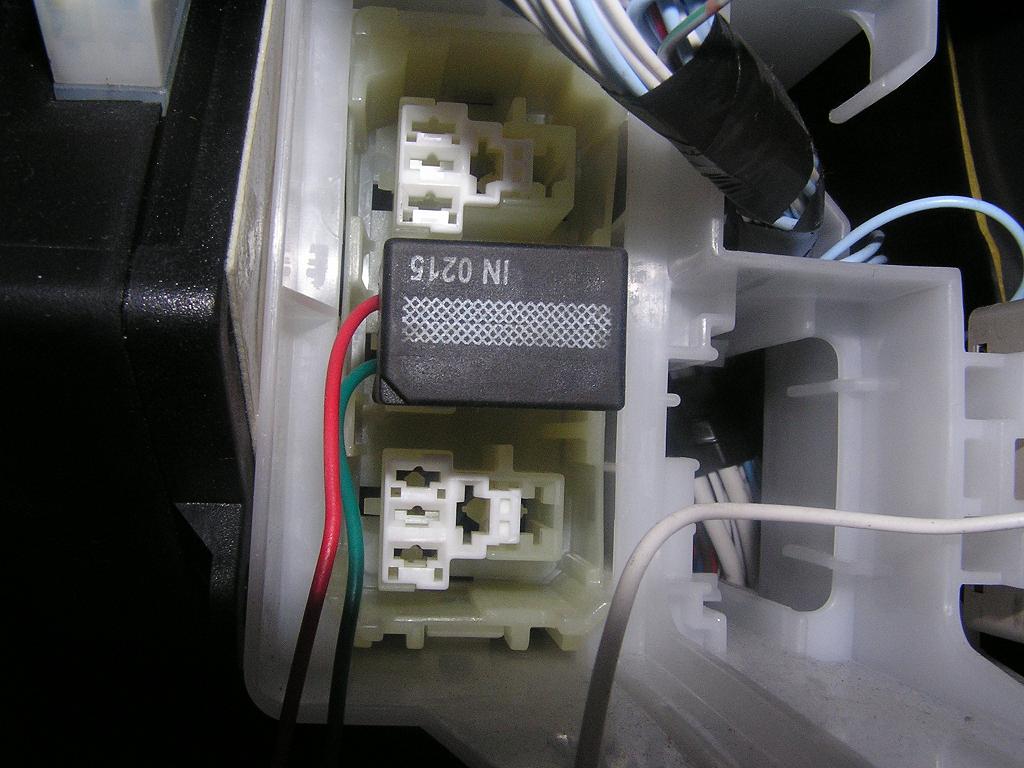

the brown connectors are the fog wiring, the relay holder is behind the coin box and fuse i cant remember but might be in engine bay. if you want to diy i will look later and and post some pics

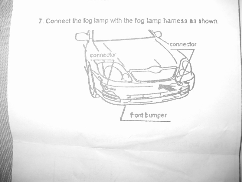

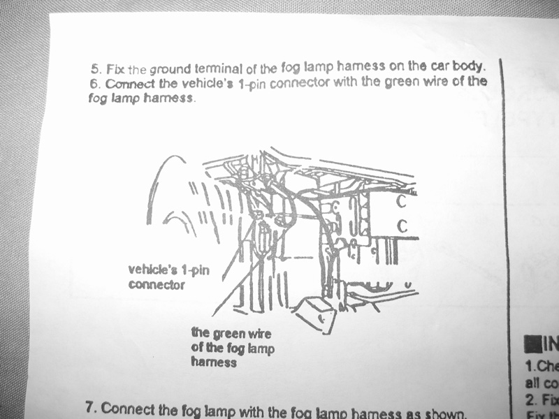

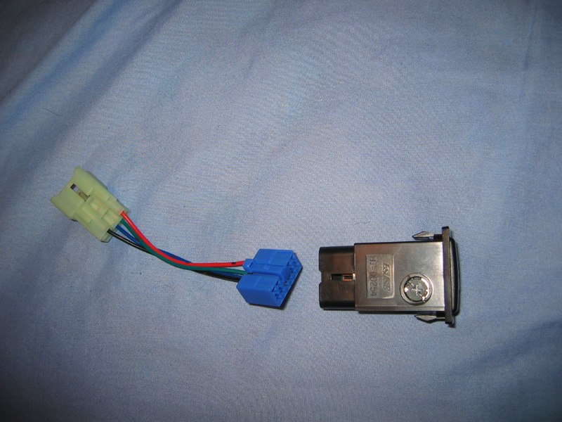

the instructions is abit weird. its telling me to connect the 1pin to da green plug :rolleyes: and doesnt even come with one. the colours are x1greyn x2blue and a black -tive hook.

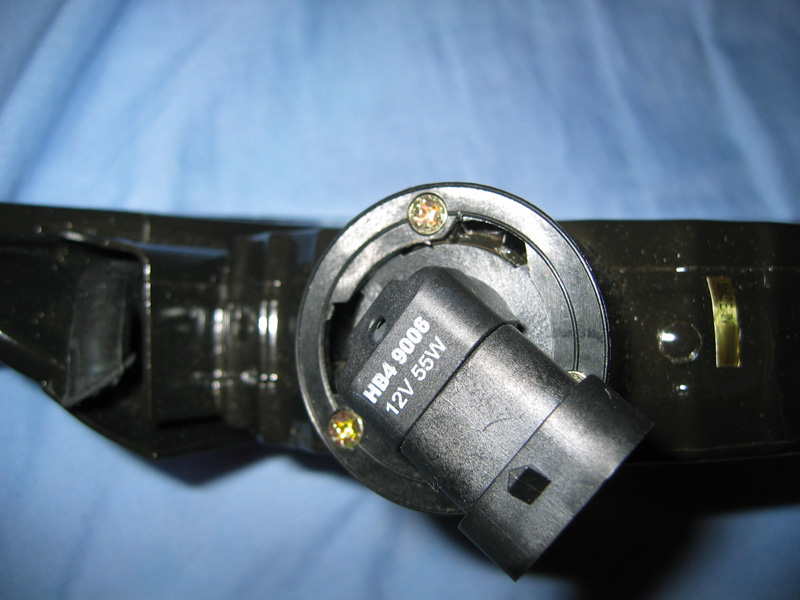

i dont know the kit you refer to I bought mine genuine. Is your toy facelift or pre facelift. the brown connectors plug directly into the globe HB3 or HB4. if your kit has different globes you might have an adapter in your kit. post a pic of the connectors in your kit and the instructions and I might be able to help you out.
mines the pre-facelift. soo its the long ones. heres some pics.
weird instructions
foglight bak
the switch and converter for switch

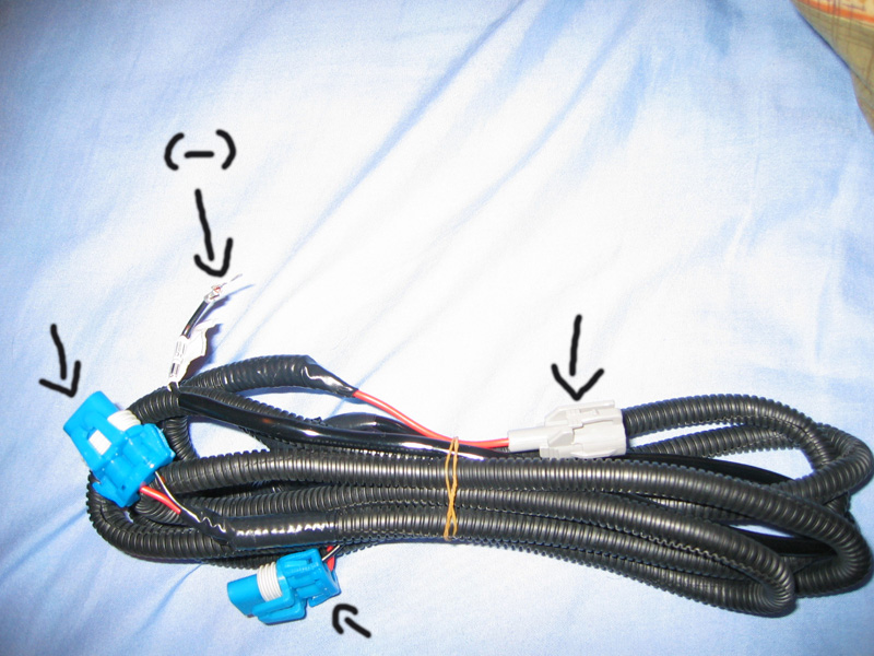

the wires (referred to as the "harness" in instructions). thats all the plug it came with.
I am assuming the ascent has the same wiring as the conquest
ok 1. connect brown connectors directly to fog lights
2. Take out coin tray and fit new micro relay (toyota or repco) as in pic..
3. blue connector into switch

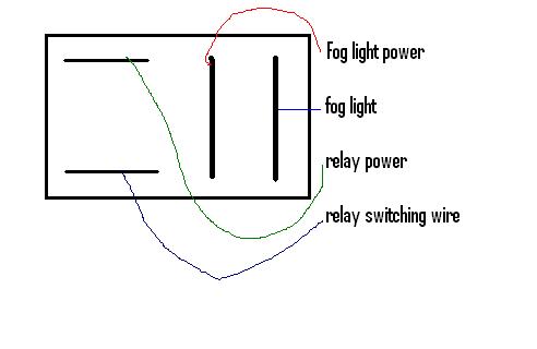

your switch is different to mine. I only have 3 wires so you have to work out the switch configuration i.e. red-power, black-earth, blue-relay switching wire, green-illumination. or something like that..
the switching side of the relay needs to be earthed.
if I knew the switch I could tell you more, sorry
