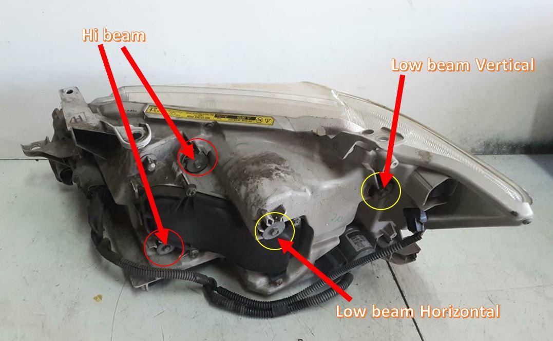

Sometimes, you have no choice but to adjust the headlights - mine were too high :nono: Once I worked out what each of the 4 adjustment screws did, I got a reasonable result. Hopefully you can see 2 photos of the LHS headlight which shows the locations on my 2008 AT-X Aurion... links below.
http://i1004.photobucket.com/albums/af168/sp0t13/Headlight1b.png
http://i1004.photobucket.com/albums/af168/sp0t13/Headlight2c.jpg
Unless I'm mistaken (and I could be as I only needed to adjust the low beam vertical), the screw directions for adjusting are as below (according to the size 2 screwdriver turn, not the hex head on the screw which will twist in opposite directions).
For the LHS;
  • Low beam vertical, down is clockwise
  • Low beam horizontal, right (inwards or towards the middle) is clockwise
  • High beam vertical, up is clockwise
  • High beam horizontal, right is clockwise
For the RHS;
  • Low beam horizontal, left (inwards) is clockwise
  • High beam horizontal, left is clockwise

Image below shows the screws for LO BEAM vertical and horizontal adjustments- the vertical screw when in position is impossible to access as it inside the guard.
Did not need to adjust hi beams as they were good.
