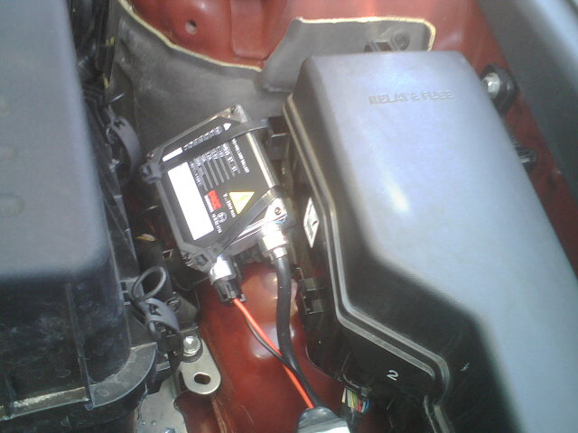

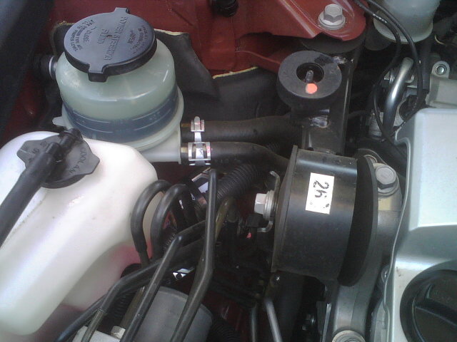

It depends on just how perfect you want to have it. I was considering pulling the bumper off to mount the ballasts perfectly, but I didn't want the fun task of pulling it off again if the ballast was to eventually fail. Therefore:
... I couldn't really figure anything out that would be the most ideal (without removing the bumper), so I mounted one below and in front of the battery, and the other... well the picture will show. They are held down with a bolt, and I put a cable tie around it to keep 100% secure.
Well... the way i placed my ballast i could use my hand and wretch it out if it fails...

Cable ties FTW. Have saved my a** many times.
That's how I installed my ballasts at first. Then I got my hands on some self drilling metal screws. Put one through the bracket to hold it down but left the cable ties on to prevent any movement.

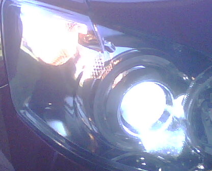

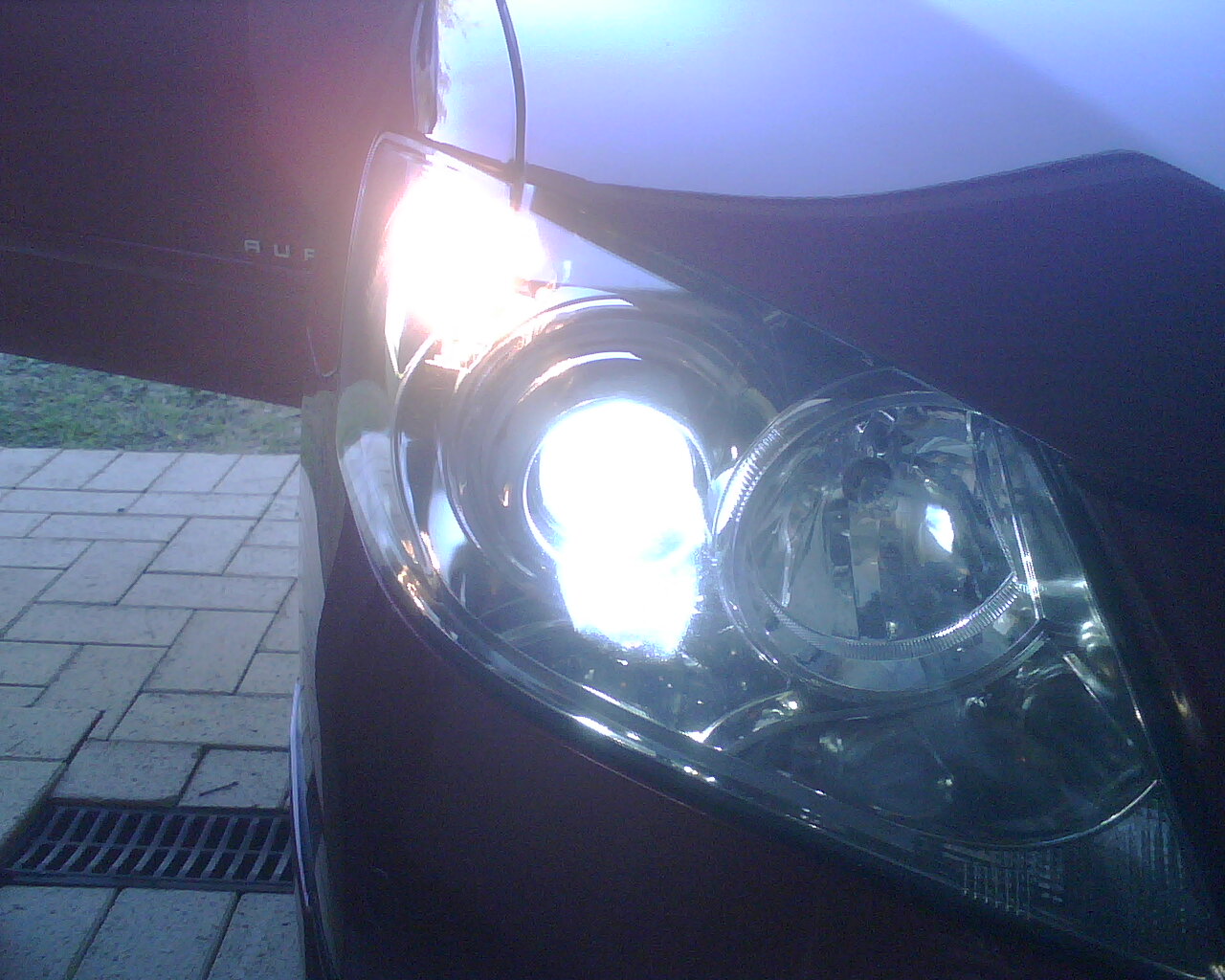

ok before i sing Daryl's praise again let me tell you a little about why i went for HID's... I live in a very small country town and work at a hotel about 10km out of town. Its a wonderful 90km/h drive with windy roads, sligt elevations and no lighting what so ever. I asked this forum about HID's and daryl recommended 6000k in the low beams and leave the high beams alone....
Result, Perfect! last night was the first night driving home and the blue tinge of the HID's seem to spread the light further and wider and clarified the white posts along the road. Add to that the yellow/white of the high beam it was almost like driving in daylight!!
once again Daryl, thanks for the perfect advice!
55w HID high beam FTW!~
literally lit up the everything around me and then some...
