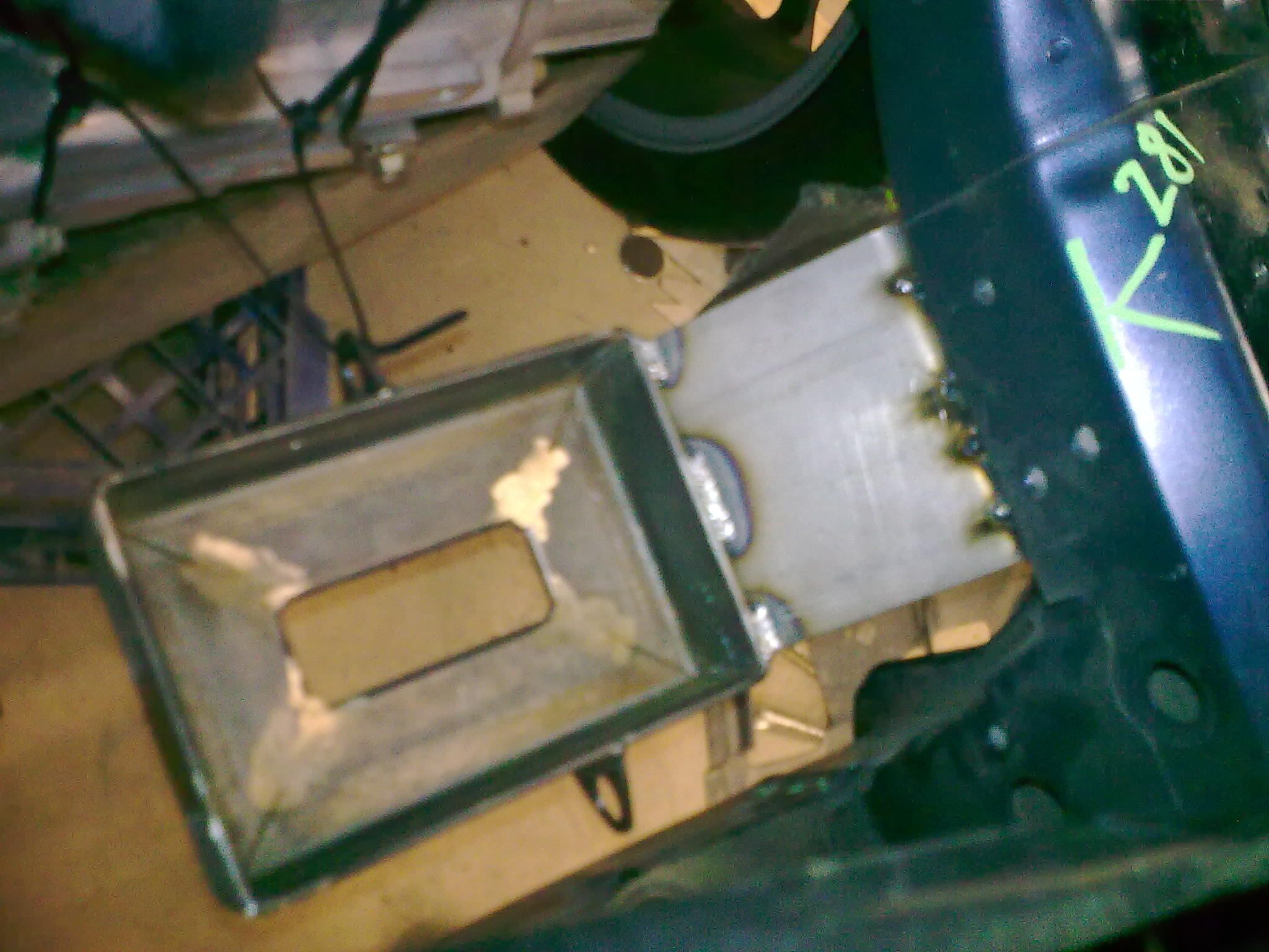

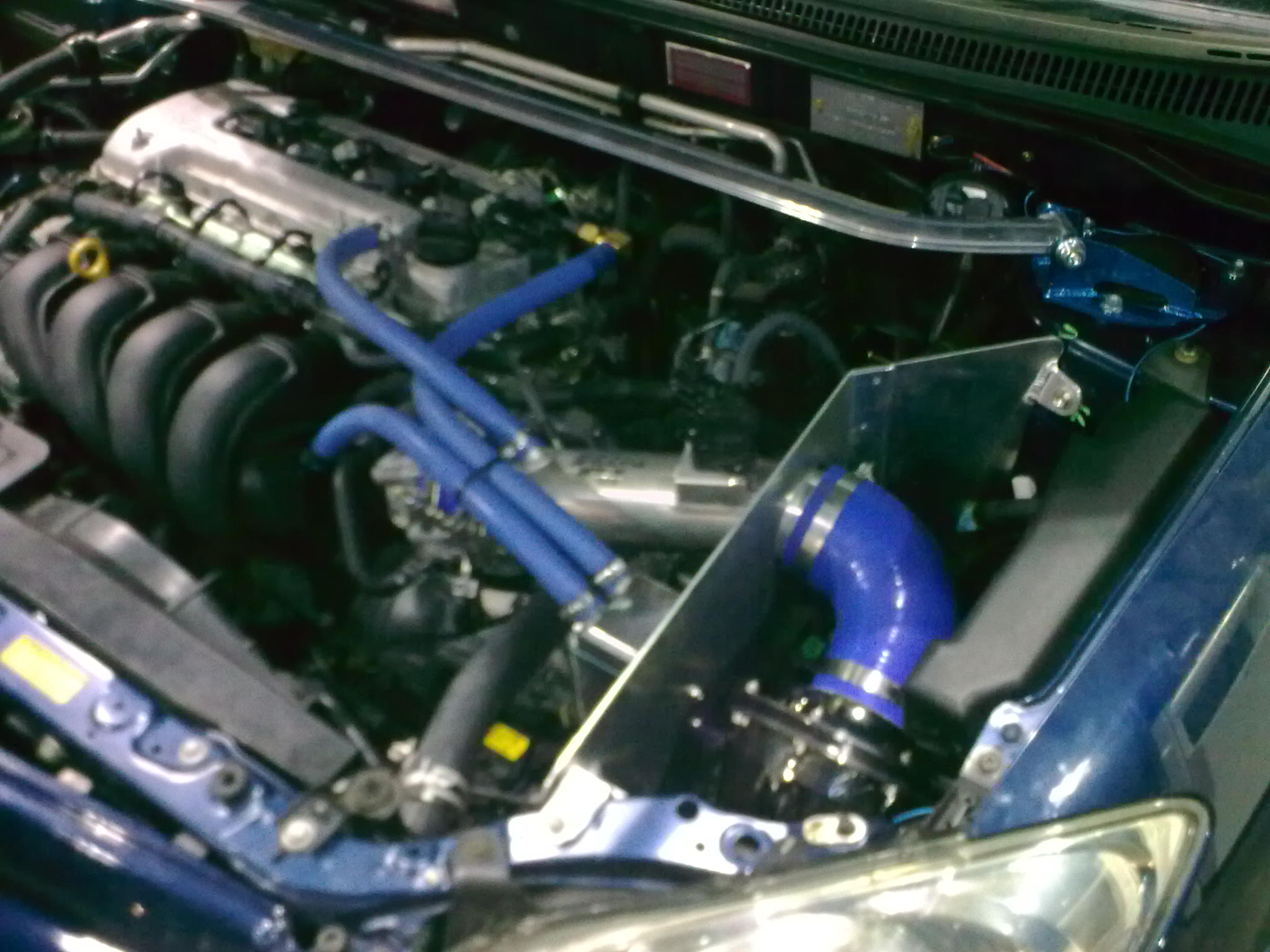

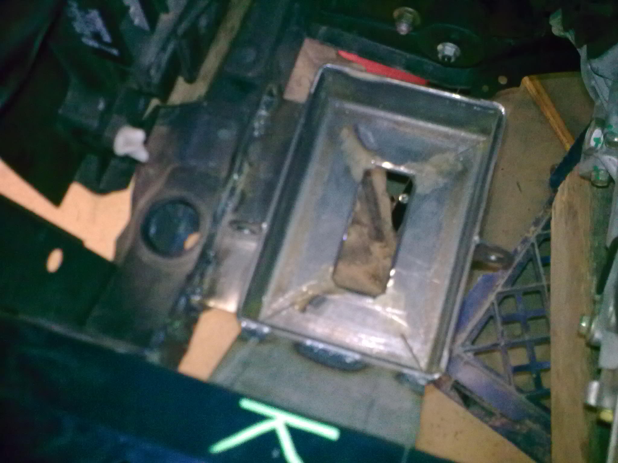

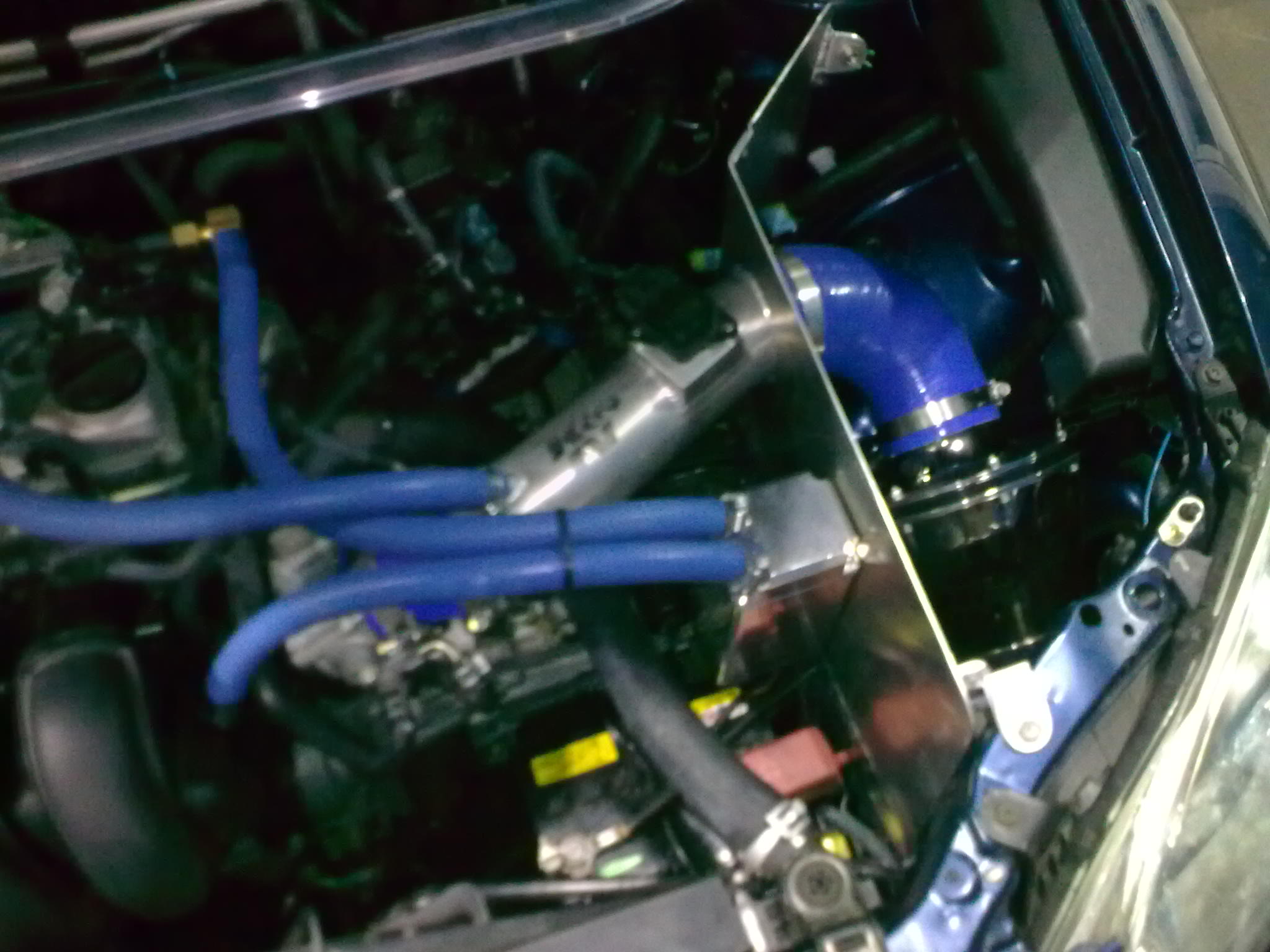

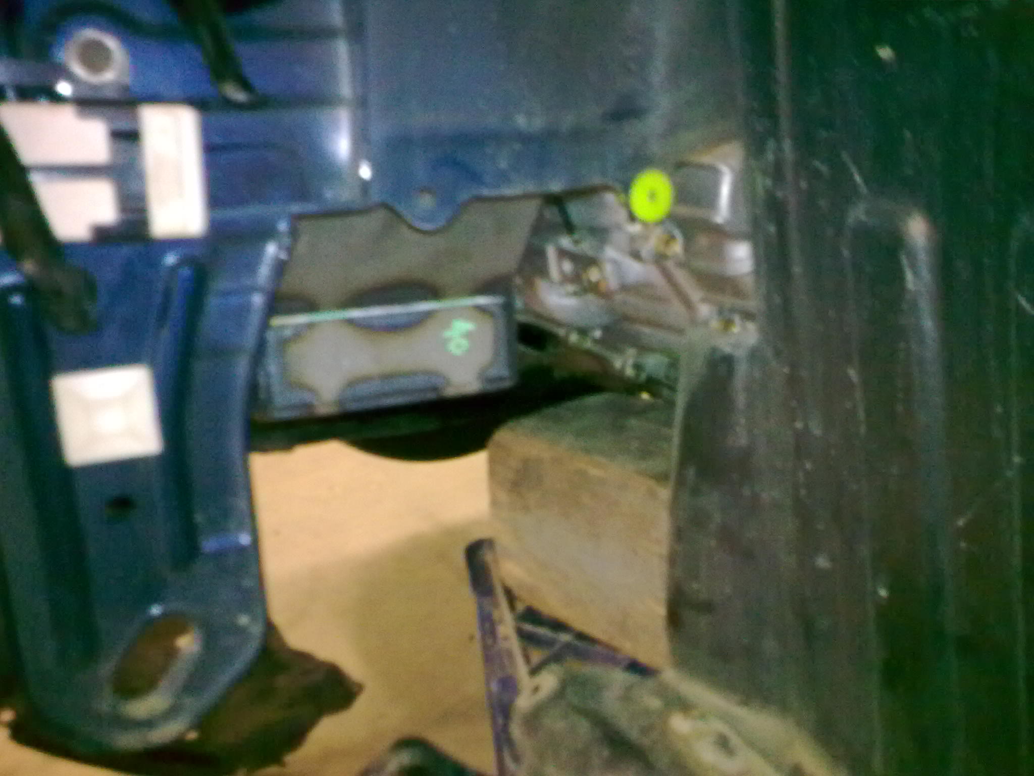

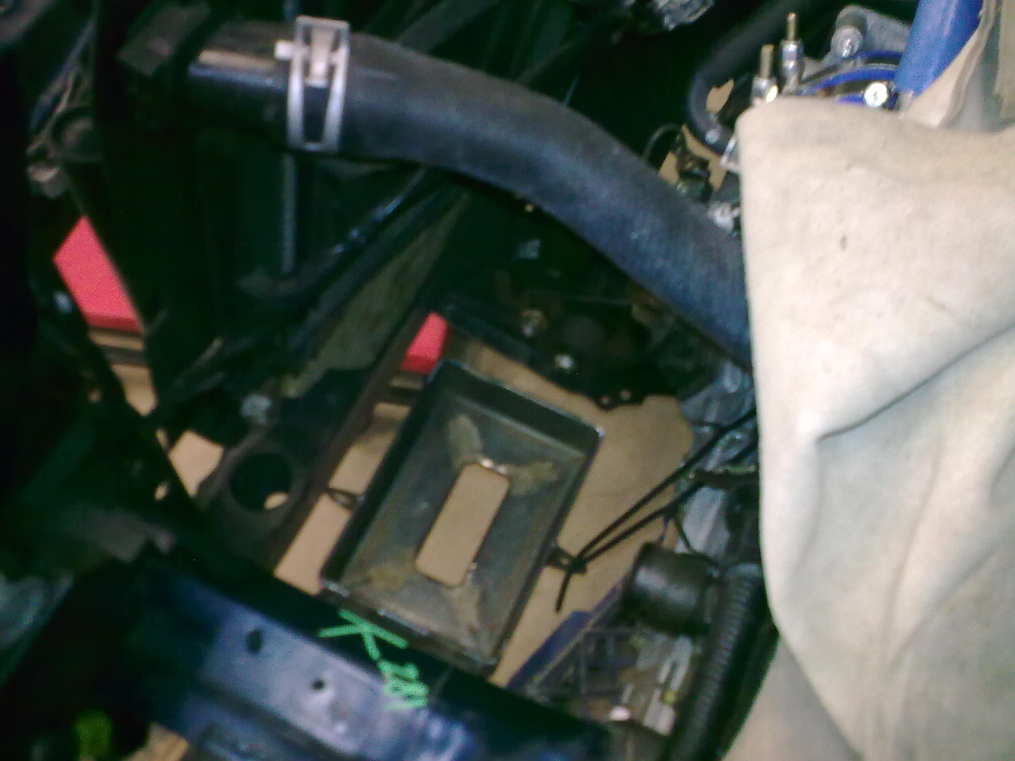

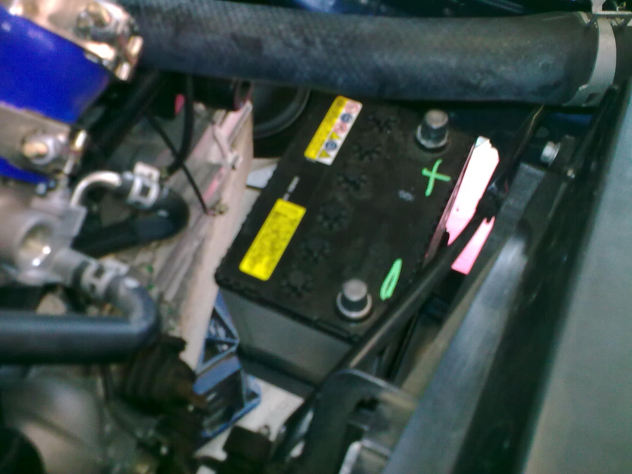

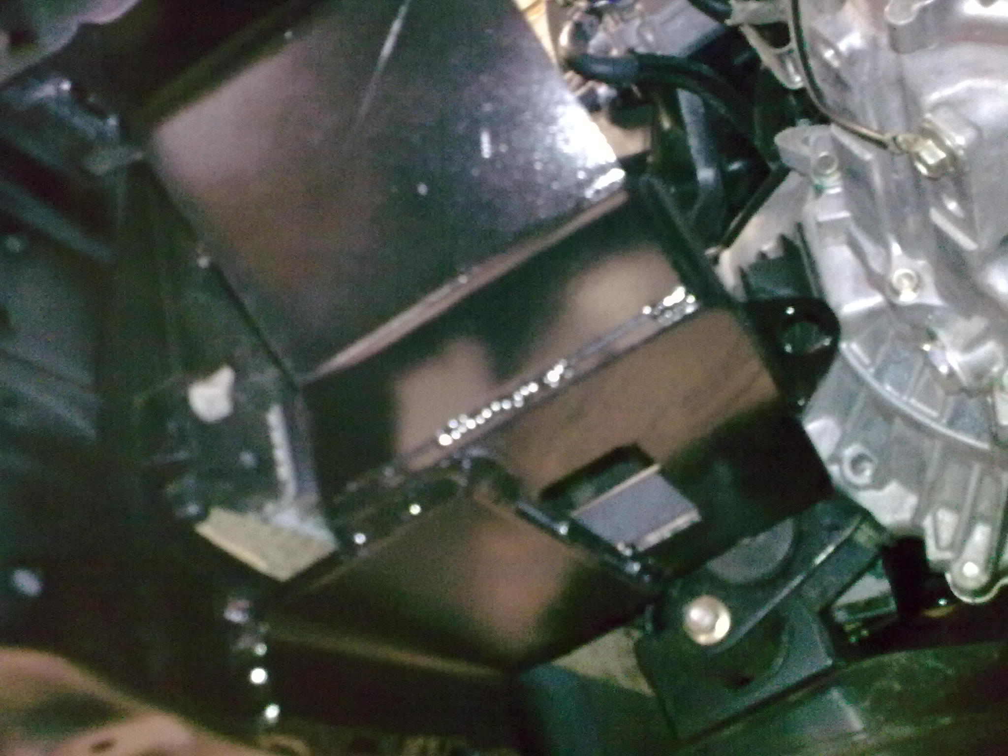

:toast:post-10345-1228557871_thumb.jpgpost-10345-1228557905_thumb.jpgpost-172-1098443217_thumb.jpgpost-10345-1228558006_thumb.jpgpost-10345-1228558034_thumb.jpgpost-10345-1228558071_thumb.jpgpost-10345-1228558102_thumb.jpg[attachment
=7421:Picture_019.jpg]update on battery relocation what u guys think of the finished product, battery sitting just behind the radiator on the left down low
t
dam good work you got there :)
:yahoo:
Not a bad concept at all...
How accessible is the battery to get in and out???
Also, does it have to be removed to get access to the gearbox filler plug???
thx, doesent have to be removed but makes it easier, even if u have to remove only takes bout 10mins catch tank remove battery slides out. allso added rubber to the top of the sheild this morning to completelly seal it off from the rest of the bay
