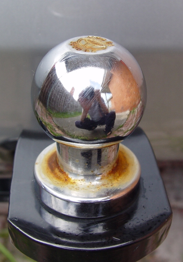

It's been a year since I got an Aurion and noticed rust on the towball from few months ago. I cleaned it once using scratch removal but got rusted again quite quickly.
Is it normal or should I replace the towball?

Normal, the chrome coating will always be rubbed off by the trailer hitch. If you grease it up a bit, it shouldn't rust as quick.
You can replace them quite cheaply though, if you're more concerned about the looks.

Oh, I was serious when I posted the question up.
I think I'll just clean it up again and put some grease on it. Thanks 'the random hero'

The bad thing about tow balls is the chrome damages pretty easy. even a few scratches will cause it to go rusty. The good news is, its totally normal. My last car was a Rodeo Ute with a tow hitch that was used every second day. The tow ball now has no chrome left on it, but it has not lost any ability. Be more concerend for it if it looks bent one way or another, or has cracks showing on the thin neck part of the ball.
To fix it up, you can either replace it, as already mentioned, or if you do want to clean it, you can use stainless steel wool and some warm dish washing liquid. Stainless steel wool should not be hard to fine, or you could use a stainless wire brush. Use stainless steel so it wont leave and iron behind, as that is what will rust as well, and defeats the purpose of cleaning :)
Or you could just buy yourself one of those tow ball covers that just slip over it very easy to take off when youre coupling a trailer and put it back on after.
