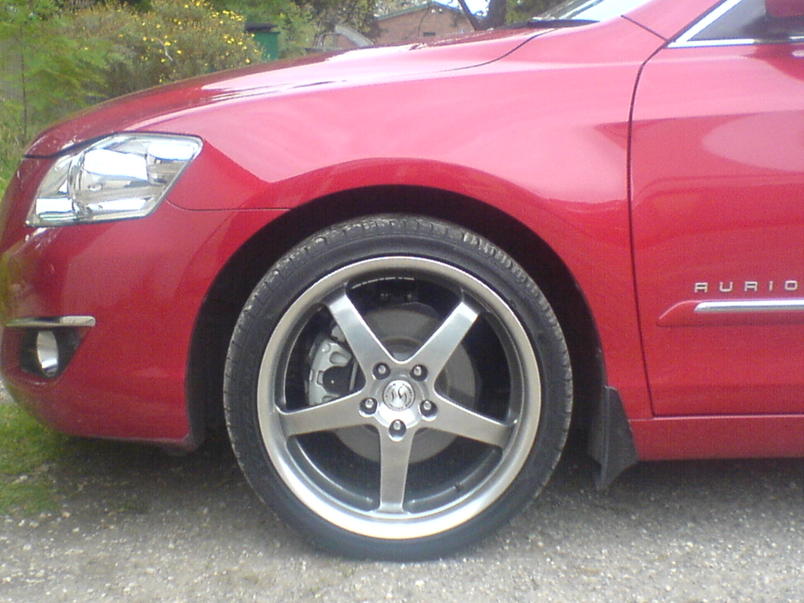

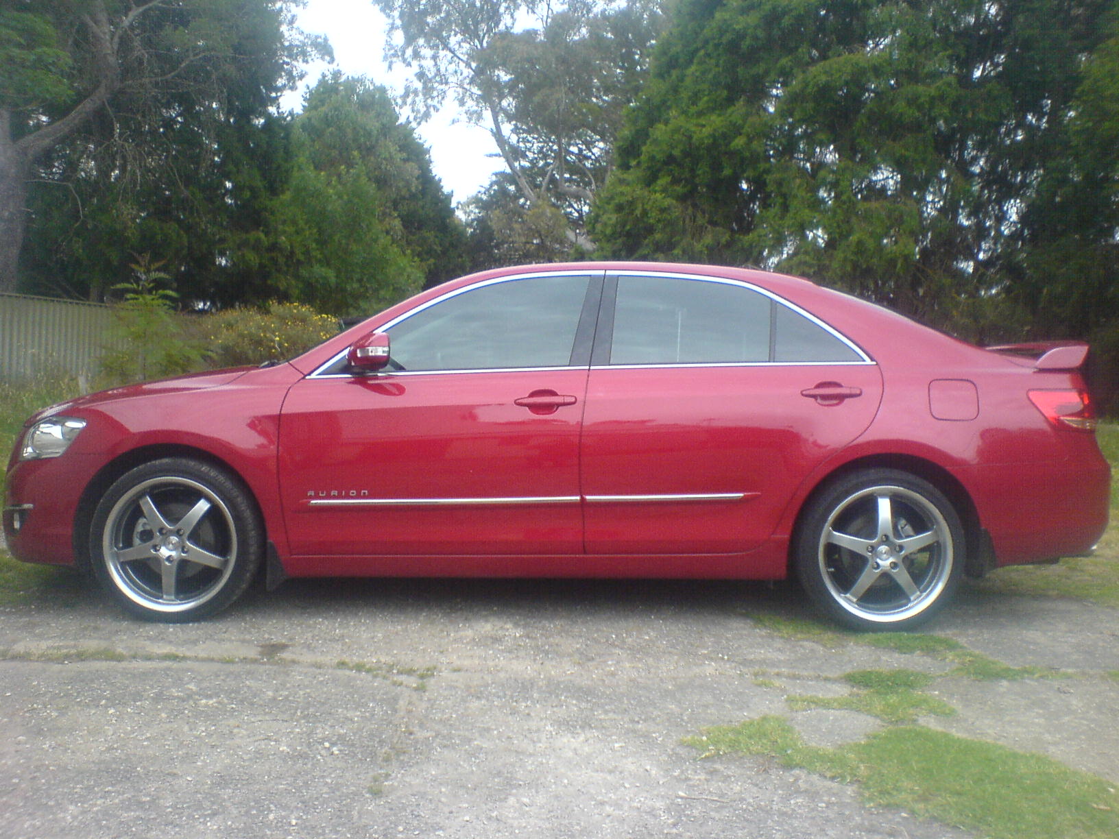

I have 19" x 8.5 and they have never scrubbed.
I've done just over 30k without a single problem... other than curbing both fronts!
PaulMT - I like those rims. They blend in well with the car. Not basic like stock rims, and not too flashy that it looks aftermarket.

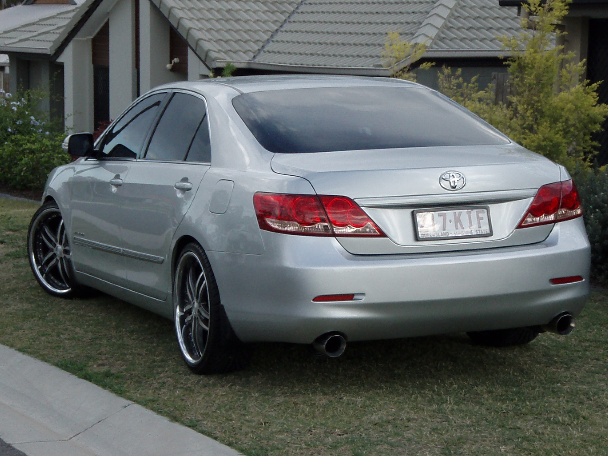

heres mine mate 235/35/18's i think the chrome rims really set the carribean blue off
