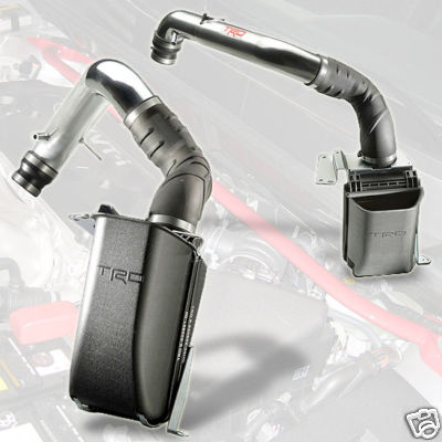

shouldn't be too hard to install the Cold Air Intake
