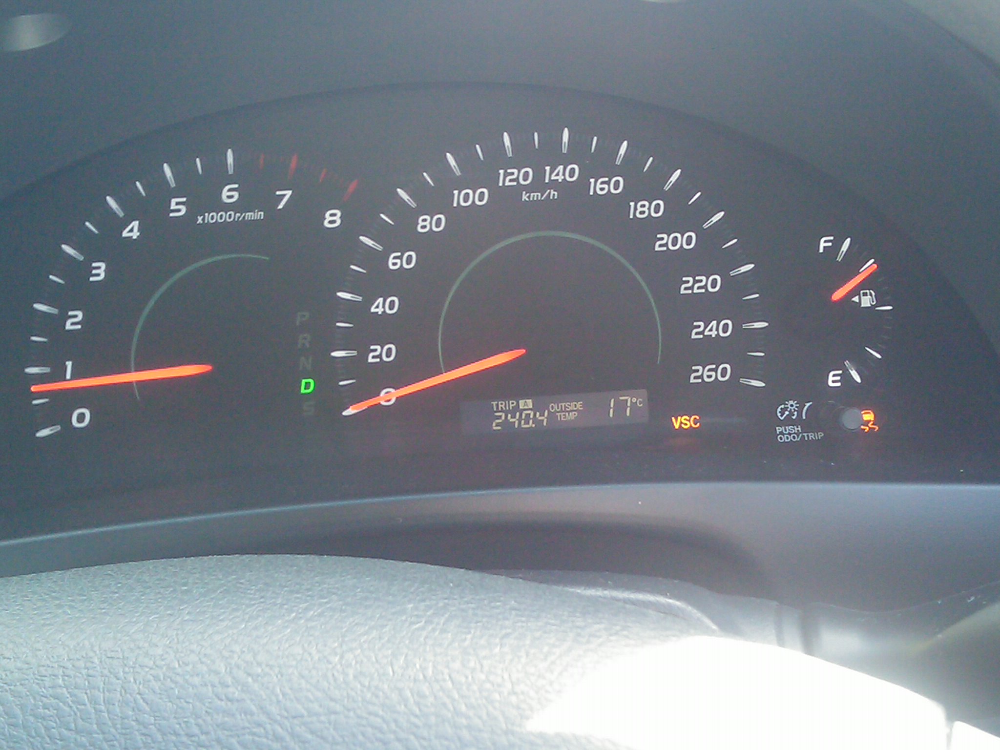

Gday everyone, i'm making a post in relation to a recent problem with my ZR6, i found it happened in the recent Melbourne heat wave. Out of random the VSC (Vehicle Stability Control) failure warning came up on my screen on the speedo along with a red warning light and an amber image of a car loosing traction, I took it to toyota and the readouts that they got were that the 02 sensor played up, it worked for them that day and worked on the way back home, but not long after it popped up again, I got a dealers warranty with this car still and I am taking it in this Friday. I wanted to know if anyone has had this problem and if so what would cause it.

I had this problem when a hose connecting the supercharger to the engine ruptured due to my relaxed driving style. However, once it got fixed it never came back and it's been 6 months since it happened.
Anyway, I think this warning light comes up as a blanket for quite a few conditions and it is hard to pinpoint exactly what is wrong unless a physical check is made.
The 'Check VSC System' warning will come up at any time a check engine light comes on. Mine did it when I accidentally started my car with the MAF sensor unplugged. About 5 metres of driving and the VSC warning came up. Some people have reported that by having a loose petrol tank cap, you can trigger the same response.
I don't know why it would do that, but it is certainly more intrusive than the lone check engine light. Maybe Toyota figured that if the 'Chack VSC System' warning flashed up, people would be more likely to get it to Toyota ASAP as it is a safety feature giving a malfunction warning.
A few months back I had my dash removed and reinstalled to fix some dash rattles.
They didn't put the car back together right and either damaged something or did not align/install it back right because as soon as I drove out that Check VSC light and bell came on. They had to order some cable or part and once changed the issue was fixed. All at their expense as the car is under warranty.
From the very vague description I was able to obtain, it had to do with the way the steering wheel was aligned with respect to some sensor used by VSC. Not sure if that's just made up stuff, but the steering wheel was offset after their initial dash efforts and the VSC problem wasn't there. When they straightened the steering wheel the VSC problem came up. After that part was changed, the VSC problem went away and the steering wheel was straight again.
