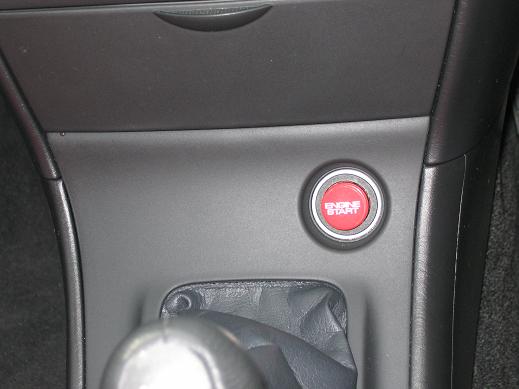

Yes, Odd did quite a nice job on his start button too. It looks like it came that way. I think he used an S2000 start button too.
Gav.
Scroll halfway done on the page I've linked to underneath and you'll see some pictures of my install. I think I have some more as swell that I didn not put up.
http://www.corollatsport.se/phpBB3/viewtop...=a&start=75
I used a Honda S2000 start button. Set me back about £65 inc. shipping (mind you..that was from England to Norway). Installation does not really require any special skills. You gotta take apart the center console and the covers underneath the steering wheel. Then butcher the ignition cable (hehe), do some easy wiring (instructions comes with the button) and some plastic work where you will be putting the button. Before you know it it's installed :)

It's in a box somewhere in my garage...hehe It will never go back in the same whole unless I buy a new plastic cover. The button I used had a larger diameter so there were power tools involved :clap:
First linky should work just fine.
Second one would also work, but you'd probably see the wire when it crosses over from the gearknob to the stock gaiter. Minor issue, though.
