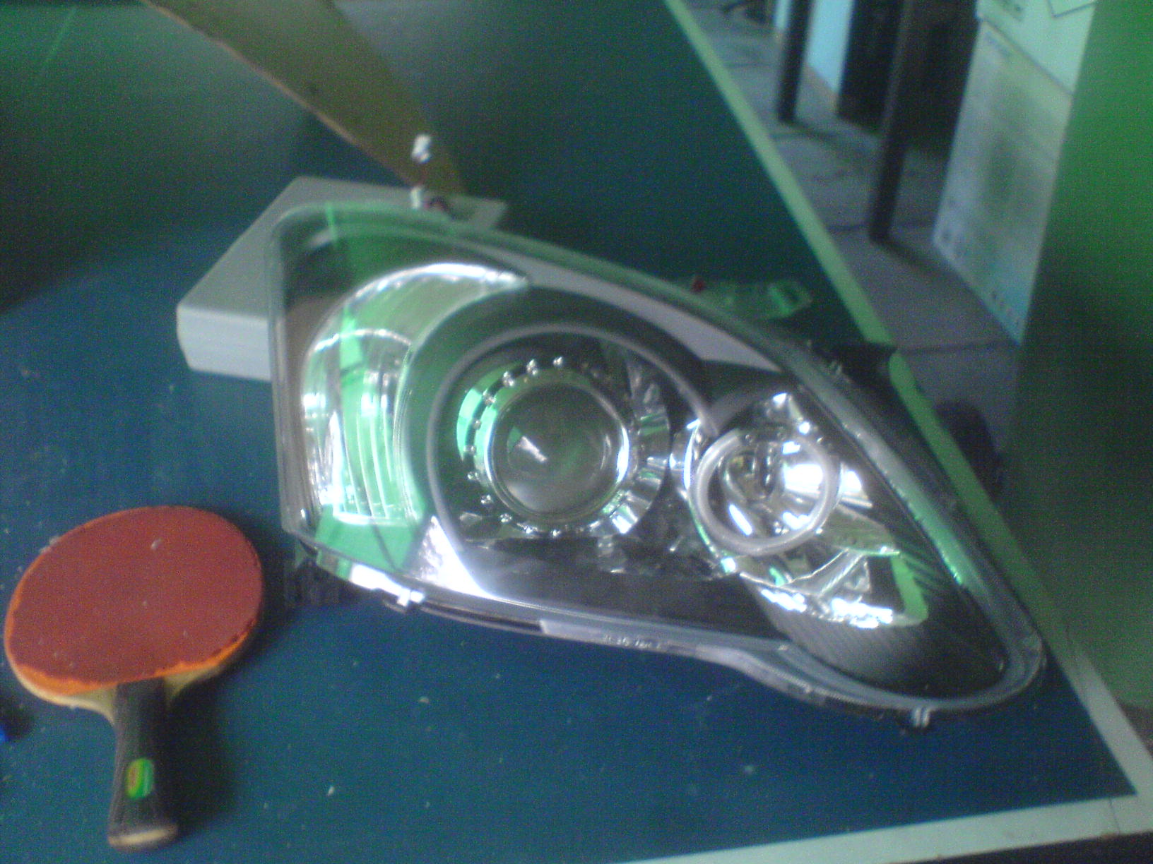

started the retrofit project. the projector's output and cutoff are a bit disappointing but continued anyway. shrouds are on their way but they are gonna be a bitch to fit in these lights. there isn't much room in there since i have to accommodate for projector aiming.
here's what they look like without shrouds

what projectors do you have on? my projectors are 3inch lenses and they are massive. i think 2.5" projectors would be best

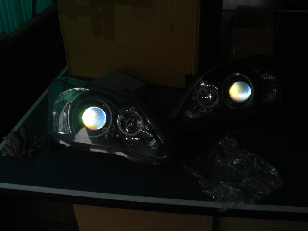

i received the shrouds. test fitting, a lot of cutting has been done since then :unsure:

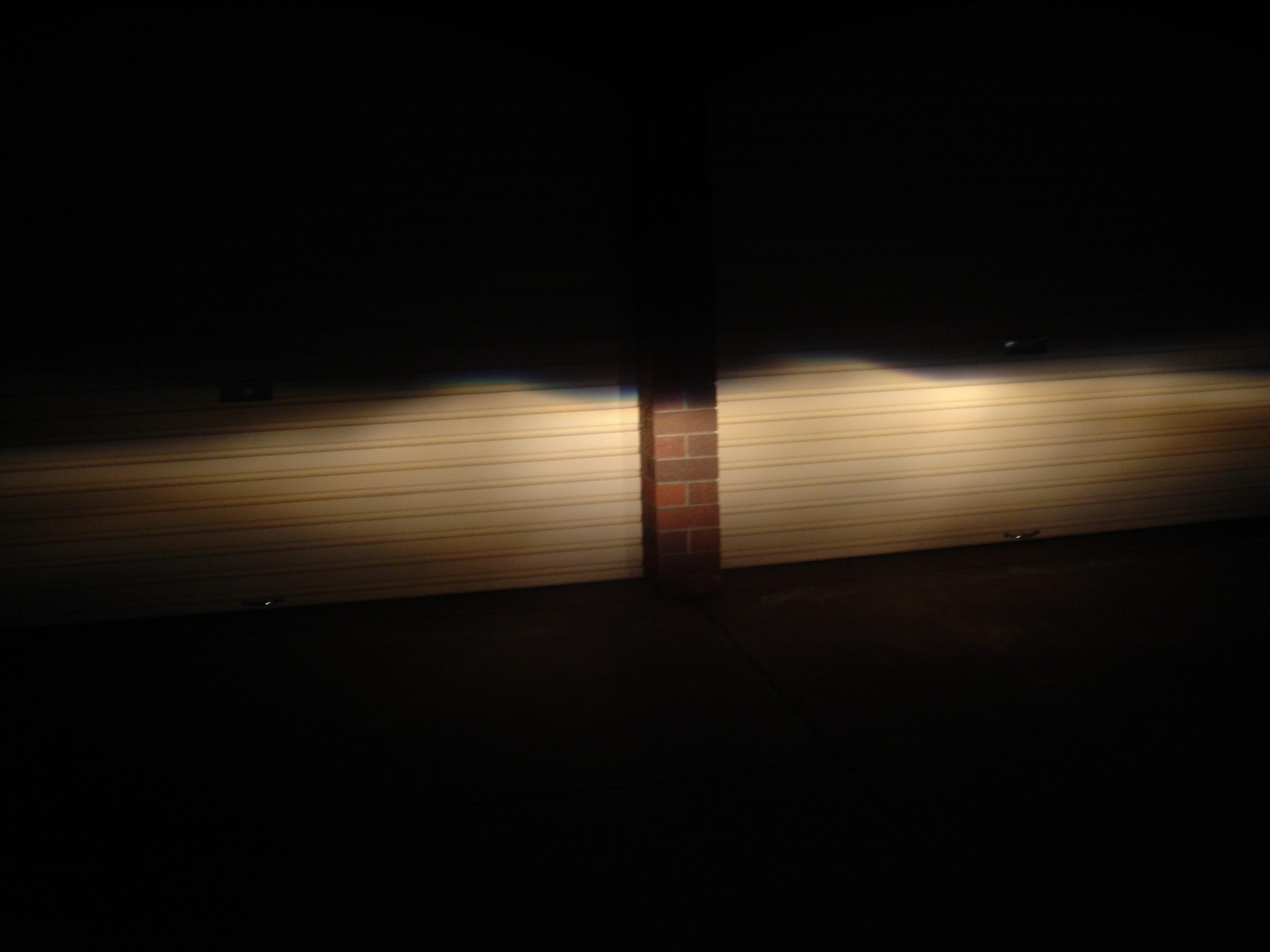

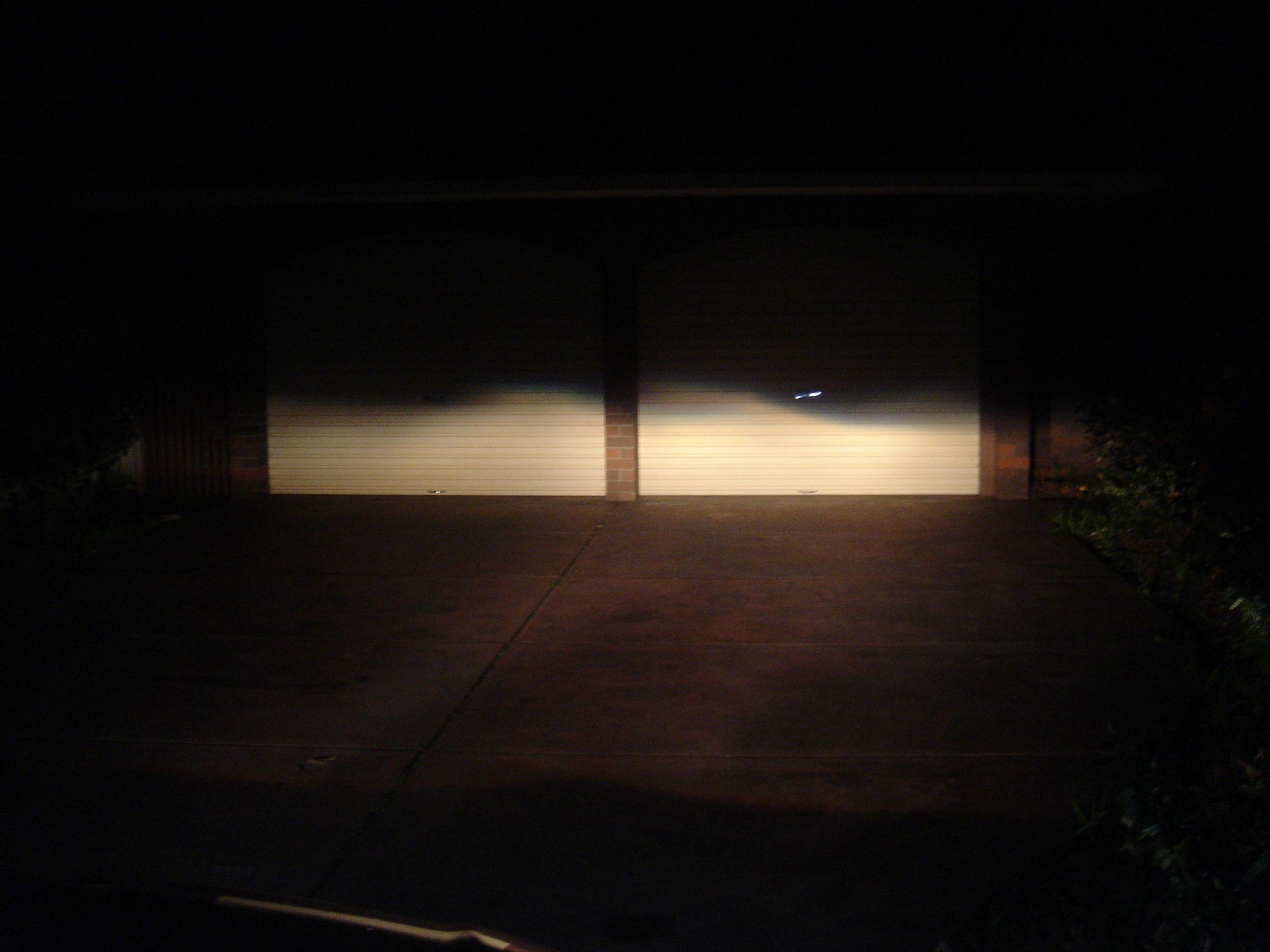

the halogen projectors i got are ok... strange cutoff pattern but i got colour
4metres
7metres
these projectors have a foreground limiter so it projects light down the road not in front of the car (thats for foglights) where you can't see it from the drivers seat.
the passenger side is aim too far to the right and thank god i used the rotational mounting method, definately needed that.

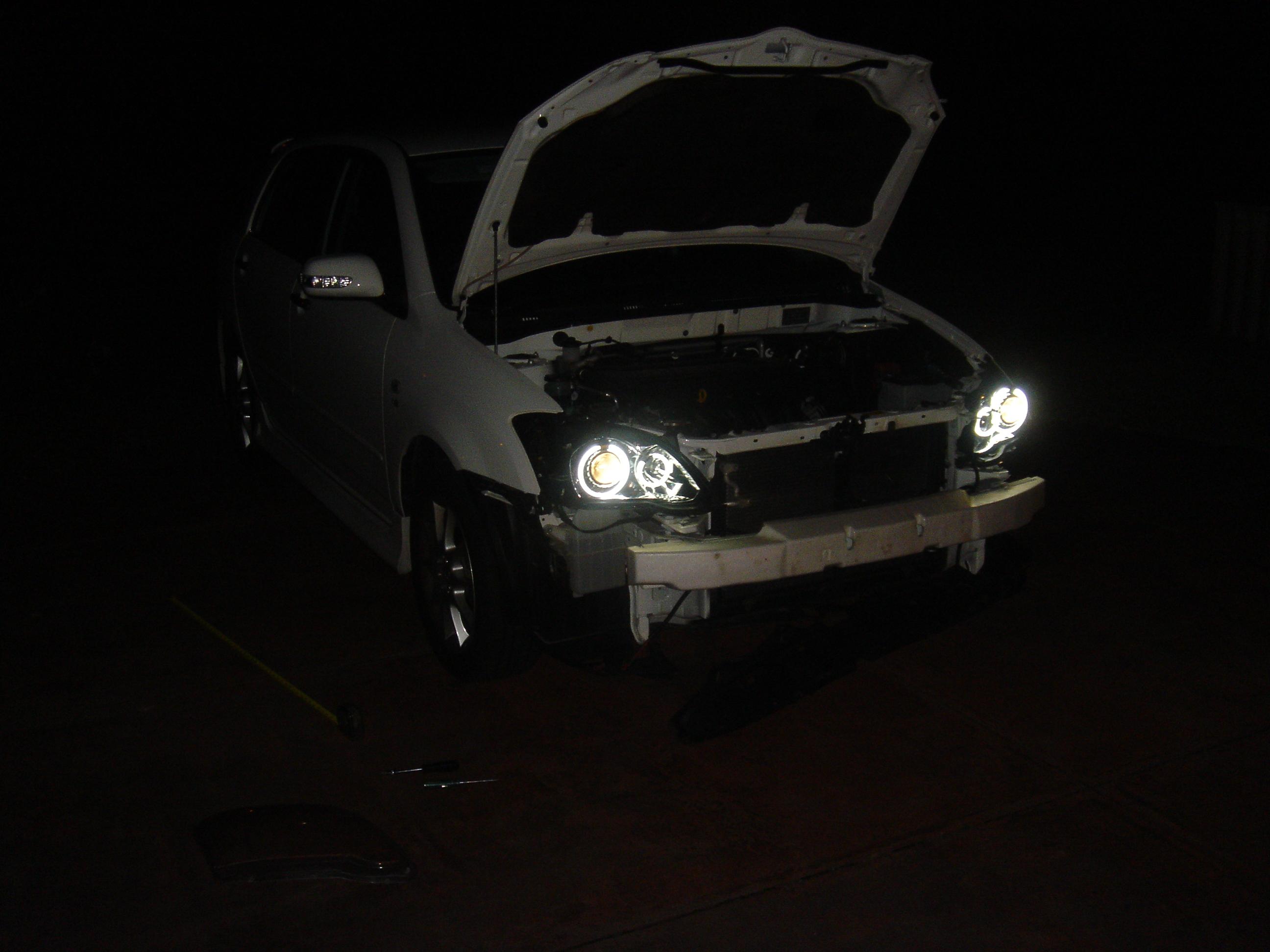

hey brad as requested :D but might go hid projectors after all

thanks for the comments guys, car definitely needs wash.
on the way home i realised that one projector somehow rotated abit :( strange since it was level before.
im still using stock halogen bulbs and visibility is about the same as stock
