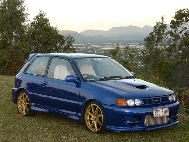

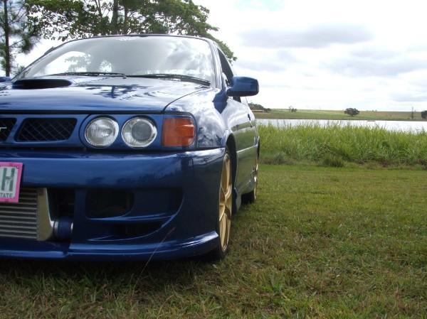

im tim i got myself a blue ep82 gt i bought about 18 months ago
bought it with the paintjob done and it had a t25 turbo and that was about all
since then she has had a large makeover and recieved

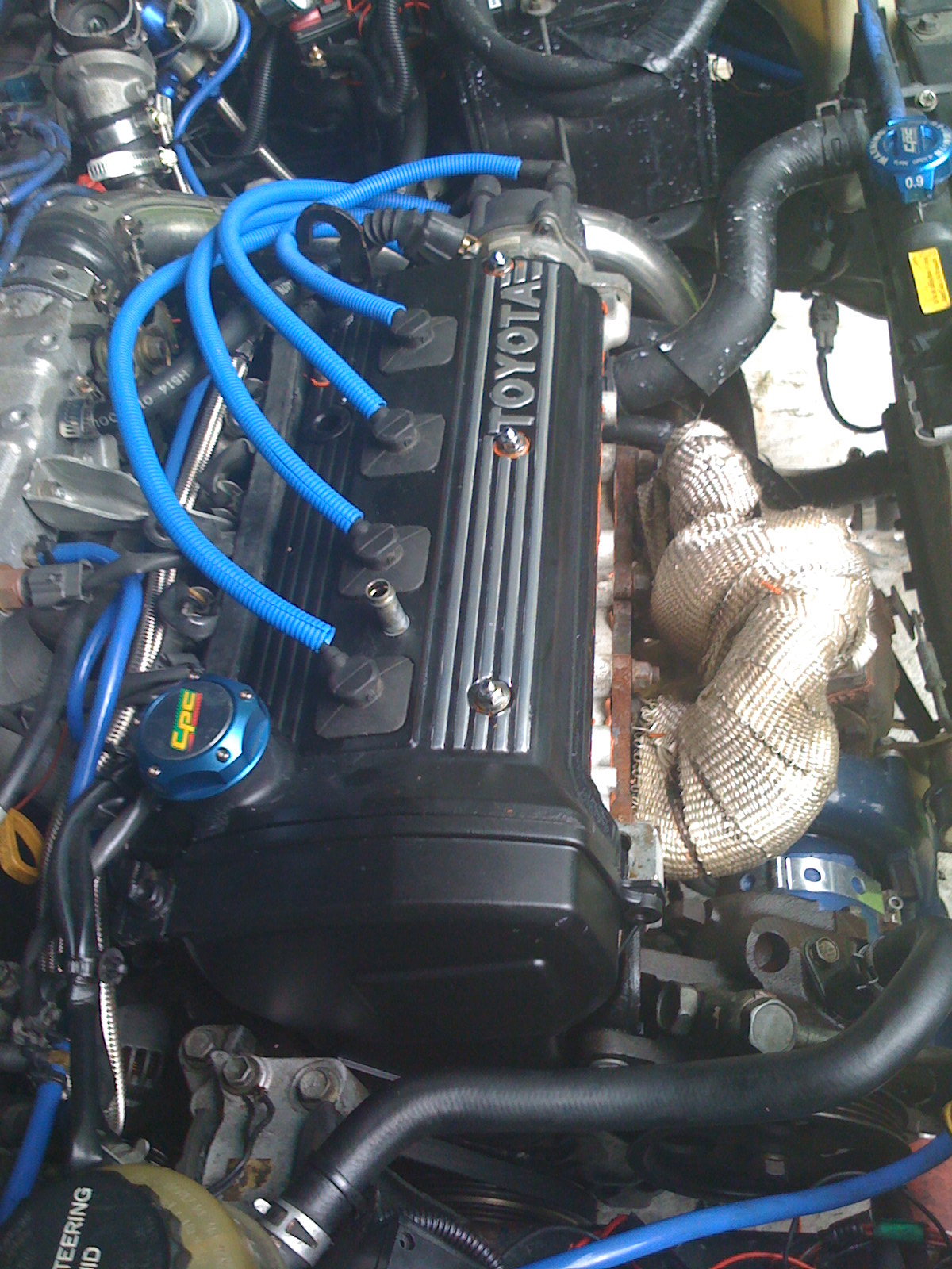

full forged build
wiseco pistons and scat rods
shot peened and nitrated crank
block was cryo treated as were pistons and rods
mls head gasket
gt2860rs turbo (15psi low 24psi high untill new injectors arrive)
e-manage ultimate ecu ( all tuned by me )
msd ignition
major let down atm is the gearbox as she is a single spinner (soon to b fixed with a cusco mz 2 way diff)
ACS clutch it was custom made specific for the car is a button but the plate is a corolla plate and a custom pressure plate so it isnt so heavy on the foot while having a large clamp force
kyb shocks and king springs (soon to be cusco coilovers or teins)
currently it makes a solid 240hp atw on 20 psi on a 36 degree dyno cell temp so will see what it can do coming in2 winter on high boost (28 or 30psi if injectors allow that kinda fuel)
hope to crack 300hp if i dont it gets a 2871r and big boost again lol
few other things i have forgotten but im sure the rest will come about one day lol
