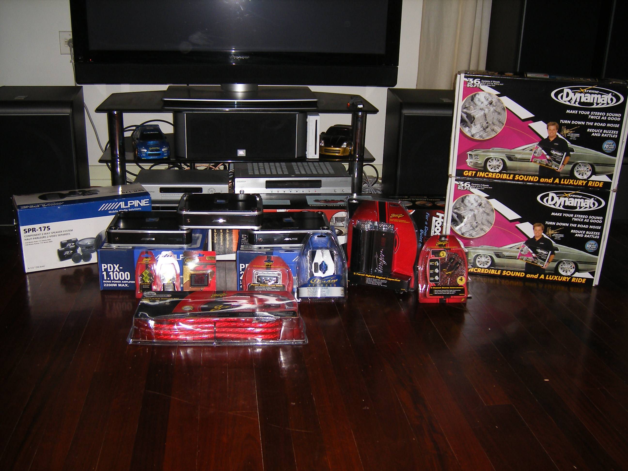

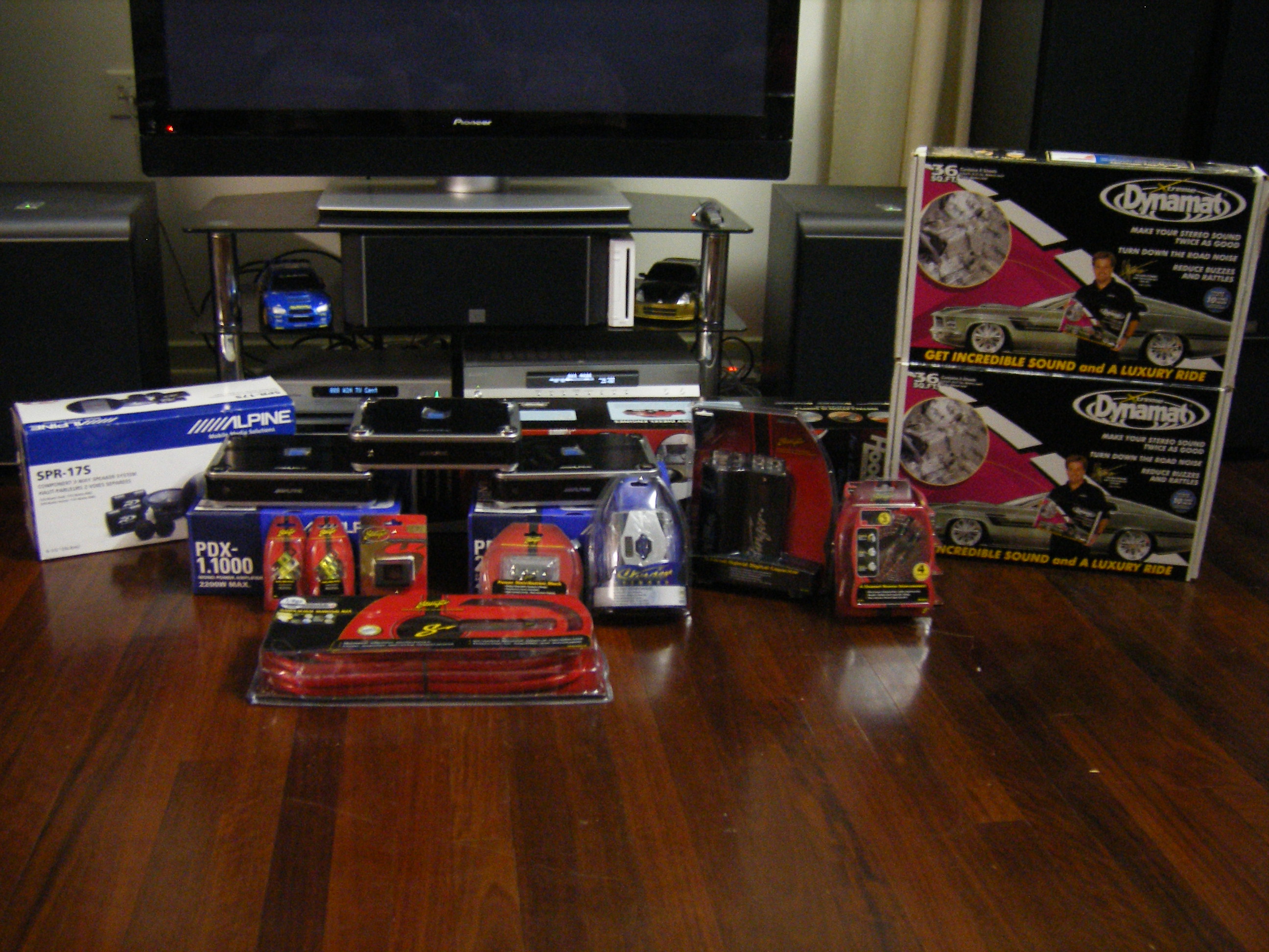

OK IT'S UNDERWAY!!!!!!!!!!
i know it has been a while since i first posted this but with rocky's biggest car show comin up in 5 weeks we'v had to pull our finger out and get started on the stivo, iv attached a few foto's of the collection of gear we have, the rest is still on order hopefully it should turn up monday, then wednesday we are off the goldy to get the fibreglass work/lessons done. once that is done then we r gonna start doin all nighters on it til its done and ready.
not all of the gear is going in at this point but the aim is to get the boot and doors done by the show then add a few more things later on.

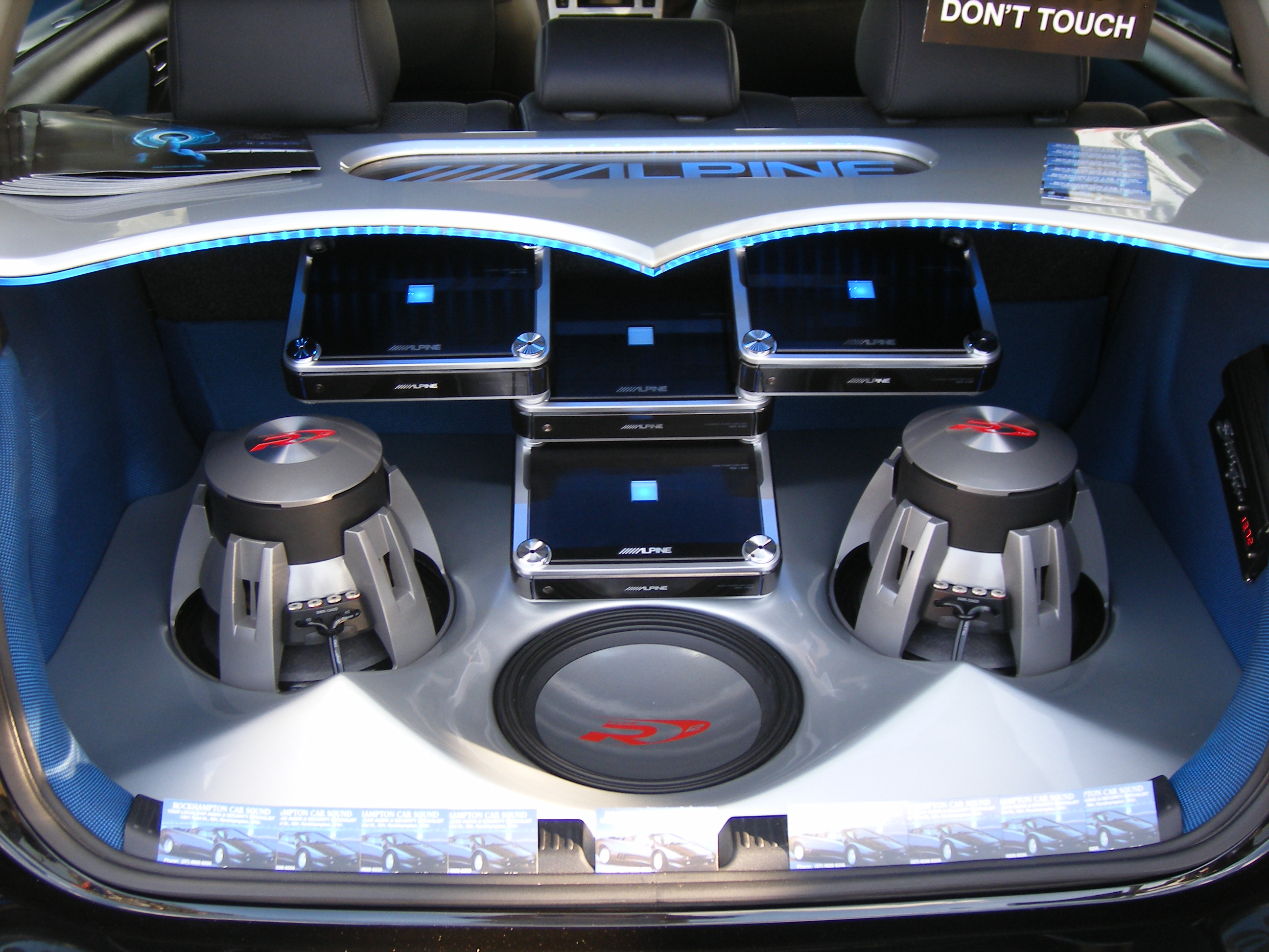

ok well the car show is finally over.. the build got completed the day of set-up. will post a link to heaps of build foto's but for now ill post a foto of the boot only. also won the 4cyl naturally aspirated category on the dyno comp, got 159.4 BHP on 19" borrowed rims. Also have a video clip of dyno run on youtube tomorrow, will post link of that too.
lets try these links, let me know if they dont work....
the material in the boot and doors is a blue/black woven material, unsure of what its name is i jus picked it from a selection swab at my motortrimmers.

that centre sub looks like a good spot to place my steel capped boots after a long days work and pumping it on my way home lol
your trunk set up brought a tear to my eye (its beautiful and reminds me of the alpine suv), i just decided to go spl with my woofers and pump 1k rms in each type r. and wishing i had a bigger trunk (stopped half way when i relised i cant fit a 4cubic box, crunched the numbers on a fibre glass with timber ribs, it was over my budget.
