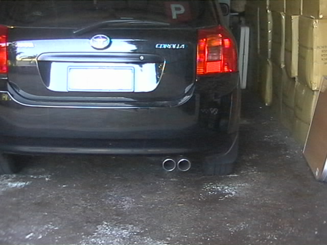

Ive put on a Lukey muffler, with twin 3inch tips... The sound is deep and nice. Not loud when not pushing it, but when u want some nice deep noise its there. looks phat aswell, a far cry from the standard ascent little black thing :ph34r:. i've had a lot of comments about the sound, all good.. The biggest comment i get is about the note it makes, very nice im extremely happy with lukey..but performance wise im not sure.. as im on my P's performance is not an option... YET :lol:

yeah i remember its an ultra flow muffler... i didnt remember at first but i checked and the tips branch out from the middle of the muffler, and that follows the layout of the ultra flow muffler.. ill post a pick to show you wat it looks.... doesnt look bad i dont think, doesnt look out of place compared to ones i have seen, like a big huge f**kn 5inch tip on like a mirage
I reckon it looks great, classic twin pipes and without the current trend of mufflers that are so low, you can't go over a bridge without scraping the expansion joints! :P
yeahh.. thanks mate, thats exactly why i went for wat i got.. doesnt look outta place or stupid.. does the job and does it well.. i think so atleast
