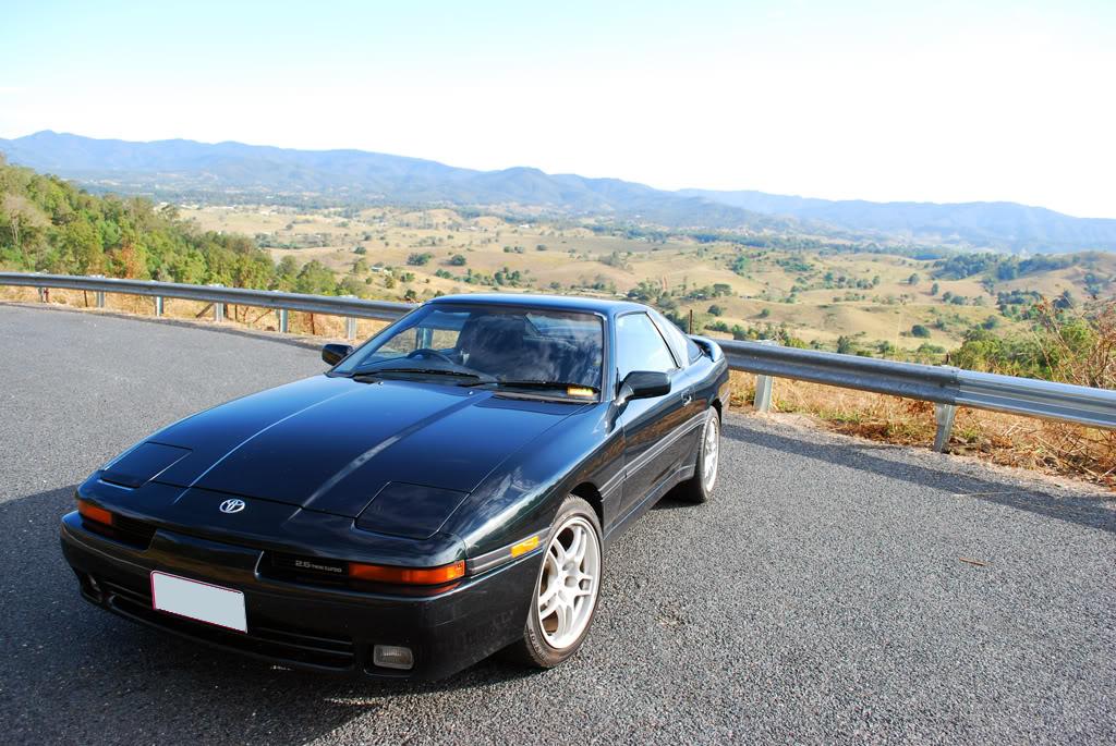

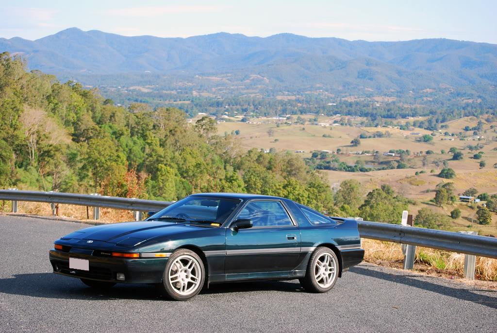

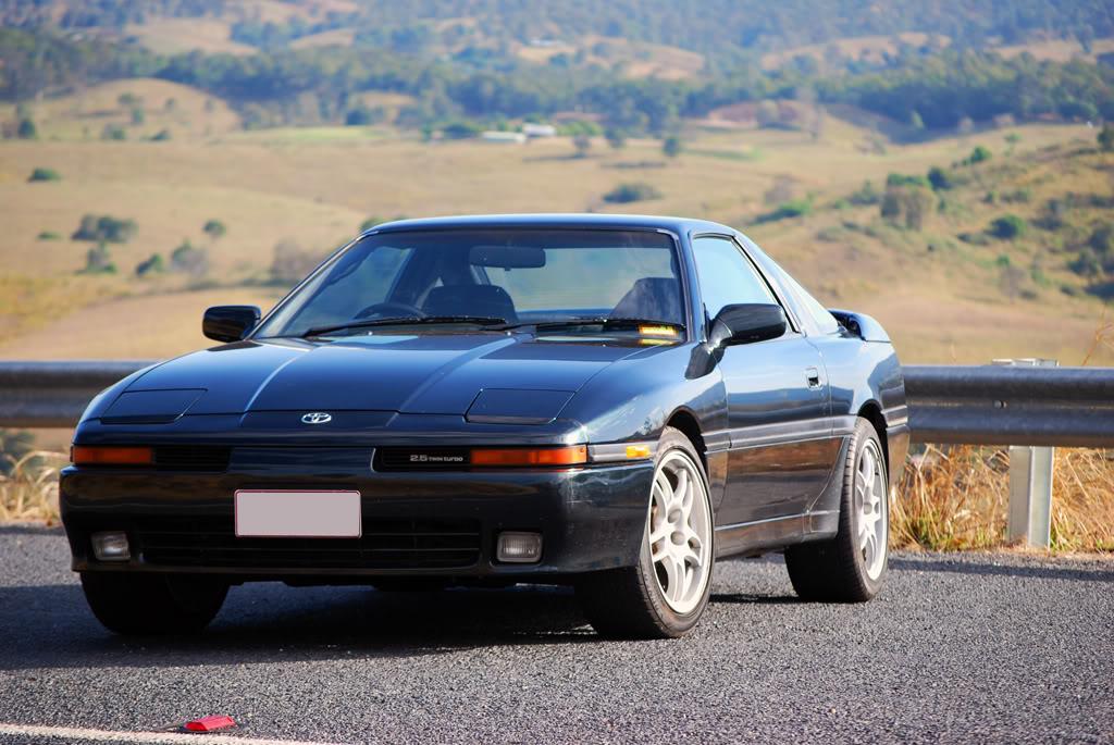

Some pics, second was taken by Rohan/elegant on the forums. Thanks buddy.:D

hey mate. Love both your cars. The KE sounds wicked as. It was the first car I had to check out when I got to the loop last week LOL
