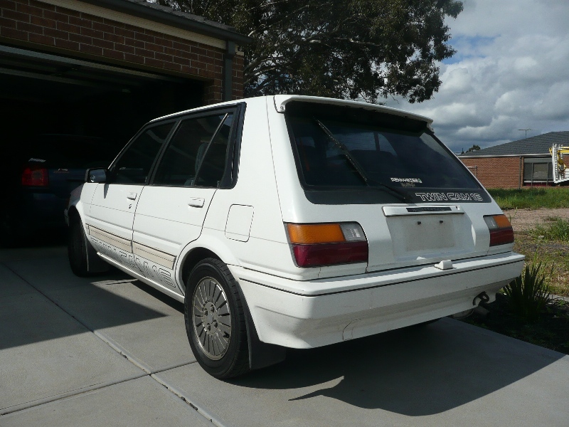

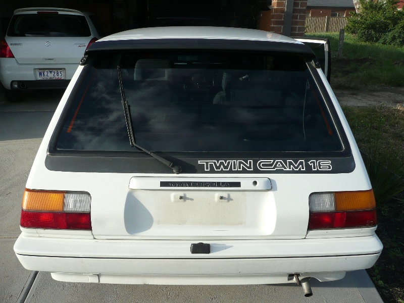

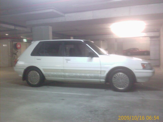

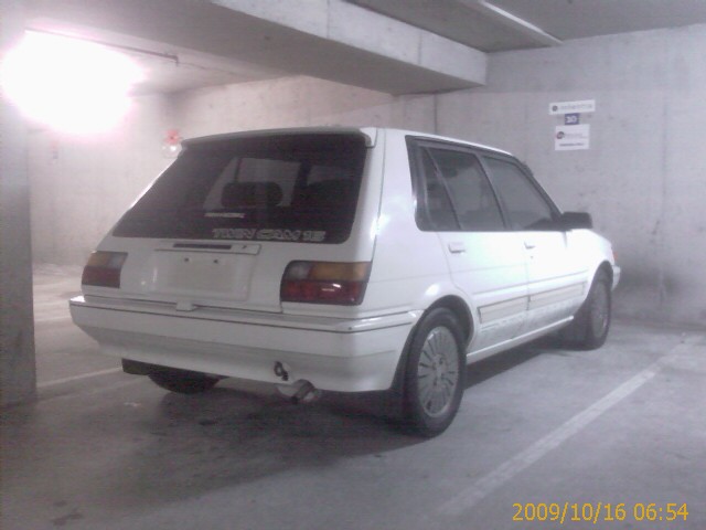

a few happy snaps for you this morning at work, getting road worthy this arvo in south melbourne.
Current Pic (12th Dec 2010)
When Purchased

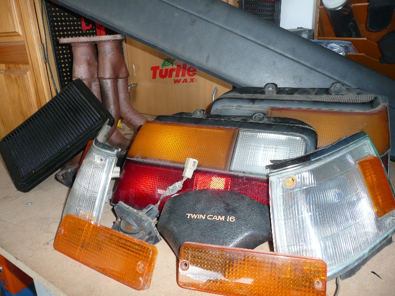

Hi all

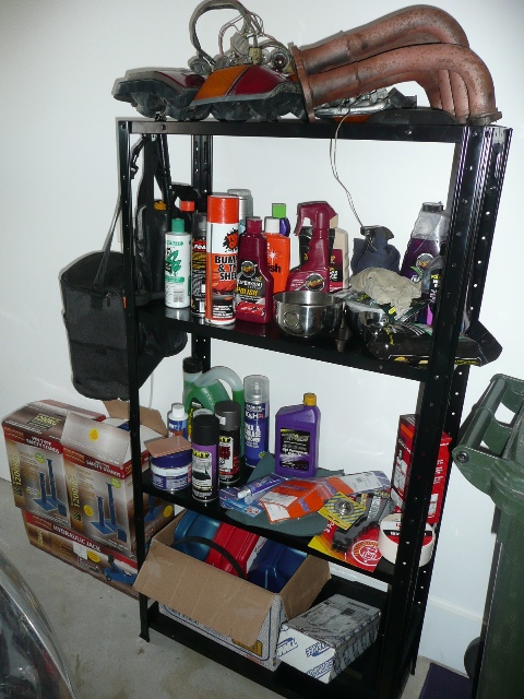

extremely busy today. Went to pick pay n go wreckers and ripped every thing i wanted off the ae82 twin cam which they have in the locked away yard out the back guy was great and gave me key to it where i had to lock myself in the yard and not let anyone else in lol, only thing i wanted but could not get was the black door handles, could not open doors enough as car wedged in so was too tricky etc.
What i got
  • Rear Tail lights including loom and globes
  • Front indicator / parkers incl loom and globes
  • front bumper indicator lenses
  • rear bumper number plate light
  • rear spoiler - BLACK :)
  • Steering wheel centre
  • Set of Genie Extractors
  • K&N Panel Filter
Such a bonus scoring the extractors and K&N filter....very Happy
Grand Total = $126 - Pick Pay n Go FTW!!! :yahoo:
After that i figured i better get a thermostat / gasket and o ring and also gaskets for extractors
Went to Autobarn and came home with all this.......easier to show pic than list everything - including the shelf :)
Grand Total = $311

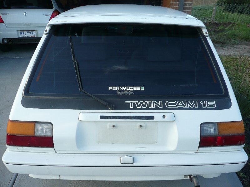

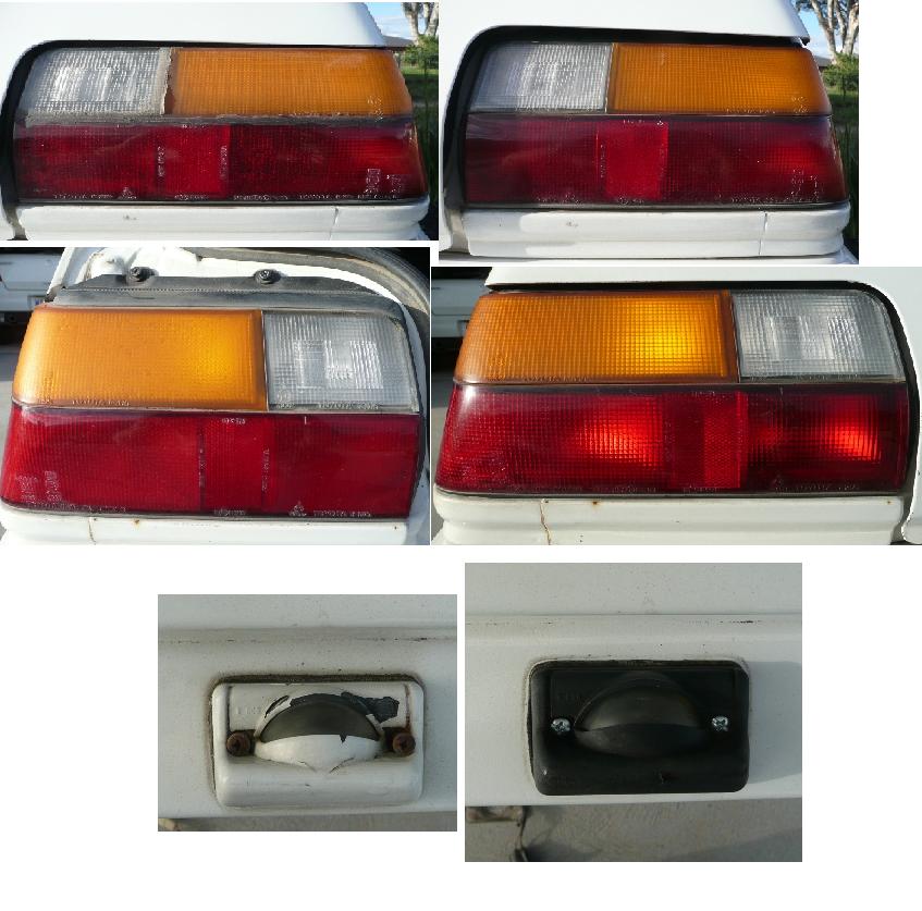

First of all i did the rear end so replaced the rear spoiler, number plate light, removed all stickers off window and added the rear tail lights, looks mint now.
old tail lights one was cracked and siliconed and other had water in it.
Rear before anything done
Rear Complete

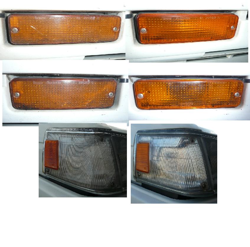

Then i did the front indicators / parkers and also the bottom lenses, bottom lenses both had cracks and left parker had cracks so needed new ones for roadworthy

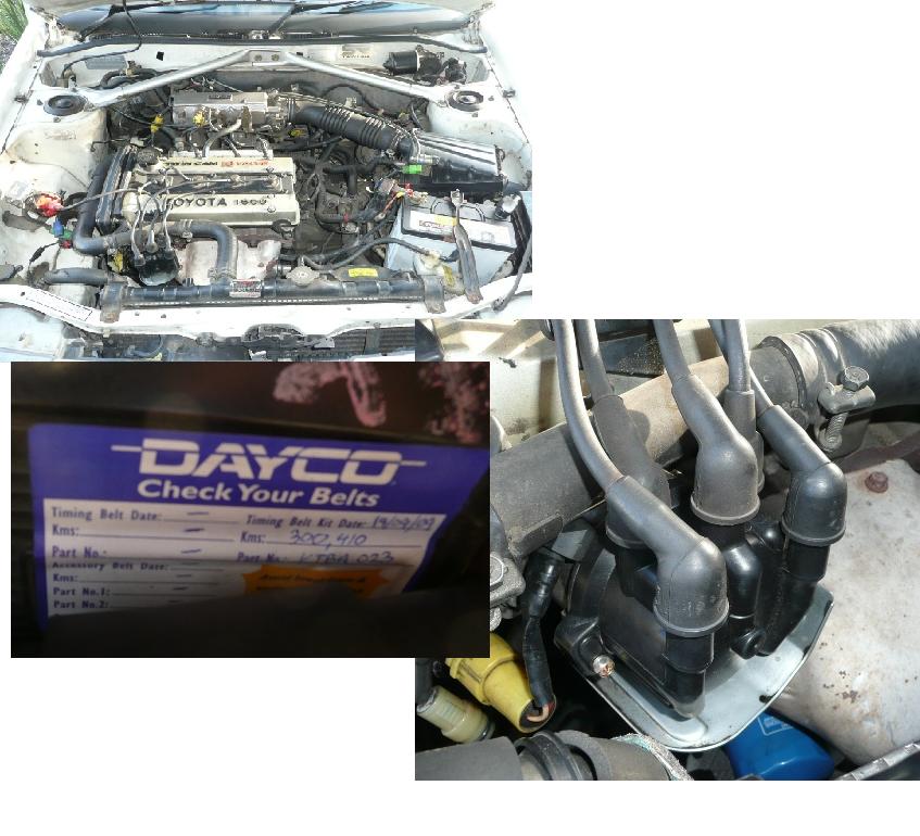

Engine as it is, Reco Dizzy and Timing belt just changed :)

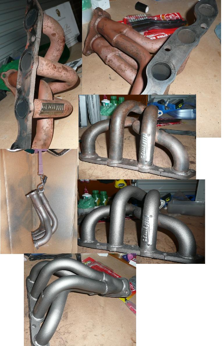

Then i rubbed back the headers with steel brushes...tedious and hard lol....wish i had bought a bit for my drill today but forgot so did it old fashioned elbow grease way. Three coats the VHT paint in OEM mild steel look, then i ripped out both seats and swapped over the bases as the passenger base is alot firmer and more bolstered, this way still get all the rear lumbar of drivers seat and now a nice solid base.

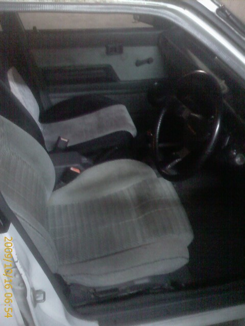

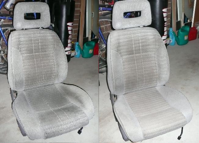

Drivers seat stock Left, Drivers seat with passenger base right
here is afew more pics....rim, shelf together all loaded :)
K&N Panel filter is all clean and drying overnight awaiting install tomorrow and will also install the headers tomoz and also the thermostat.
Have to break in the header paint by idling 10, then off, then 20, then off, then drive for 30 min.
