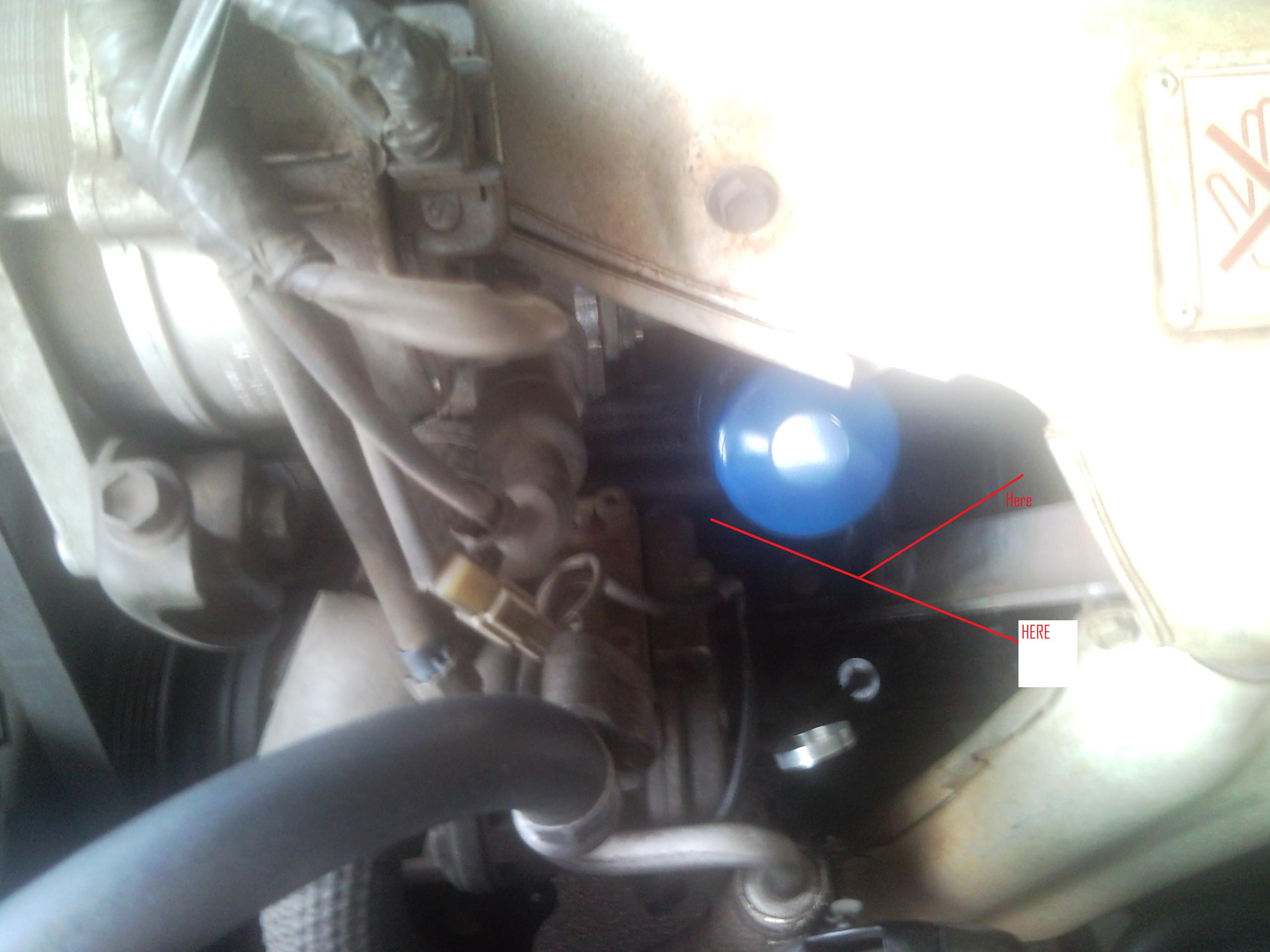

I'm guessing it leaks onto a place near the oil filter and dipstick. it would probably be more to the left of the headers of the car. when it leaks it drips off that place than onto the ground. and before what used to happen was when its hot it sometimes drips onto that place and creates white smoke when it touches the metal and sometimes i can see the white smoke rise from near the front headlights to the middle of the bonnet and up into the air. and sometimes the smoke use to go into the driver's compartment area through the airconditioning vent. i'll try to upload photos soon when i can find my usb cord. its probably located on the left side upper of the oil filter and inbetween the the space inbetween the oil filter and dip stick . depending on which way the oil drips. hope this helps.
