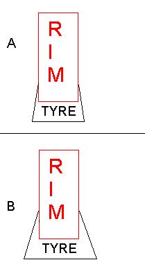

Hi Guys,
Was speaking to one of my well trusted mates regarding this issue the other day and we got to discussing the sportivo's next set of tyres.
Anyway i indicated i was thinking of going up a size to 205. What i heard next was an answer that no salesman has ever told me when i have gone tyre shopping (always good to cross check with friends that are in the know).
Basically our rims r 6" wide approx 152.4 mm wide.
The stock tyres are 195mm wide
so that means 195 - 152.4 = 42.6mm of rubber is litterally hanging off the sides of the actual rim. So about 21.3 mm either side of the rim.
Now if you are to go to 205 this would mean 205 - 152.4 = 52.6 mm is now hanging over the side about 26.3mm either side of the rim . And this actually is not the best for handling on a 6" wide rim because now what you have done is rather than the tyre being on a slight angle to the wheel like this picture below show in picture A it is at a larger angle as shown in picture B and the effect of this is the rim will wobble on that extra tyre you have now put underneath it and in fact hinder your handling.
Dont shoot the messenger this is just some advise a friend i trust has told me. He indicated you would not want to go larger than 50mm of a difference between the tyre size and rim size.

6 inch wide rim may be at the lower range of whats recommended for a 205/50 tyre, but it's OK.
Most manufacturers have a recommended rim width range, say 6 inch to 7.5 inch.
If the manufacturer says it's OK it must be OK !

the 205 tyre won't put your speedo and odometer out by significant amounts. it's still within legal limits. wat roll02 says that the 205 tyre can accomodate up to a 6" width wheel is true.
wat xoom says is also true. if u're thinking that the 205 tyre will help handling simply because of the wider rubber then prepared for more sidewall flexing.
on the other hand, 205/50r16 has a whole lot more range for tyres. esp performance tyres, which have softer, grippier compounds, as well as much stronger sidewalls, which may overcome that extra flexing. to realise the true potential of a performance 205/50r16 tyre, u really need to mount it on a much wider wheel so that the rubber gets stretched a bit more so it flexes less for more precise handling.
personally, i don't see anything too wrong about a 205/50r16 on a stock 6" wheel. some oem wheel and tyre package come in that size.
