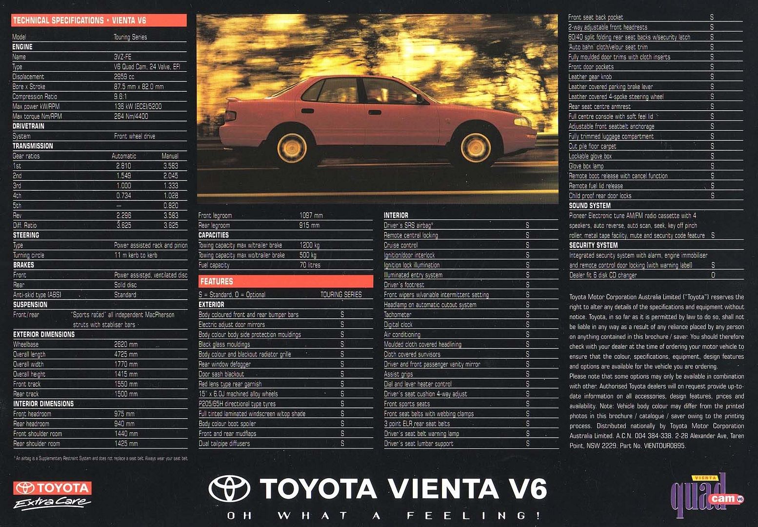

when I had my old Gen3 CSi, I was going around to wreckers and wherever else trying to upgrade parts on it from the CSX and Ultima etc :P
This thread reminded me, that back then I had some original Toyota sales brochures for the Gen3 Camry and Vientas, I scanned the spec sheets for both, I hope that helps you out :)

@ Terry - Thank you! That makes things really easy, how'd you go with it?
as you may have guessed I don't have the car anymore :lol:
but it was a 1994 CSi 4-cyl, I was able to get the digital clock in (wiring already there), got a glove box light (wiring there, only need the switch and the light itself), also put the cup holder in. I also went to the wreckers and got the 4-spoke steering wheel from a Vienta, didn't have airbags so that was a simple swap ;)
I also swapped the red boot garnish piece, don't know about the wiring though, but it has two extra parking lights in there.
The stuff that I found out that you can not swap easily, is map lights (no mounting point in the roof, also don't know about the wiring). Also the transmission indicator in the middle of the dashboard, the bit in the middle which lights up saying PRND2L (no wiring at all for that, even if you put in different gauges).

Just read the Factory Brochure, What does remote boot release with CANCEL FUNCTION mean?
Whoa. Size 7 was a little crazy :P
As you know, turning it up to 90 degrees clockwise will open the boot and the key can not be removed until the key is returned to it's original position.
Well, the cancel function means putting your key into the boot key slot and turning it 90 degrees anti-clockwise until the key clicks and locks in that position, and then you remove the key with it in that position.
Essentially what this does is disable the remote boot release feature which is the cable release next to the drivers seat.
