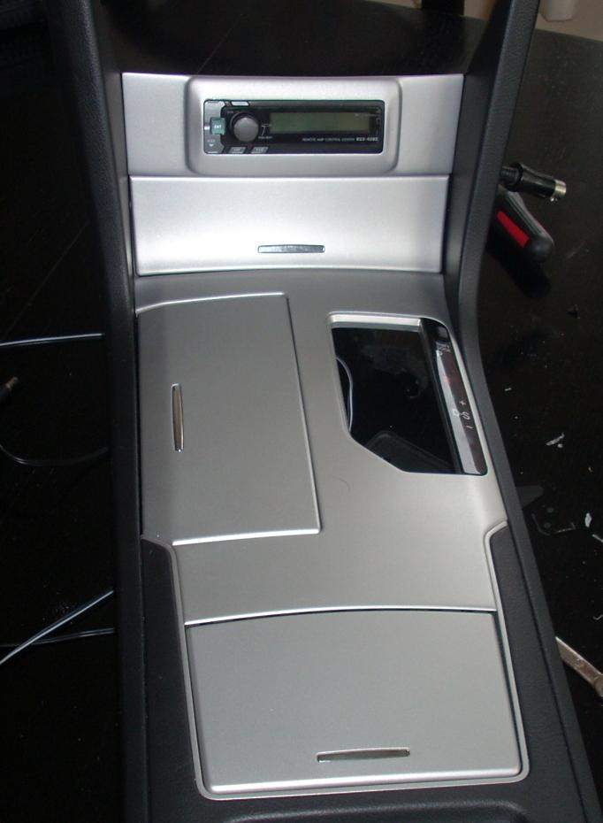

pics as promised. The color clash is more obvious in the photos than in person, and despite my best efforts I just couldn't lay down the paint flat enough to look completely stock. It's neat, but not perfect.
Also a bit of the stereo controller I'm working my way into the dash. Still needs some work though before I finally install it.

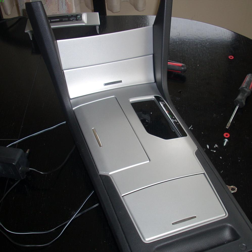

It wasn't taped up - it was fully disassembled into only the painted bits.
I did sand everything down first, but didn't prime as it was still onto a painted surface. However now I've had some time to see it in daylight, I'm still not happy with how the paint has come out. The gun is still spraying it too thick. I'll see if I can get away just flattening it with some superfine sandpaper, but chances are I'll be repainting it again this weekend

Like I mentioned above, I actually fully disassembled the dash and the storage compartments into individual pieces so I could spray them properly.

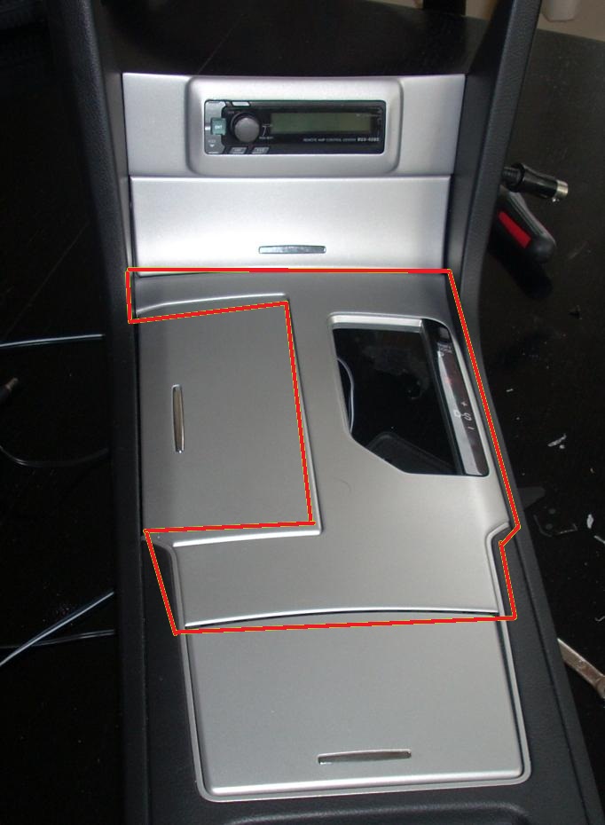

That flat panel I've circled in red... that is the bit I assumed you masked off. When its all fitted in the car it looks like that whole console section is one big piece (except for gear surround and storage compartments), with part coated in the silver. Or am I wrong, and the part I've circled is actually a seperate silver piece that can be removed?
Just remembered, the other bit I was thinking you must have masked was those little chrome bits on the compartment lids, or are they somehow removable?
Edited by Paradigm
yep, it can be removed as well. The gear selector bit does come semi-permanently attached to the piece from the factory - ie it requires some plastic "lugs" to be broken off to remove it, something I did when I changed the illumination color. I've since used a combination of screws and silicon to hold it together now.
It's coming apart again this weekend, and I'll be trying one last time to get it to spray properly. I think the nozzle on my gun is simply too large too spray it fine enough, but time will tell. If it doesn't work this time, I'll give the paint to a local shop and get them to apply it, shouldn't cost much just to have them apply the paint I provided.
