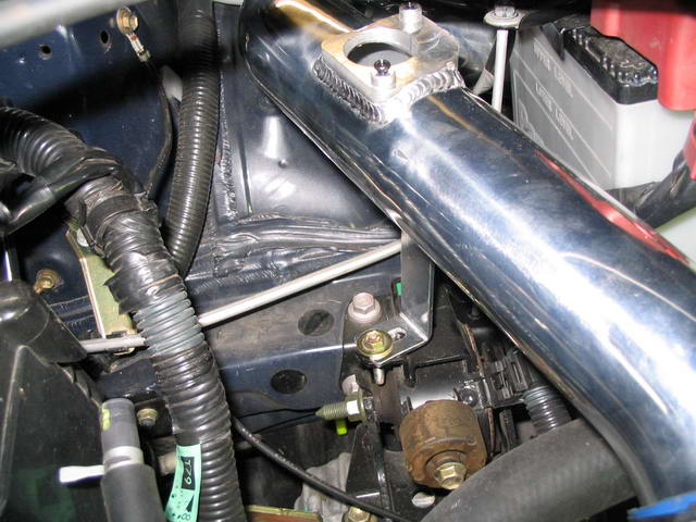

Second piece bracket doesn't line up. although easy found a place for a new screw position.

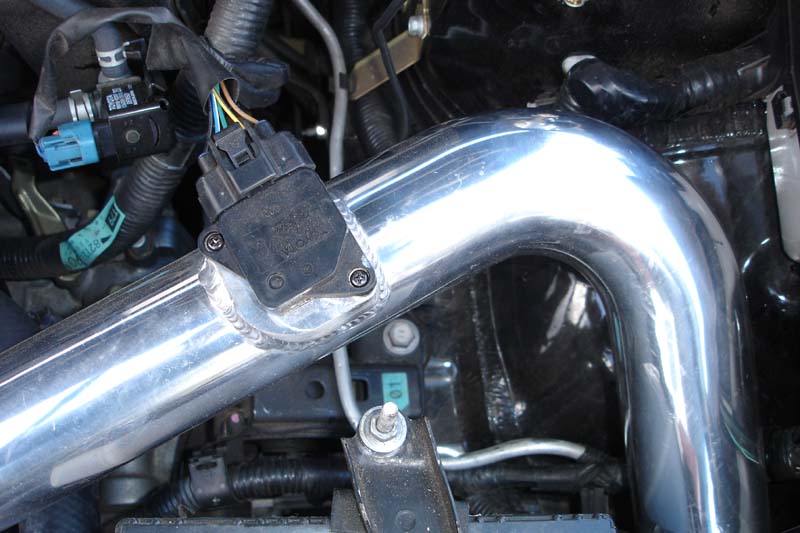

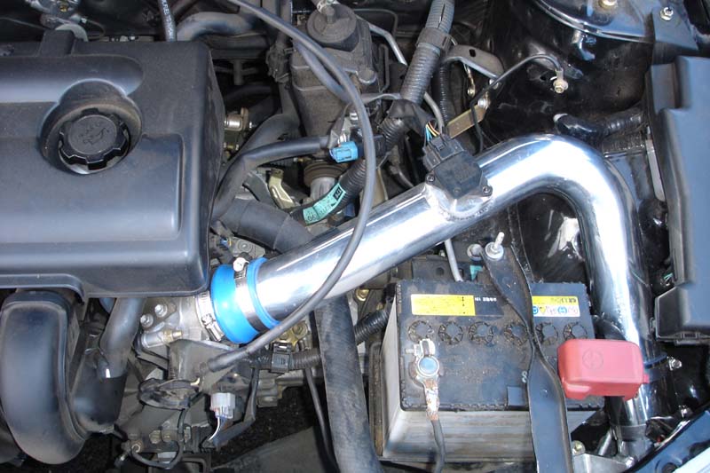

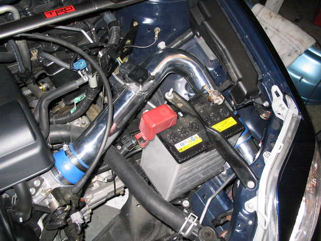

The simota CAI is a 2-piece. Seems a lot of people are asking this. I'll try to get some pictures. The long tube extends from the engine to approximately the fuse box (after making a ~90degree turn). The second much-shorter pipe connects the pod filter to the main pipe. The two pipes are connected by a rubber connector surrounded by an aluminium sleeve.
And it doesn't come with instructions, but installing a pipe is pretty simple anyway.

Danz - i know 2-piece.. i didn't realise this. although i already had comments on the piece they say its nicely welded and very nice job. tube is 2 n 1/2 inch not a 3inch piece. mate some input here....
--Rudes-- thanks for verifying that mate. atleast its the right one to get fitted. on the box it states its for the rolla altis. i'm thinking that's the malaysian/asian countries model. let me know when you get some pics.

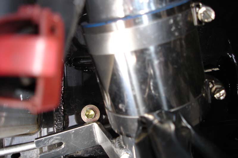

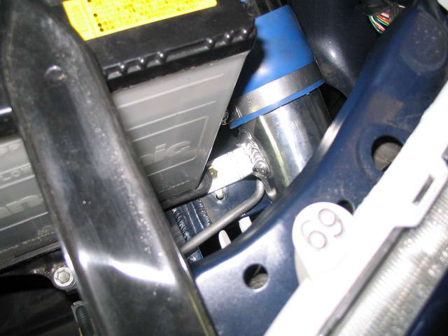

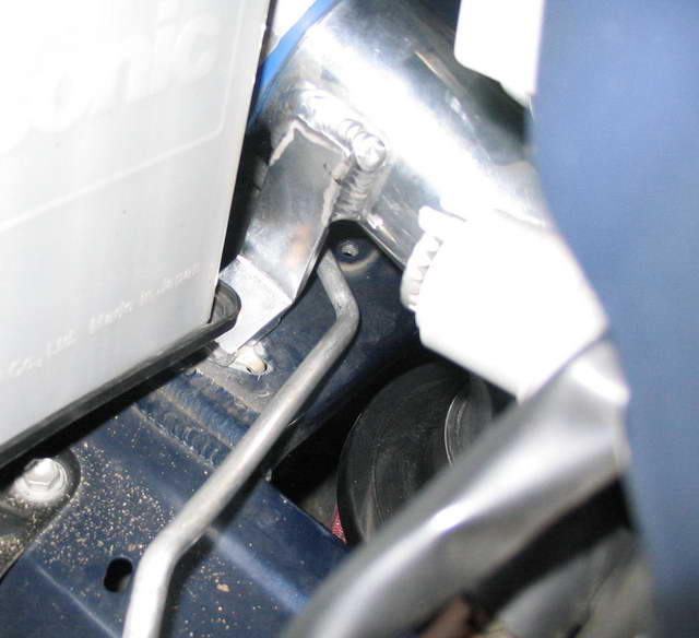

It comes with two brackets... one on the main pipe and one on the secondary pipe... in theory, I think the bracket on the main pipe is meant to screw down to one of the holes the airbox is mounted to, and the bracket on the secondary pipe screws down to a hole just before the opening where your pod fits through... in reality though, it's pretty hard getting the pipe positioned to allow this... I've only managed to get the main pipe bracket screwed in... but it still sits in place nicely...

You can see the bracket that's connected to the secondary pipe. The gold washer and screw is where that bracket is meant to attach to the chassis "theoretically".
Also, in the foreground you can see the aluminium sleeve and blue rubber connector (underneath the sleeve) that connects the main pipe to the secondary pipe. If you take the red positive terminal on the battery (blurry red thing on the left) as a reference, you can see how long the main pipe is compared to the secondary pipe (look at the first pic).

I kept the Simota Pod. Secondary pipe bracket is not screwed in, but is resting on the chassis, so it's still acting as a support. You might want to see what Autobarn do with this.

I got marks to fit with only a small mod to the bracket by the battery, very easy install.
