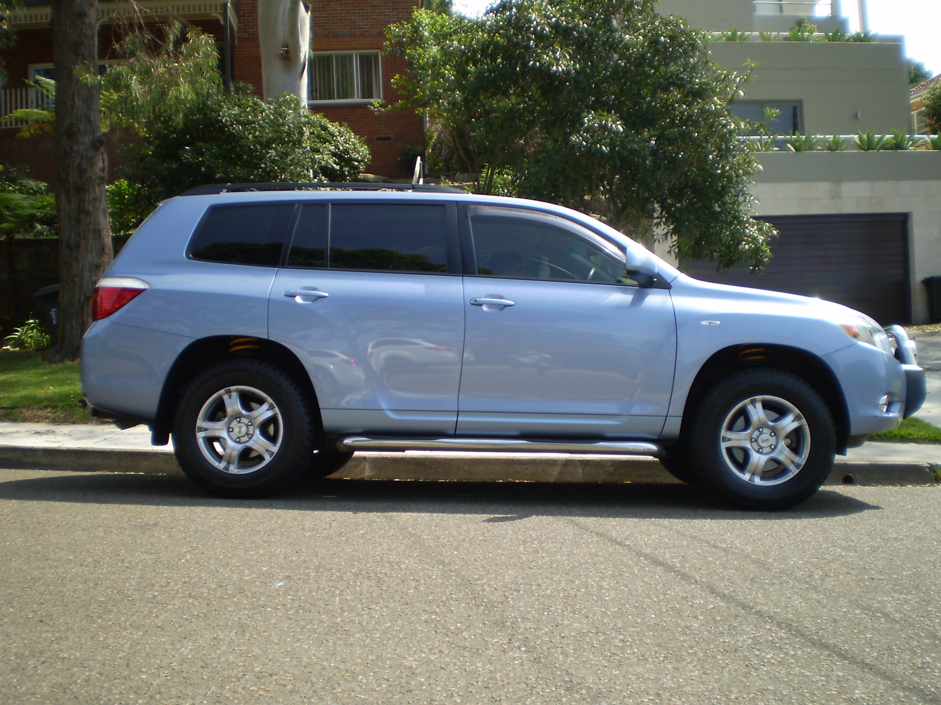

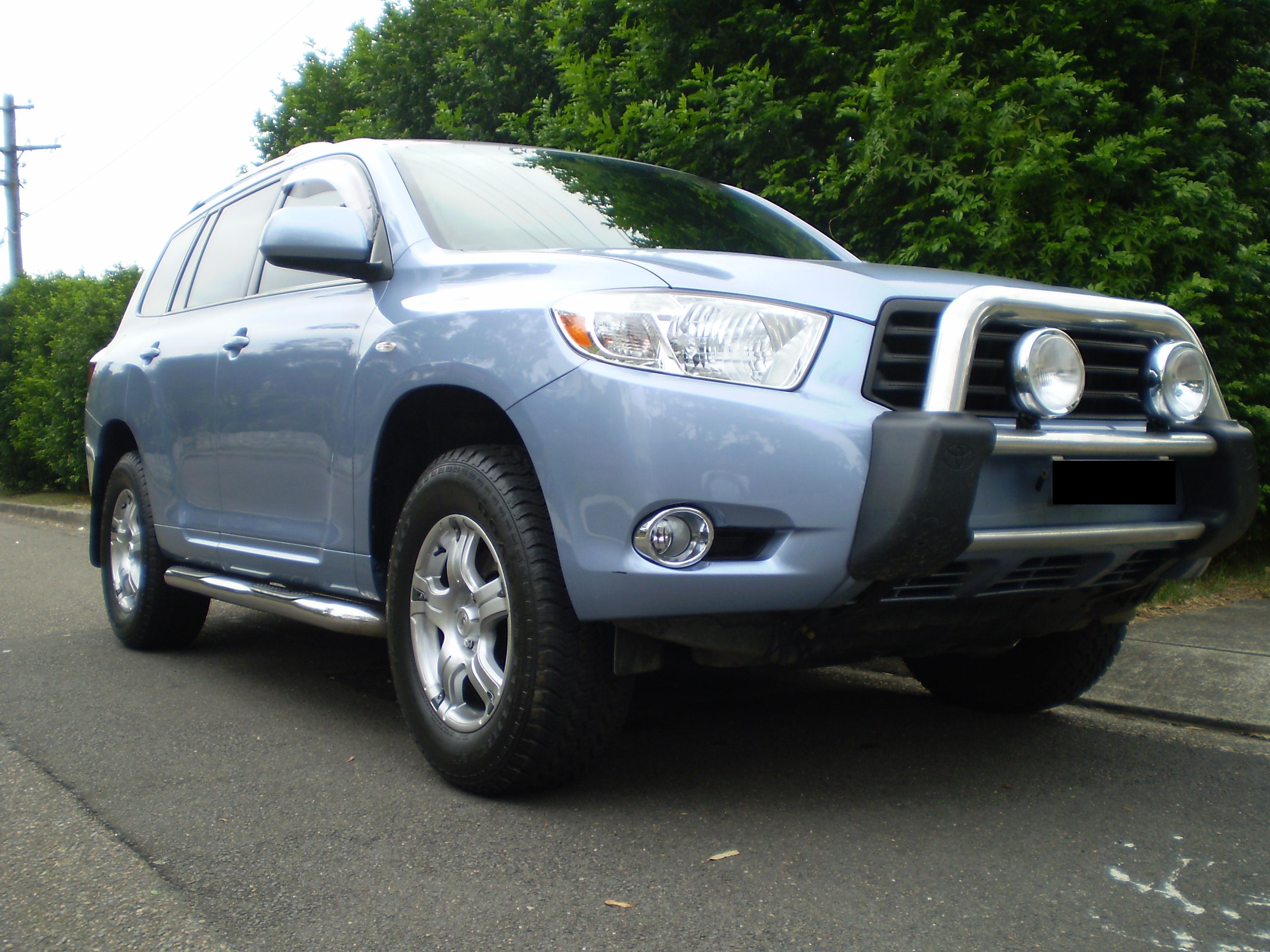

Finally some photos
The cost of the springs was $370.00 and fitting $220.00
Yes your probably correct about the height around the city, but on the farm when I want to
check on my girls and offspring (read cows and calves) I dont have to get out every ten minutes
and remove sticks from the so called underbody plastic guards.
regards merlint
