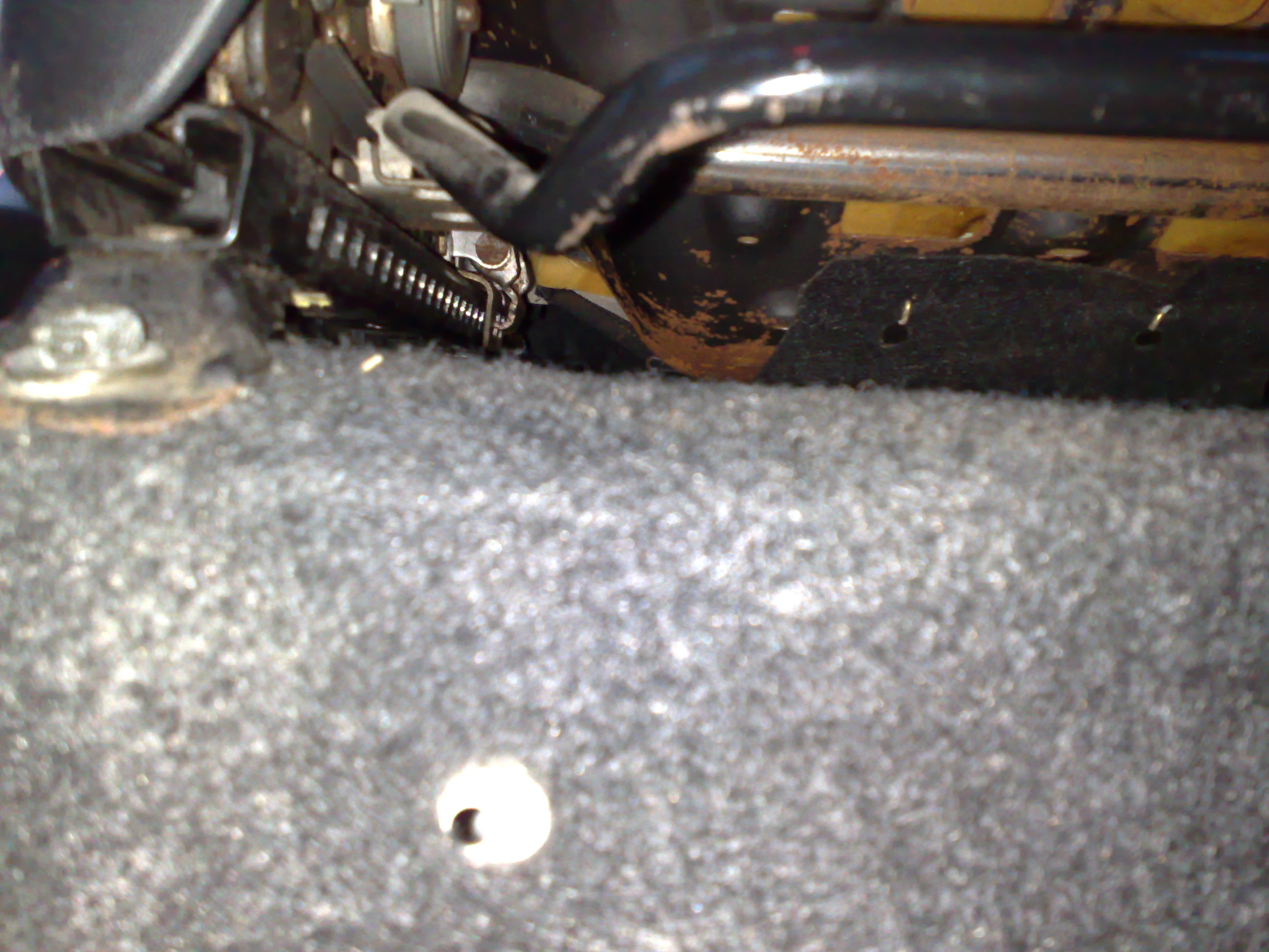

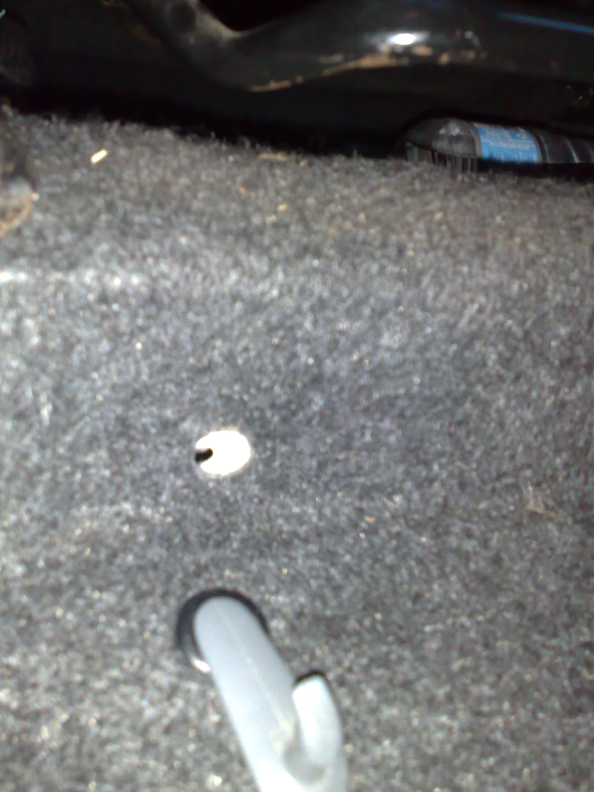

while checking for places where water couldve came in from i found a hole, didnt have time to really take a good look at it though.
Just wondering if this is normal to have that hole there (and if so, whats it for?)
- immediately under the edge of the seat on the side of the mound.. (refer to photos)
I would suggest a missing grommet in the floor pan somewhere, otherwise a leaking seal? Maybe round the door or the firewall.....

oh yeh the pics are too big but i reckon that hole is not the problem.
Why not just plug up the hole and drive your car when it's raining to see if that fixes your problem.
