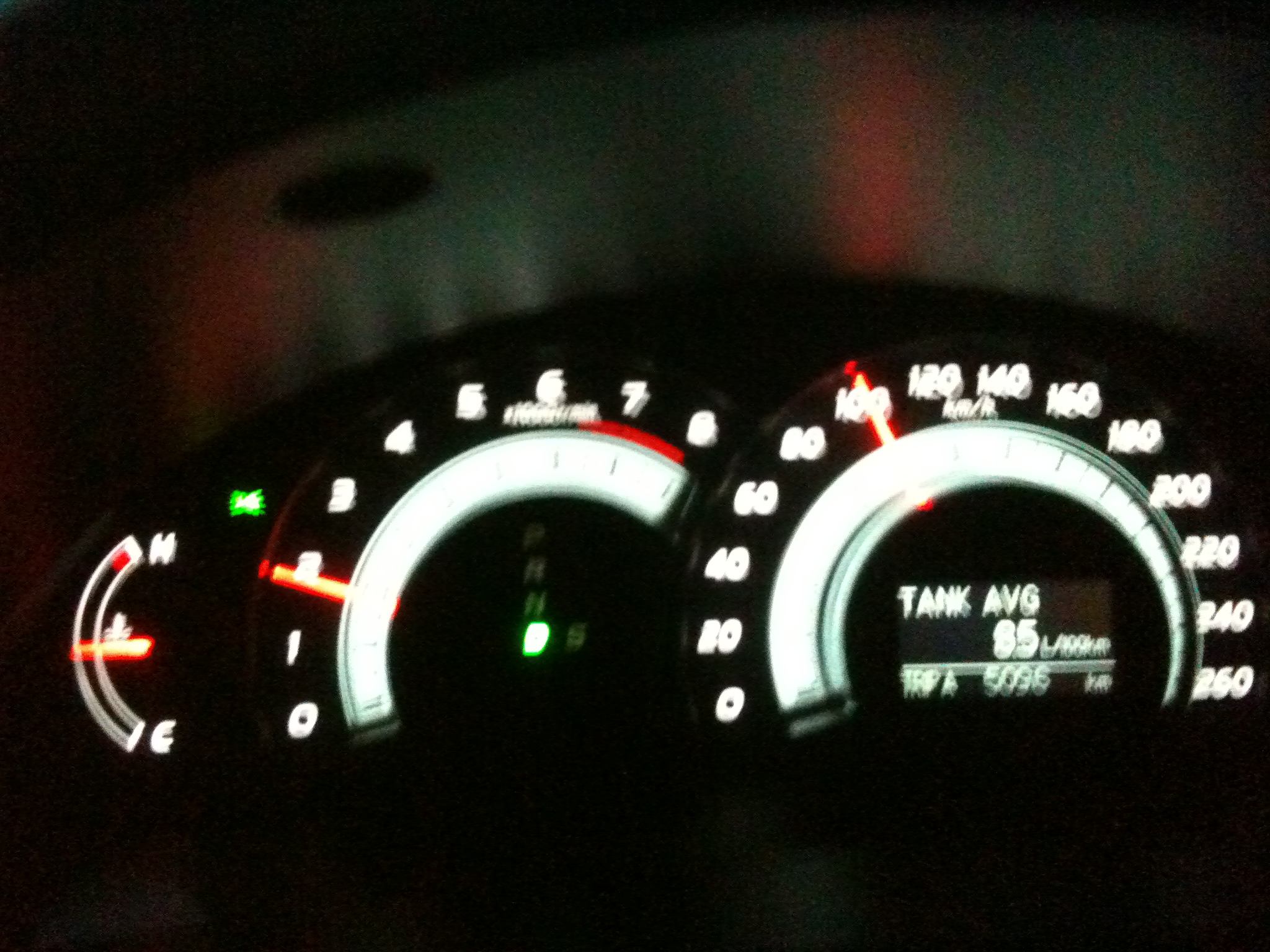

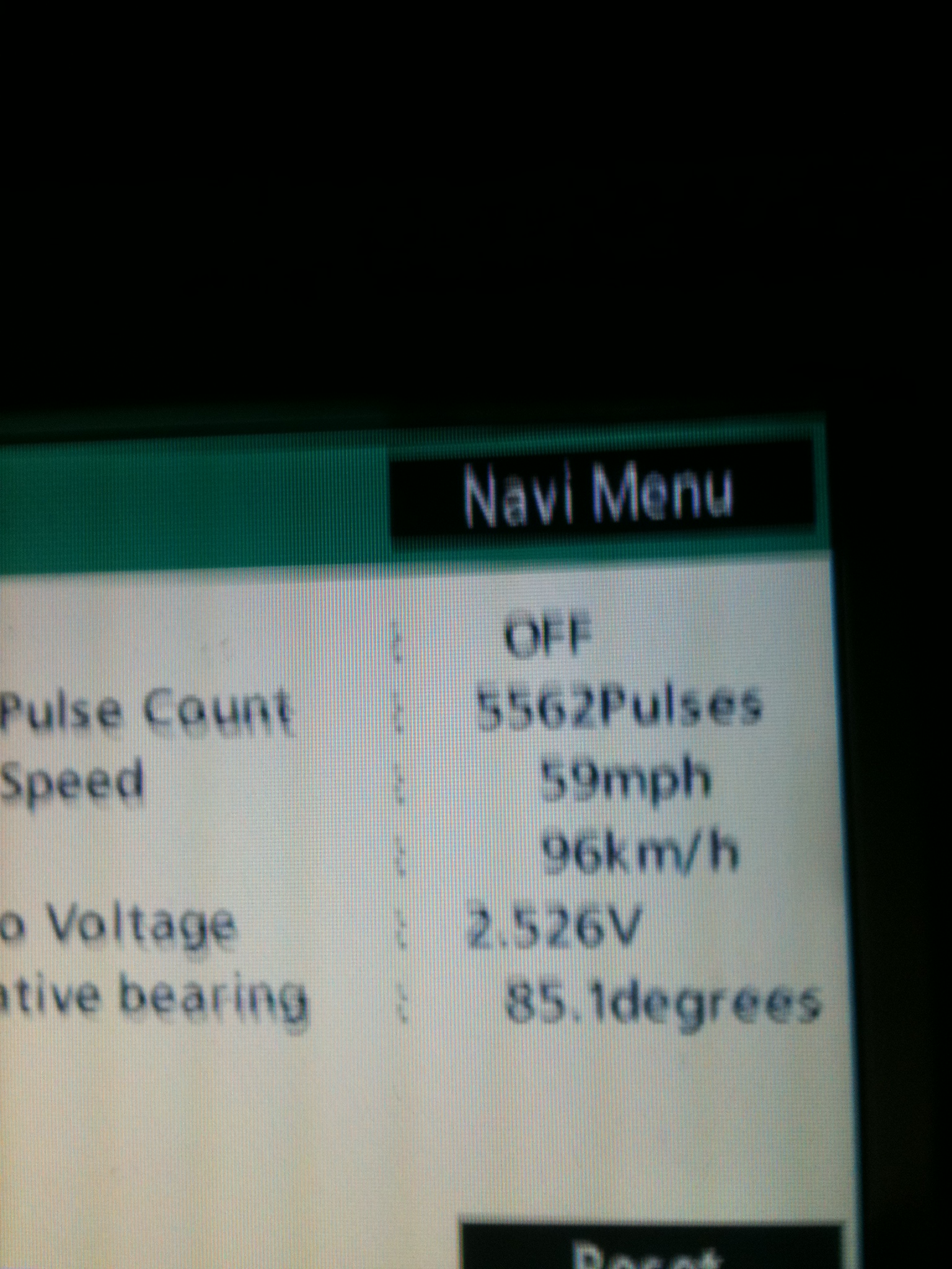

Here are a couple of pics showing the info from the sat nav and a slightly blurry speedo.
You will notice the sat nav says 59 mph or 96 kph where the speedo is smack on the 100 kph line.
I also checked this with a gps and also my iphone and the results were similar. 96 kph when the speedo said 100 kph.
It would appear that maybe the speedo is setup for 60 mph as our American friends would require (the market is a little bigger there than here). The kph numbers have just been placed in the required positions.
