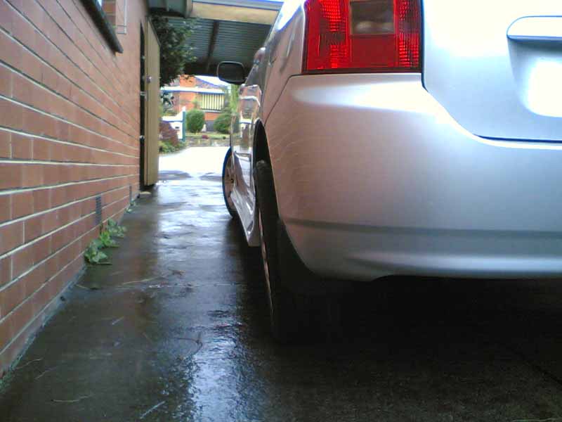

this is just a little something i did last nite... has anyelse done this and know how much itll cost to fix? where should i go to get it done? i tried bending the metal behind the rotor back but its too hard to bend... everythings closed till tuesday... :(

looks like you need to send it to a suspension specialist even if you take it to a mechanic they would probably take the car to pedders to get fixed on a jig which they can stretch it back out if it has not been pushed in too much. it would not cost too much to fix if it is just stretching it back out on a jig.
but if you have bent things beyong pulling them back straight then you would be up for replacement parts. maybe time to think about upgrading the suspension to aftermarket as the price you pay for factory parts may work out the same.
just watch out if you hear rattling sounds in the hub later on that would mean you smashed the bearings or something inside the hub and this would cost a lot to replace.

judging by the picture i'm not sure how much internal damage its caused but this has happened to a few friends of mine.. mostly subie's and its not a cheap job... cost at around $1000 depending if any damage has been done to axle etc etc... i wouldn't be driving around too much with it on. take a few pics with and without the wheel and borrow a car and ask a few places.

i was doing around 90 n i swerved and the car lost control n spun 180 degrees into a gutter... ill take more pics tomoro when we pull it apart theres not much to see u cant really see the bend in the bar.
were taking it all off and hammering the bar that hooks up to the 2 wheels... coz bob jane told me today that its bent so yeh... im just gonna get it drivable for now and get it fixed later coz i got exams on.

i would not be "bending" anything back into place, as you will prolly weaken it more. You should go and get it fixed or else you take the risk of somthing actually breaking and then you will be worse off....
the guy said take it to a panel beater or mechanic to get it straightened... im gettin it straitened today just so its drivable coz i got exams on monday need to get there... but ill go get itr chekced out on tuesday when everythings open.
If your Torsion Beam is bent I'd say it would need replacing, not to mention the member/swaybar within it.
If you get it bent back it's never going to be back to where it was and that means you wont be able to properly align your rear wheels.
I think so too 1ZZ-FE. Once a chassis is fark its pretty much fark. Unless the mech shop have the proper machine to straighten up the chassis, which is located in south melb, its called Spencer Panels. However, I reckon they will tell you to change it still.
