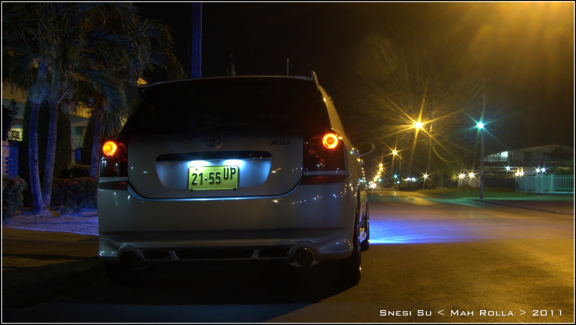

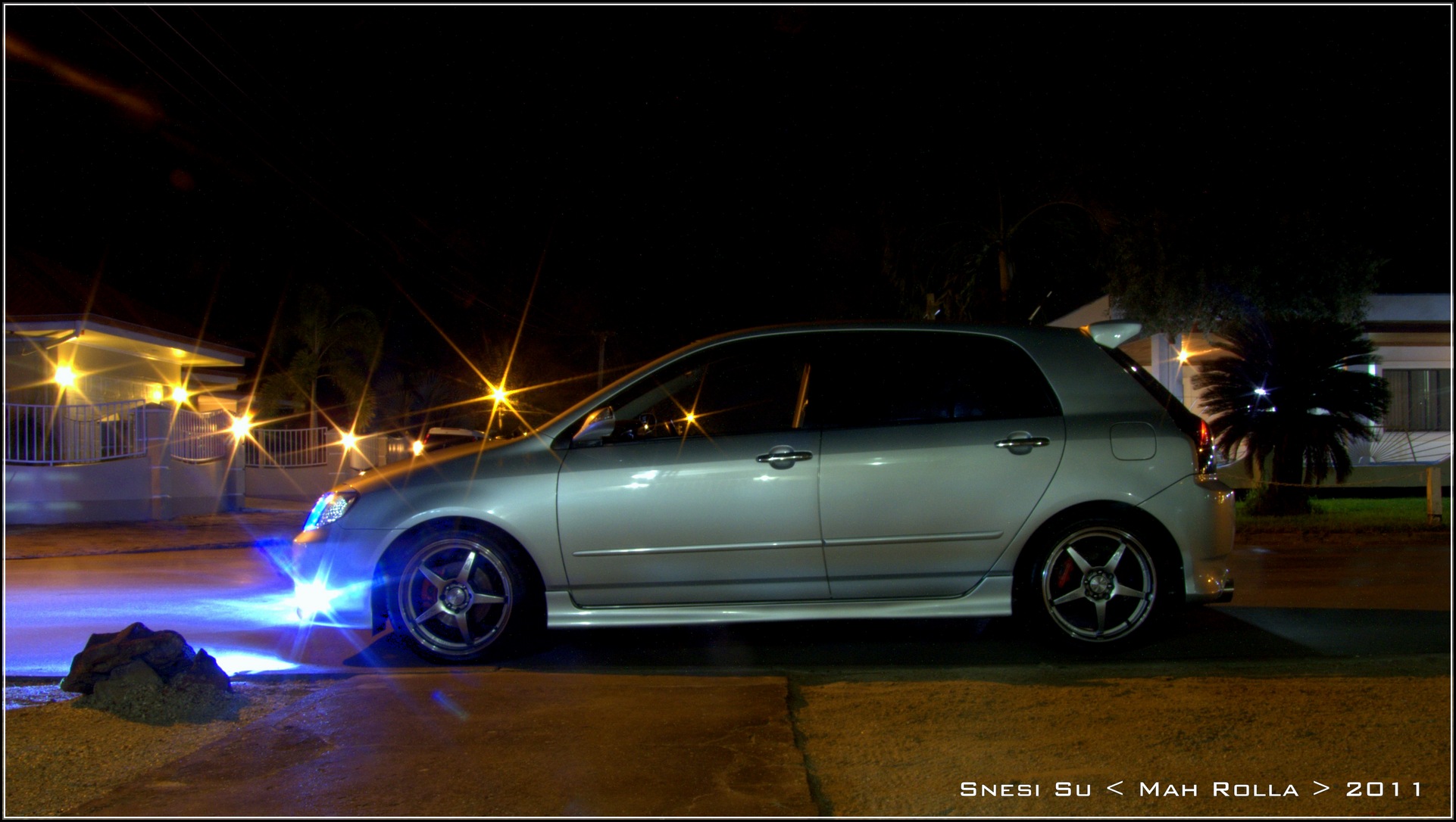

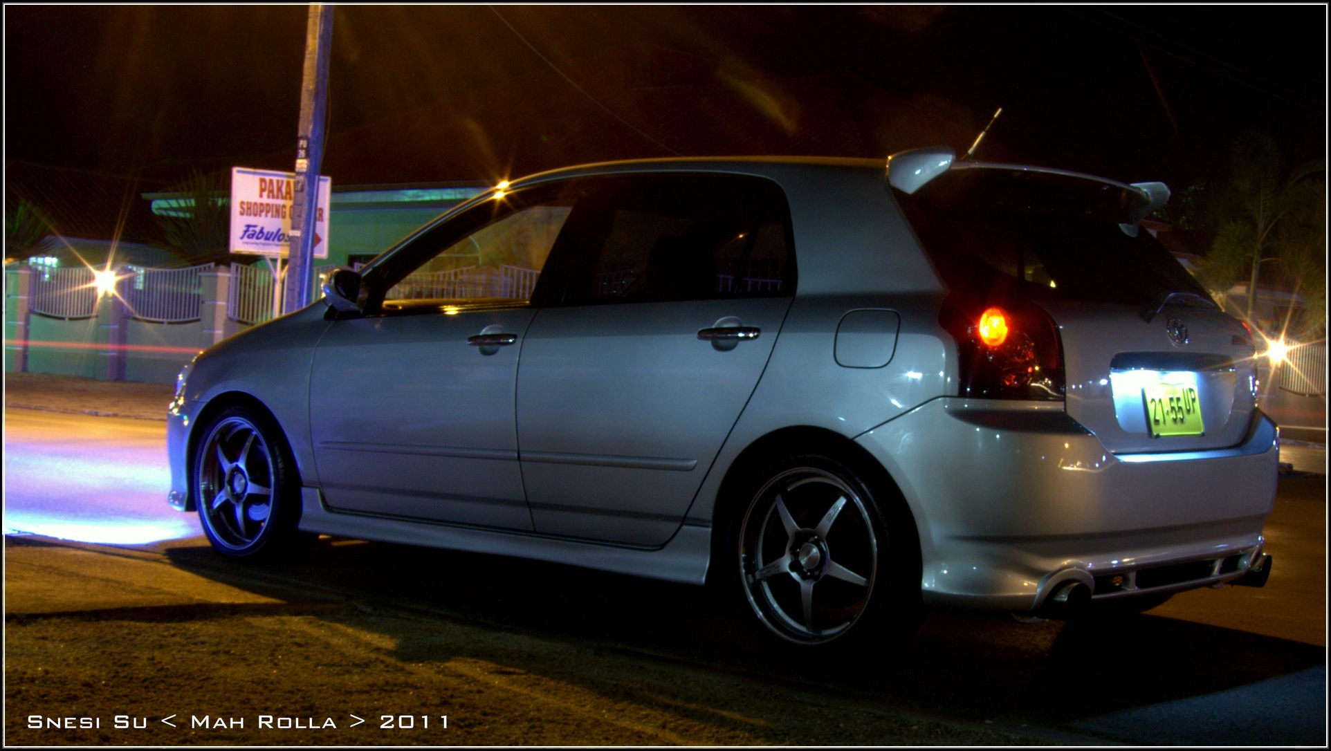

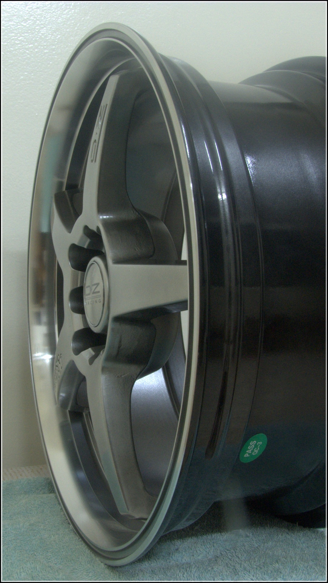

Hi guys,
just a update for my ride, new shoes.
I ended up getting the OZ crono HT in 17"
Actually i was looking for 18", but couldn't find any localy that suits my eyes like these 17".
So why bugger the 18" if i can have these sweet 17"
post-12850-0-52699000-1294702134_thumb.j
post-12850-0-55827900-1294702219_thumb.j
post-12850-0-99896200-1294702293_thumb.j
post-12850-0-53364300-1294702354_thumb.j

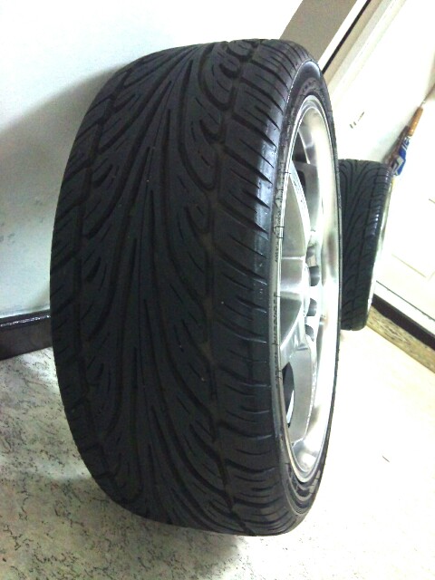

hey guys,
I ended up getting Sunny tires.
Locally i couldn't find any other tires of 215/40
I also am on a budget, so the Sunny will do the job for me..
a quick pic here:
post-12850-0-82767700-1295572493_thumb.j
post-12850-0-31718900-1295572588_thumb.j

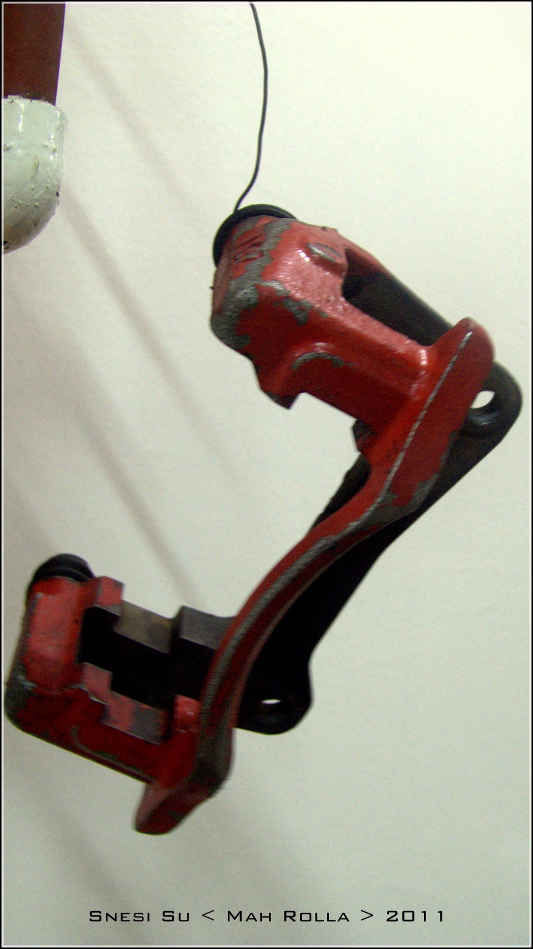

I also decided to paint the callipers again.
here's the result:
post-12850-0-25205700-1295572705_thumb.j
post-12850-0-69957800-1295572717_thumb.j
All pics were taken with phone, so not the best quality :P
