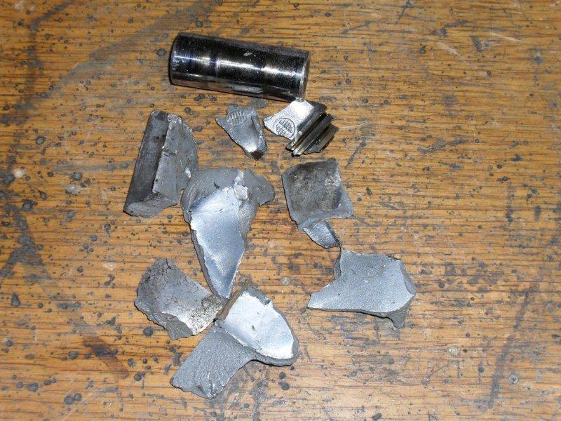

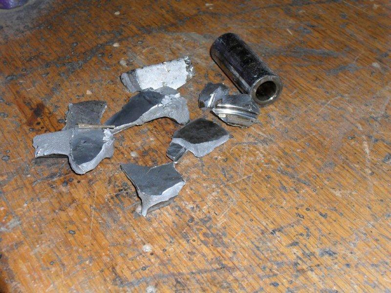

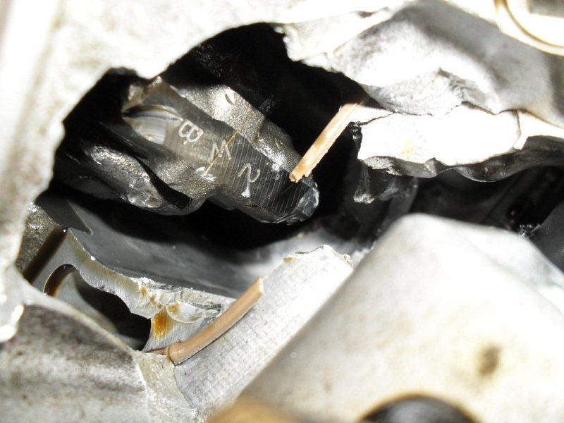

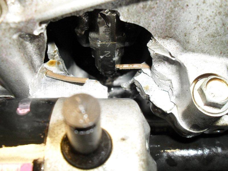

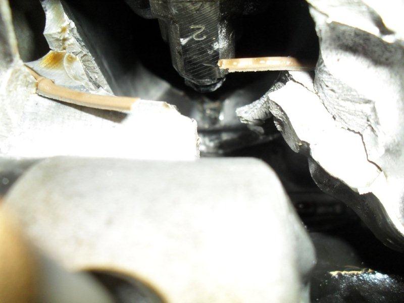

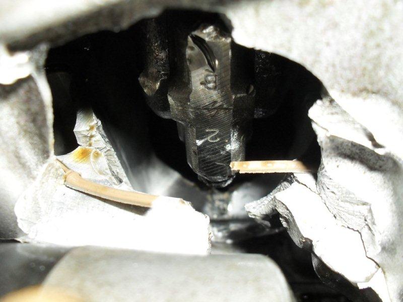

I blew my engine during some tyre slip in 2nd at 4000rpm.
pics are of my block and the hole i have on the side. The zre conrod is very thin. My suzuki GTI (engine for my mini) conrods are thicker than the ZRE have offered. Bit dissapointing for a Toyota.

Pics to me look like it has collapsed a piston as the rod is still intact. Rod damage porlly occurred after the piston has failed. My guess is the bore is going to be badly damaged and if the ZRE's ahve the same bore construction as the ZZE's then the block is a throw away.

pis not the best the conrod is only have an inch long still attached to the crank but all else is gone. I hope to strip down the engine on sunday so ill take some better pics with it on the engine stand
