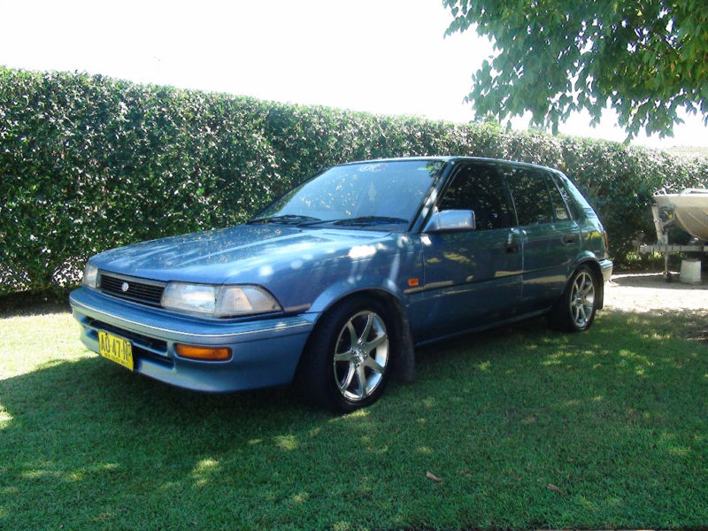

9
My immediate thoughts were, "good luck finding original Sportivo parts". It seems you've done well to find the hard to get bits, especially the front lip. I'm assuming it's original. You didn't mention anything yet. Nice little project. Car looks great mate !
