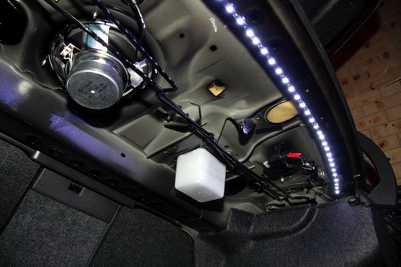

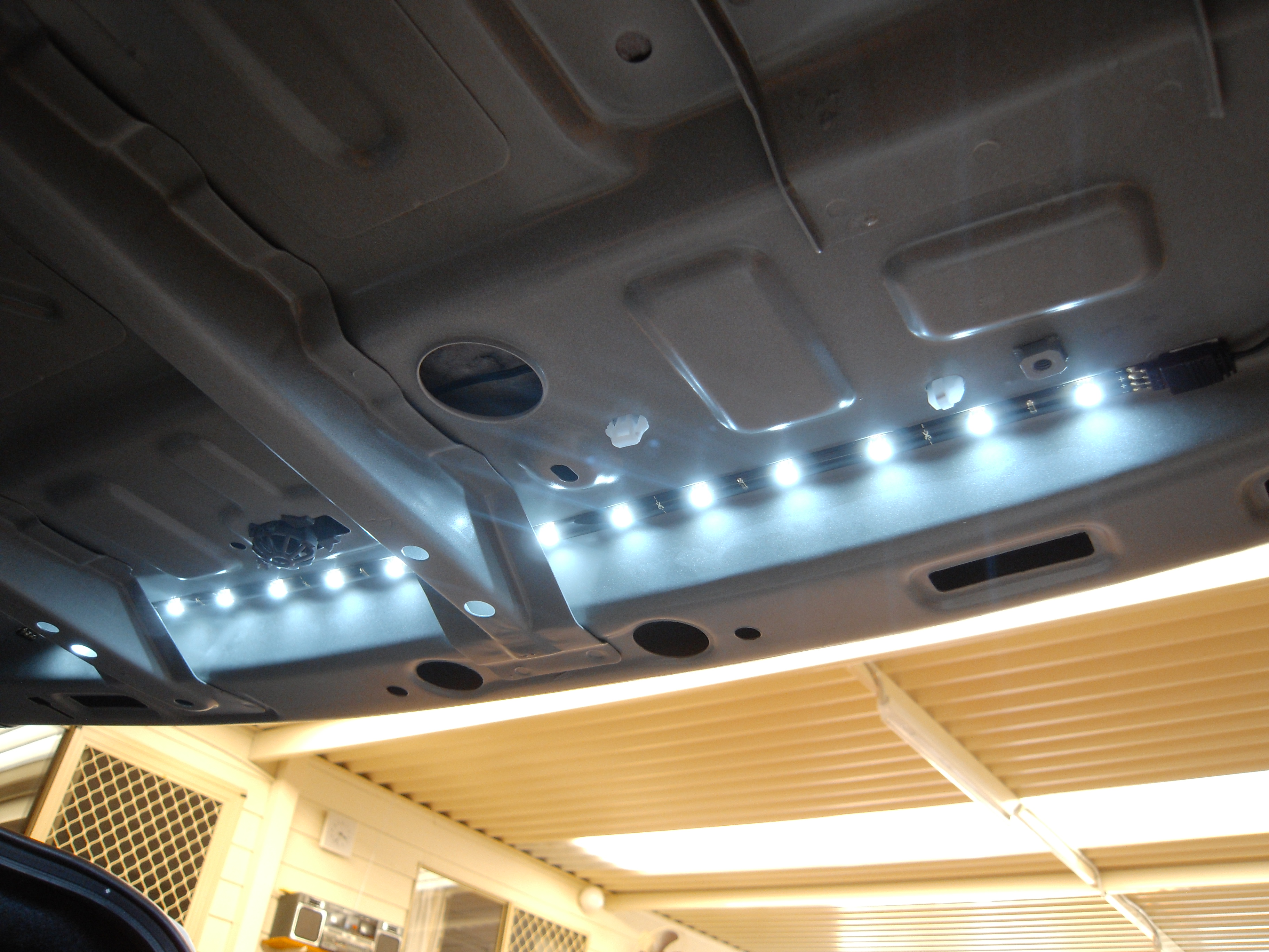

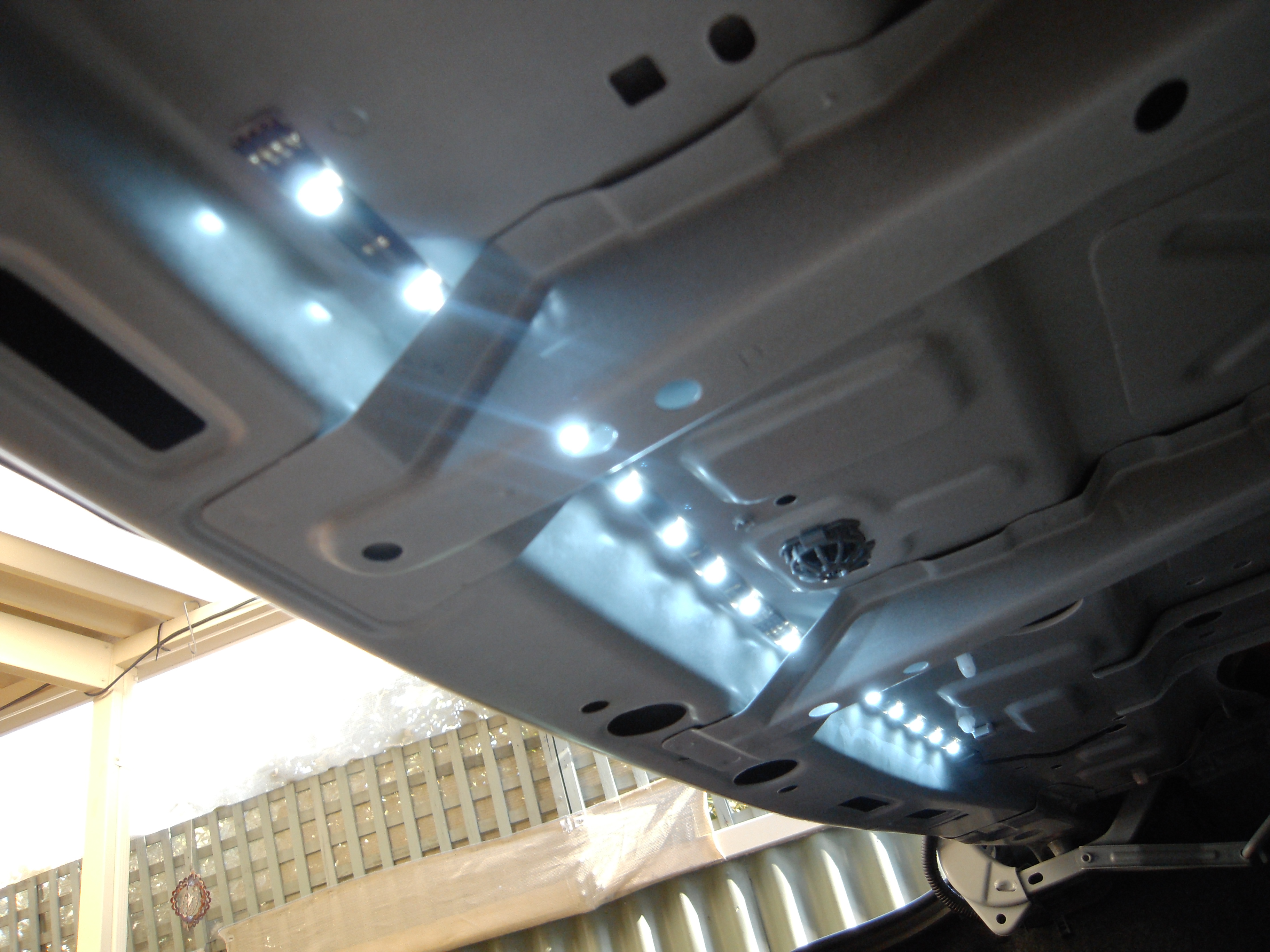

As said above better boot lighting can be done with LED Strips... here is a preview of mine :D
At a cost of $50.00 a packet (2 strips per packet) and you can join them together (up to 6 strips) they are pretty good!

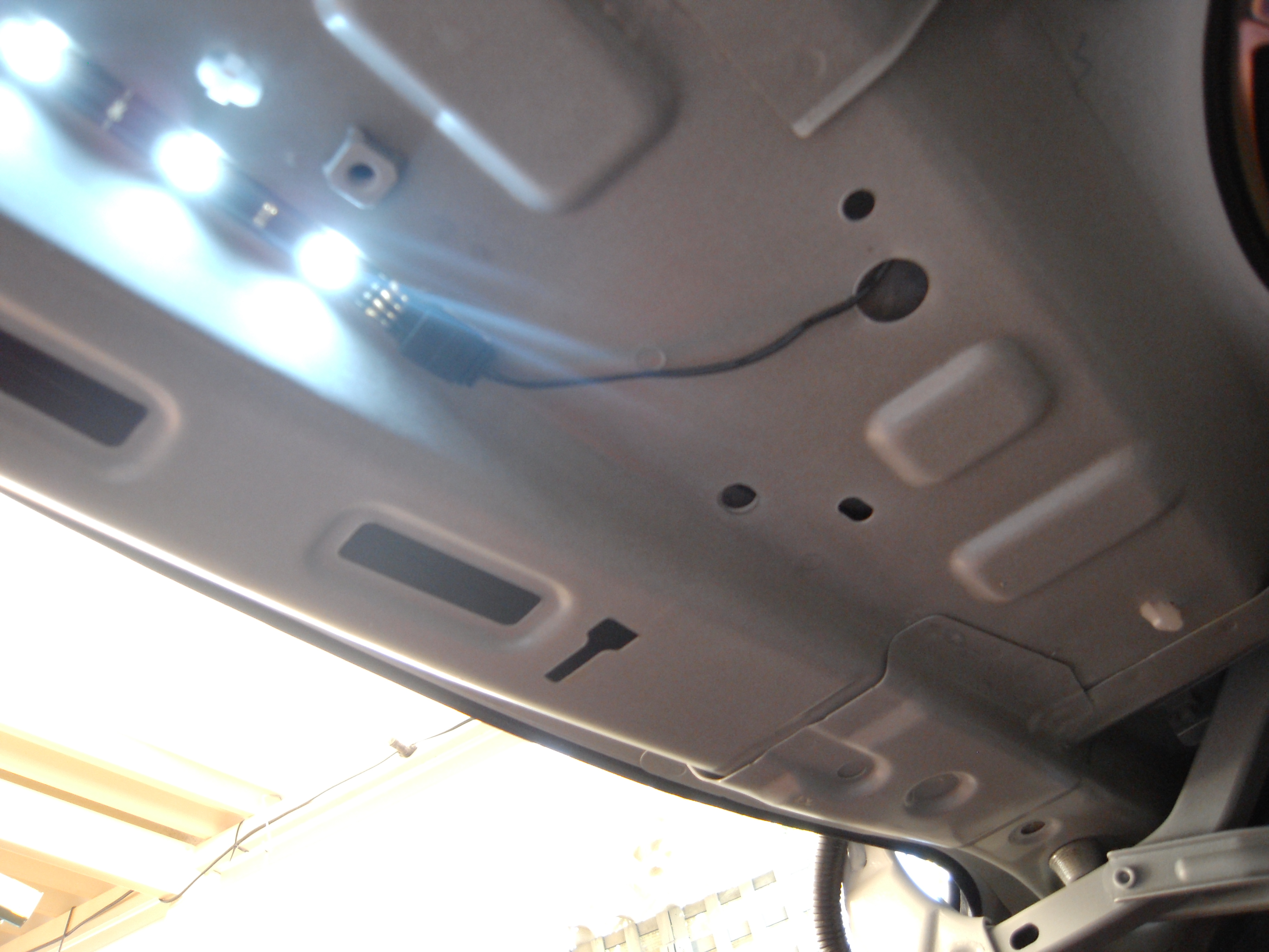

Here's a pic of my boot and interior with LED conversion.
