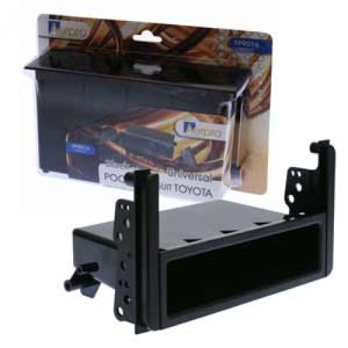

The head unit should bolt straight up into the bottom part of the Toyota brackets.
All you need is a single din POCKET to fill the empty space above. You don't necessarily need a fascia kit unless you want it flush in the middle.

and bought this pocket and mounting kit from Autobarn.

I got one from Supercheap Auto: Aerpro 'To suit Toyota; Smaller 2-plug type (Model # APP0141) $14.95
Perfect fit to the one that comes with the Eonon.
