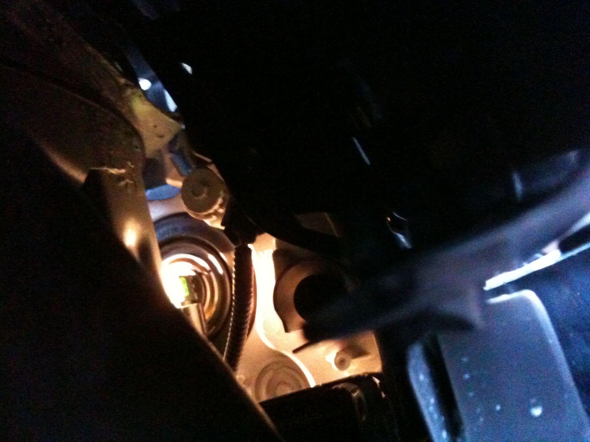

Hey guys, I've spent a good 5 hours trying to access the parker lights and I still can't get it. My hand now looks and feels like it was mauled by a tiger :unsure:

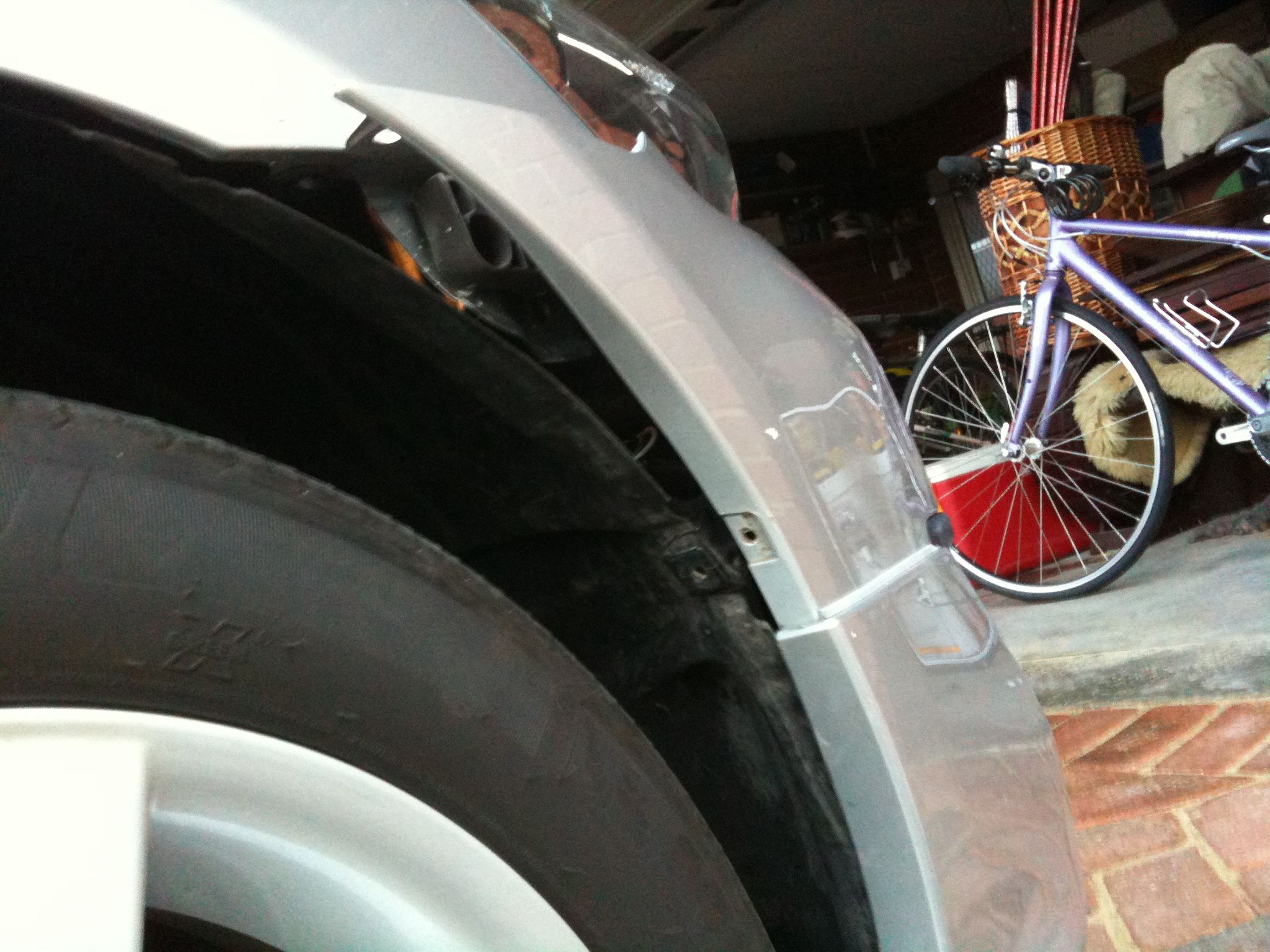

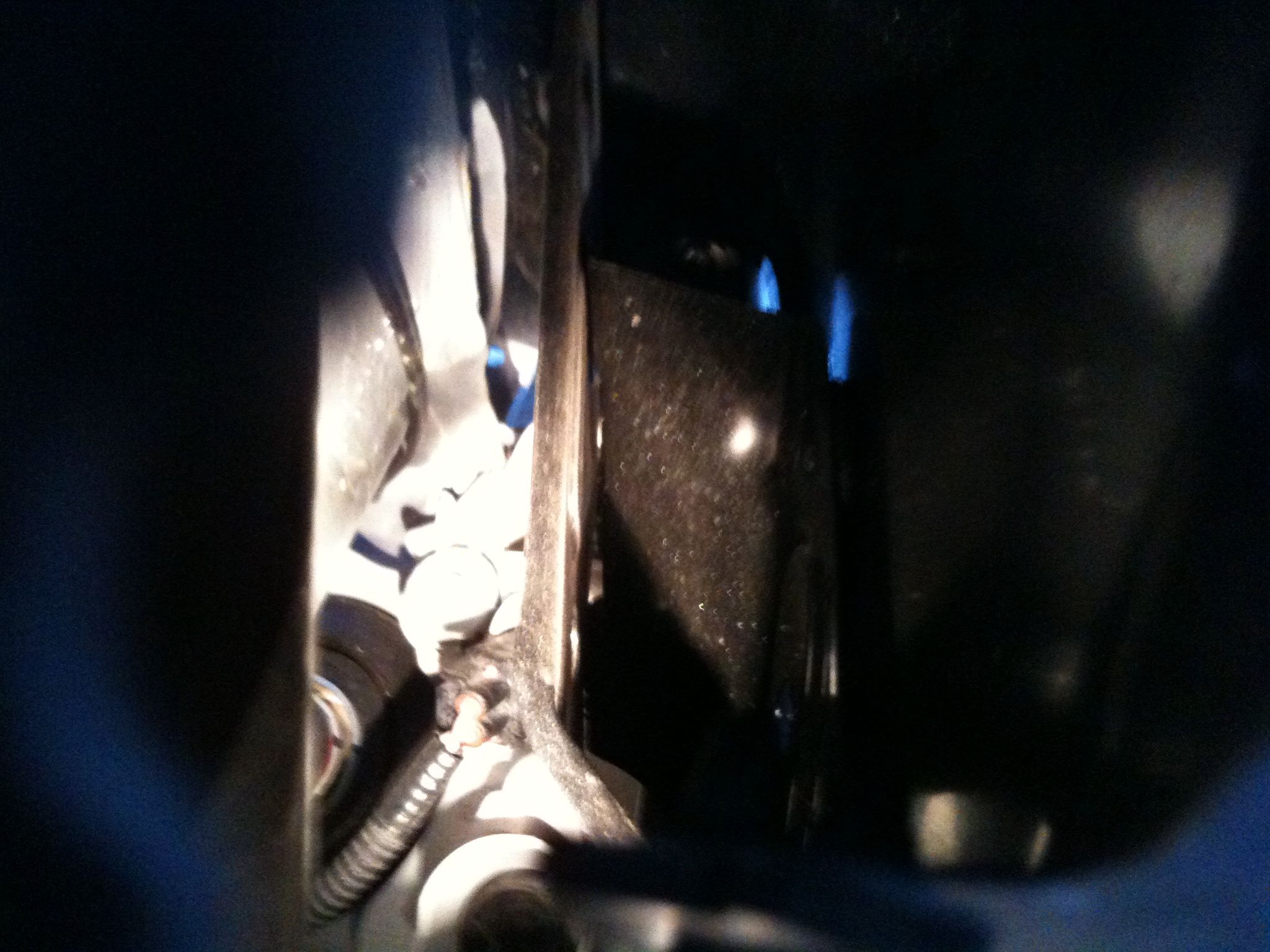

and it still doesn't help. Could anyone point out what I should be doing in the photos attached?
Otherwise, should I simply remove the bumper like Jin did here?
Thanks!

You are doing it right but if you want more space you can turn the wheel fully to the opposite side to give you more space.
I had help since my hands are too big so i got someone who had small hands.

Thanks alot dude, finally did it. These cuts are going to take a long time to heal....

You can do this without removing the bumper as I have done it twice with 245/19" Wheels on.
These are the instructions I would give to anyone attempting this:
-Firstly Point the wheel inwards. So if you are doing the left (while sitting in the car) point the wheels full lock the the right
-Remove the screw underneath the car that holds the under guard to the wheel arch guard (photo 2 taken facing the rear). When you look at the area, you can easily figure out the screw I'm talking about and how it all goes together
-Secondly, remove two of the clips holding the arch guard to the wheel arch. The lower one is a twist and turn, the upper one pops out in the centre followed by the remainder of the clip
-Let the guard sit on the wheel
-You can access the parkers; providing your hands and wrists aren't too large. Having a torch is quite helpful at this point in time so you can figure out where you are going to have to send your hand to
-The parkers are removed by twisting them
-If you continue to have problems then lift the car up with the jack to provide more room
