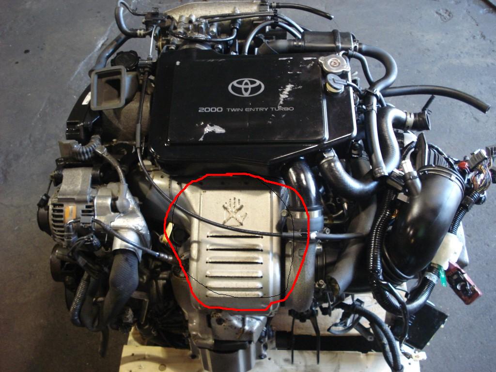

Hey buddy, sound is coming from red circle area of the pic (which is not my actual engine but where the hand imprint is loacted stating too hot dont touch) in front of the engine, assuming thats the transmission area, is that right?
post-25368-0-17595800-1313140029_thumb.j
Actually, I was wrong, now that its dark and quiet outside and it was getting louder, I figured out its not in the engine bay at all but right under the gear shift beneath the car, as it can only be heard in the car, even if you put your head under the car from the drivers side its not as loud so my best guess the sound is in the middle of the visible gear stick and the chassis so who knows what it is...the car has been driven for most of its life in 1st, 2nd and third city driving and my friend said it may have affected the gear shaft in someway..
