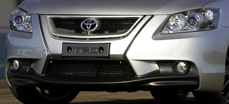

You could probably do something like that but lower (Refer to red dot.), or make some sort of bracket that is angled slightly downwards to the ground and mount the sensors to them (Yellow dot in attached photo.).

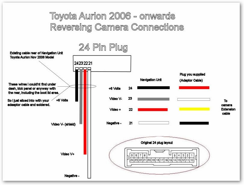

ok, in this diagram, I take it that the 6v + & - are output voltage to power the camera, I am testing a camera to put on the front bumber under the number plate to see if It can show all or mostly the important parts of the front spoiler for when parking etc, at the flick of a switch or push of a button I am going to wire the image from this front camera into the reversing camera input so I wont damage the spoiler, the camera I have is 12v so I take it if I am only running the image into the head unit then the voltage difference wont matter. Do the other wires activate the screen for when reversing, for warranty reasons I will have the last wiring bit done by an autoelectrican but if I turn on the front camera and the input wires receive the signal will the screen come on automatically or am I missing something, maybe to to with the reverse switch. or power to the other two wires? Can anyone help me on that
